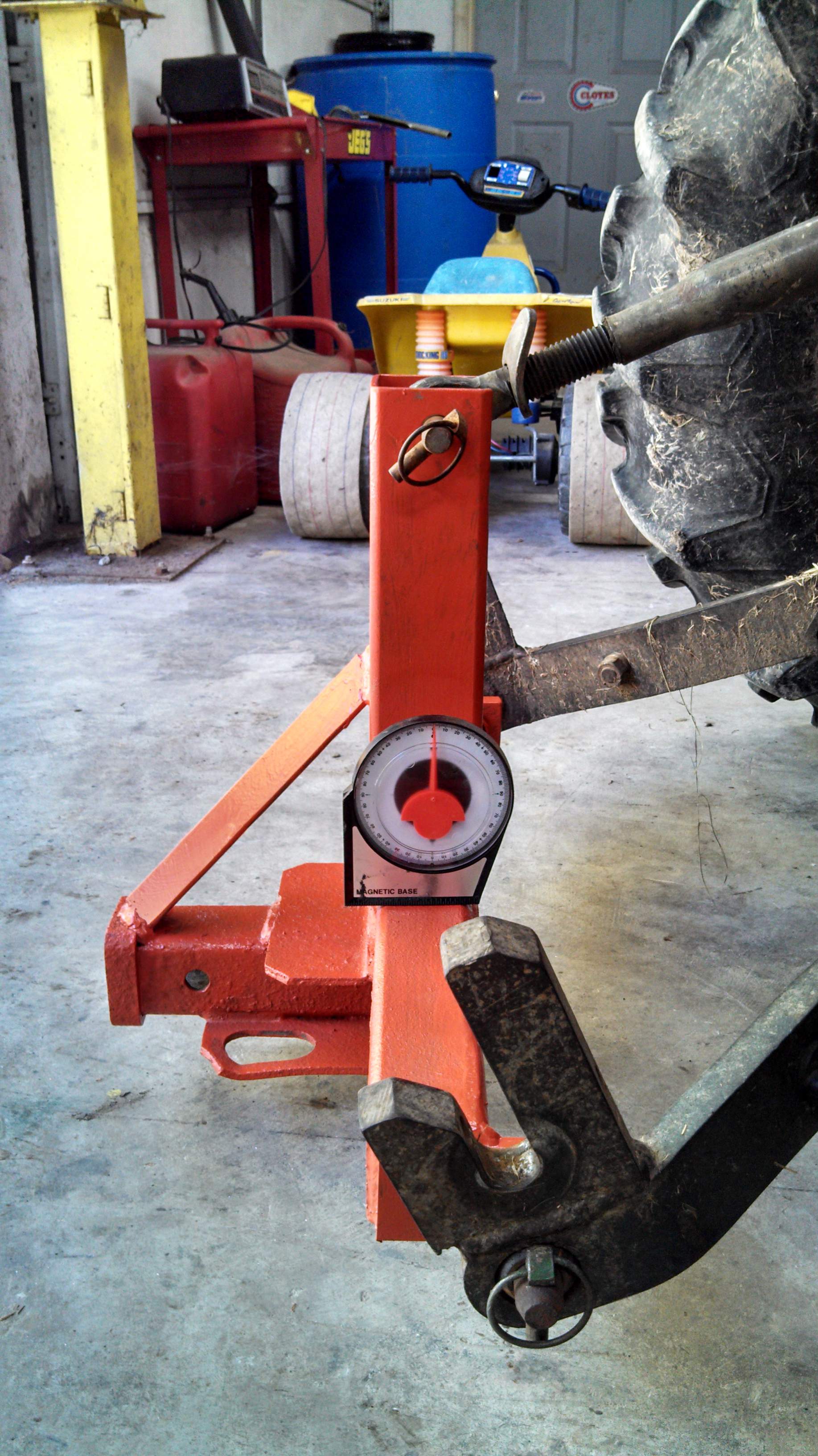

Well, these older square tube hitches definataly make it easier to adapt to a 3PH.
Lots of newer stuff is going to round tube with fancy curves and stuff.
My guess would be shelton didnt have tooling to make fancy hitches, and probably didnt get a big contract from detroit. Back then, most people added hitches to trucks. IT seems now most trucks already come with one, so that likely hurt them. But I am just guessing here...

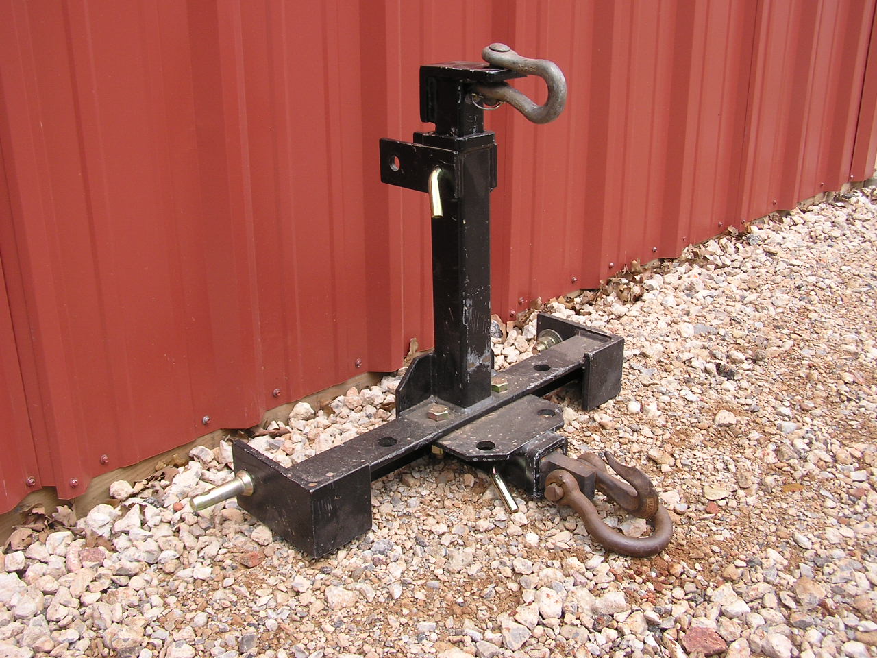

   / Made a new 3PH trailer hitch (reese) #23
Now where is the fun in that?? No fun, no welder now since we moved :(

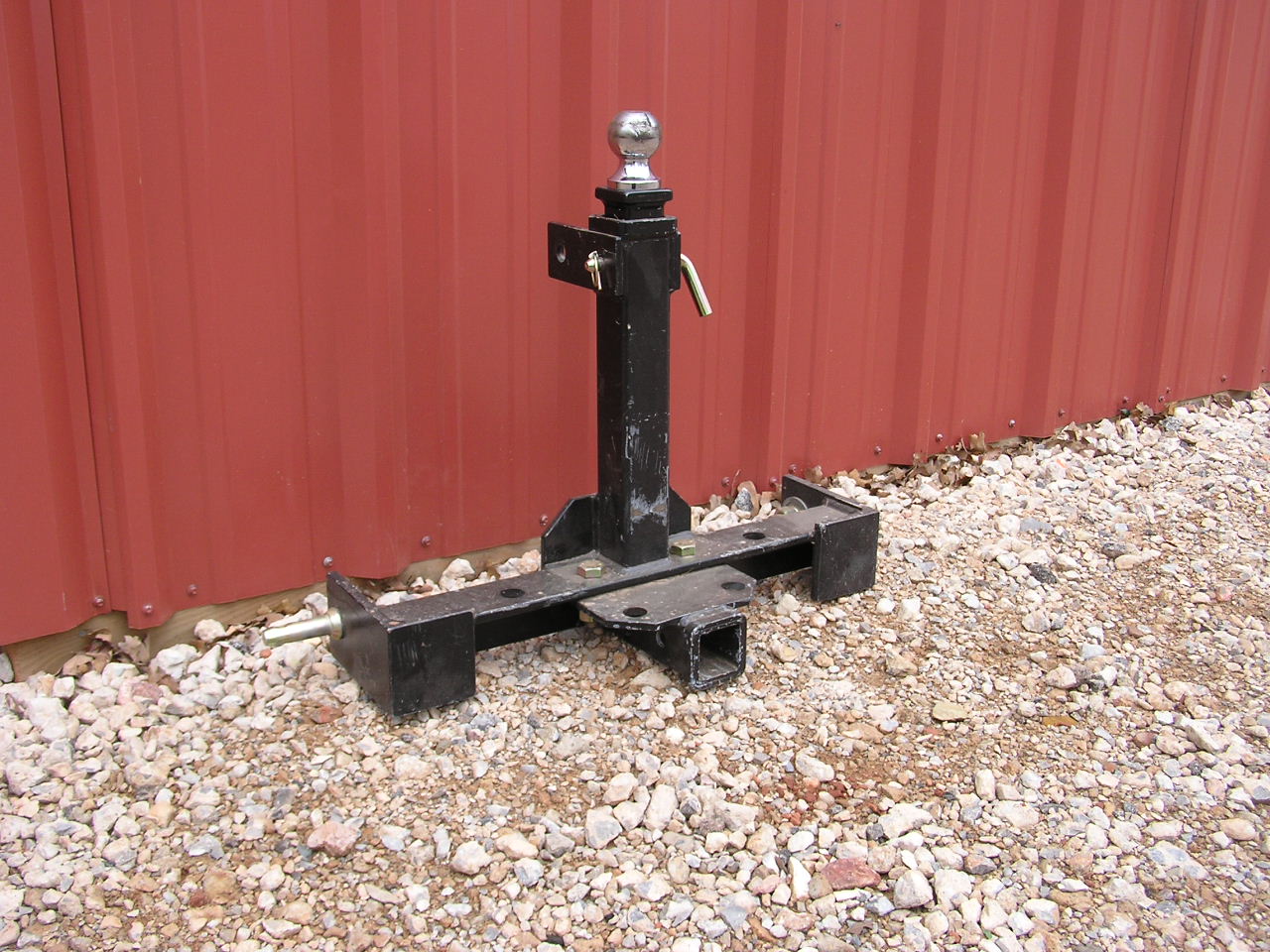

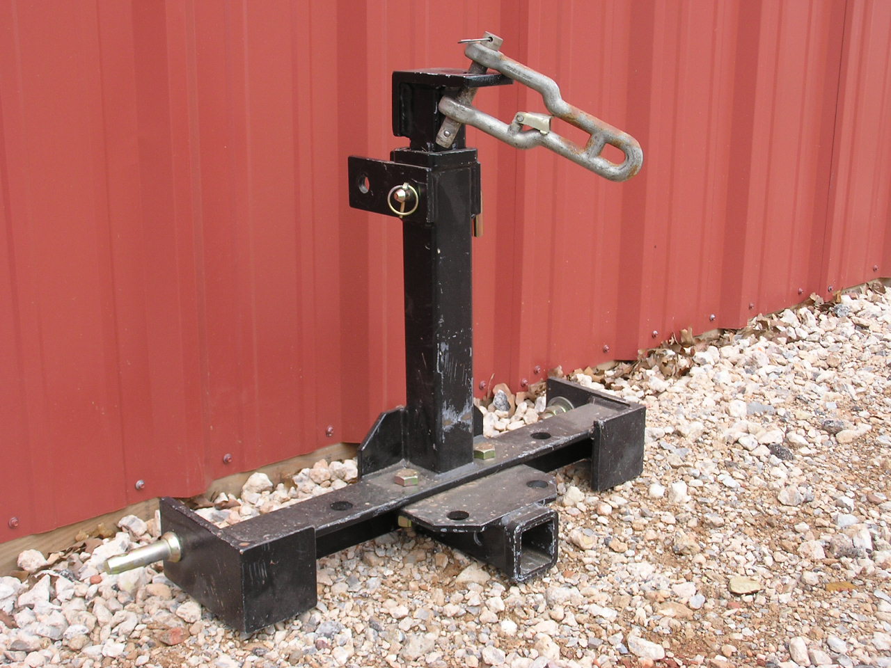

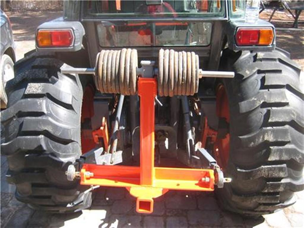

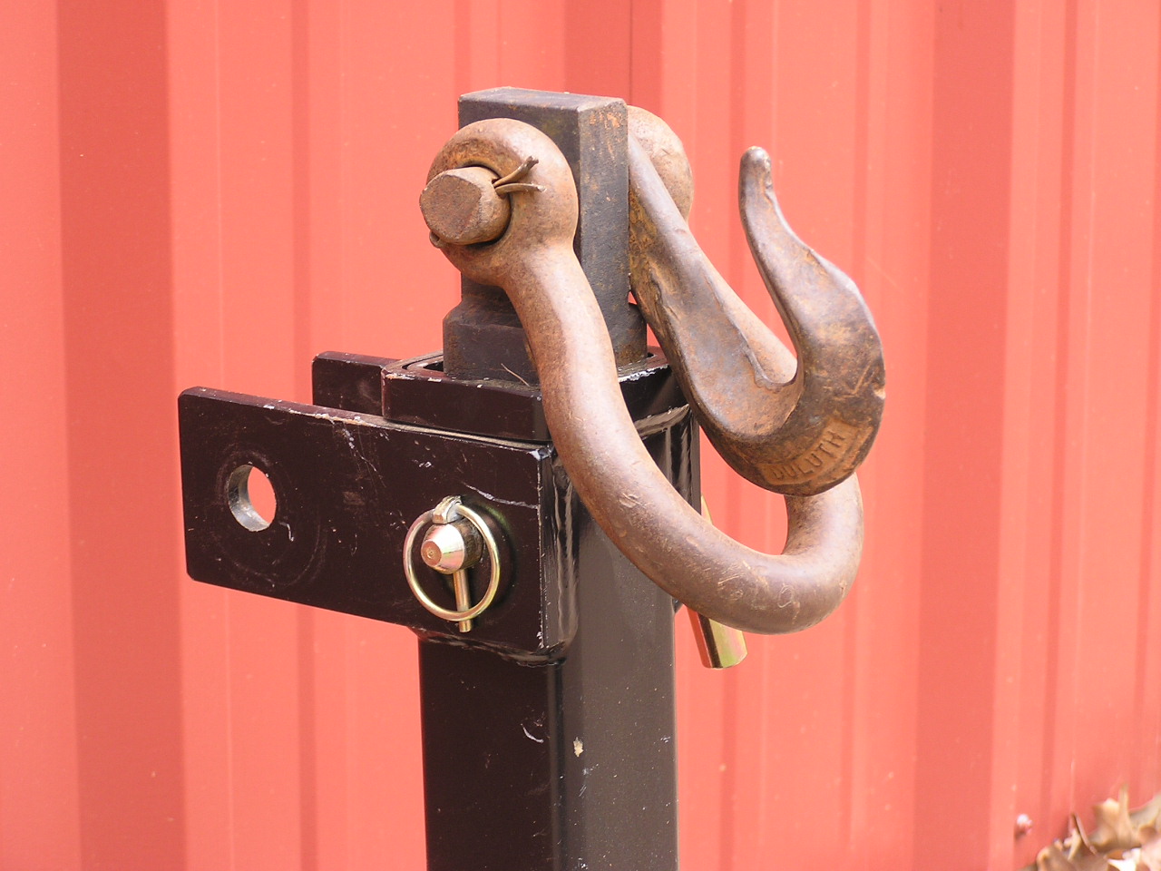

Since you have one though, let me ask this....It looks like the reciever part is only bolted on with two bolts?? is that correct? Yep, 2 grade 8 bolts. I dont know if I would like that or not. I tend to use mine alot skidding logs, by chaining tight and using the 3PH to lift the log and then drag. I like a welded unit for that.
I use it on the Toolcat, so not worried about the bolts.

I just enjoy making things. And saving money to boot.
IMO, the combo hitch just dont look heavy enough for what I do. I would rather it be a boxed tube for the cross, and those sides where the pins mount just dont look heavy enough either.
If I was just moving trailers it would probably be fine. But I skid logs with mine, so it gets all the force the tractor can muster. And when skidding a big one and using the hitch to lift and add all that weight to the rears, can be alot of force.
Theres probably a dozen plus companies that make a hitch. Since it didnt cost me any money, and only a few hours, I could never justify buying one.

My reason for posting was to show the receiver tube at the top.
Back when I had a welder I made one like yours, then had to add a ball for the gooseneck, when I got the first GN trailer.
