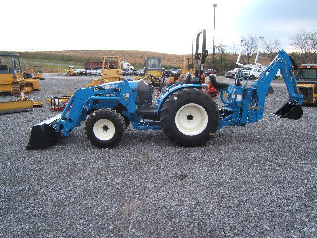

I bought the 2011 LS R4041 with loader and front bucket attachments. I've used it to move dirt and dig ditches. I've found the the frame flexes so much that I have now sheered off the attachment bracket bolts 3 times. The dealer where I purchased it from has turned out to be no help what so ever. I am curious if anyone else has run into this problem. Its a little frustrating. Thanks
   / LS Loader Performance #47
...I have now sheered off the attachment bracket bolts 3 times.
Could you give me a better description of what bolts these are? Can you post a picture of them?
I believe you would have the LL4101 loader. I have the earlier LL4100. I doubt mine has the power to hurt itself.
   / LS Loader Performance #48
there is a large bracket on the underside of the tractor that the attachments slide into and lock the bolts that hold on the bracket are actually bolted into the engine block. i am unable to get pictures at this time due to my tractor being 2 1/2 hours away from where I live, but maybe I can find some pictures of what i am talking about online and post them.
   / LS Loader Performance #49
okay so I found one. Ironically its from the dealership where i bought the darn thing. It is the blue bracket you see under the tractor and the front of it bolts into the engine block. those are the bolts that are being sheered due to the flexing in the frame. i am not sure if it makes too much of a difference but i can't seem to remember whether mine is a R4041 or a R4047. Thats Monday for you.. Thanks
   / LS Loader Performance #50
Yes, I went out and looked at my R4010 and I thought you might be referring to those particular bolts. The R4010 is the 2010 version of the R4041. The only two differences between the two models I know of are the placement of the loader joystick and the size of the bucket cylinders. I will keep a close eye on those bolts now.
Those are pretty big bolts. Hard to imagine them shearing off. It definitely should not be happening.
