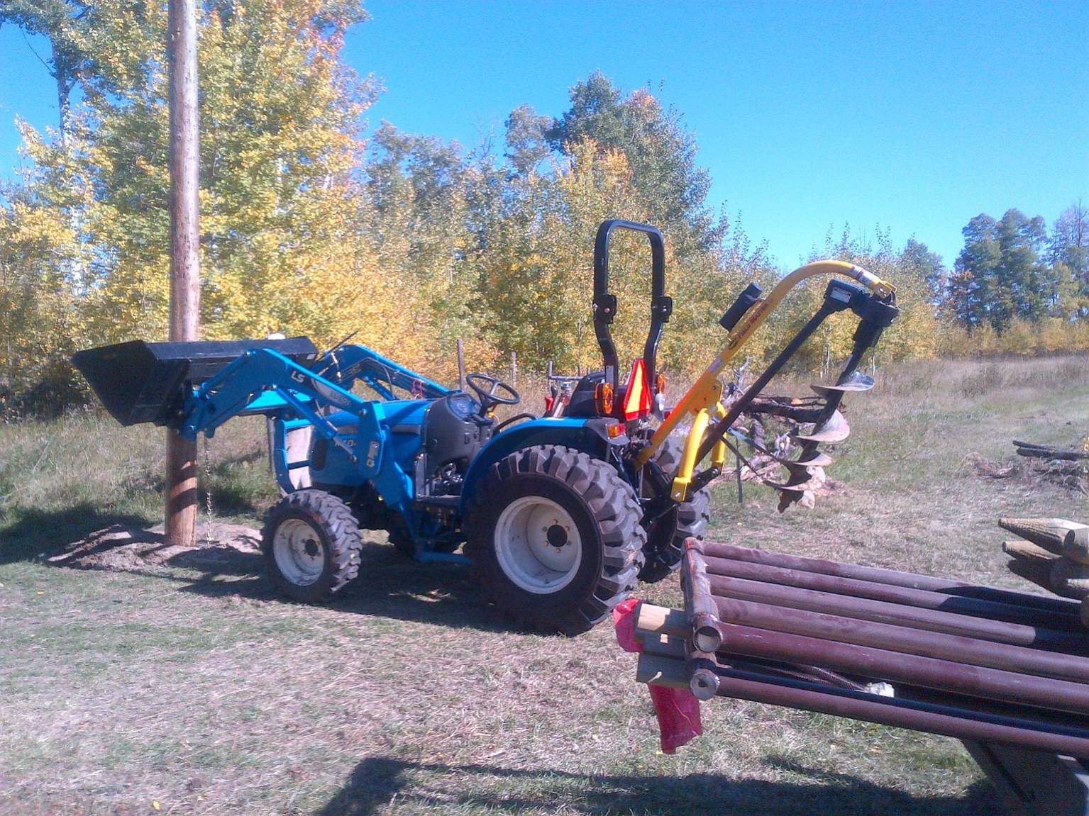

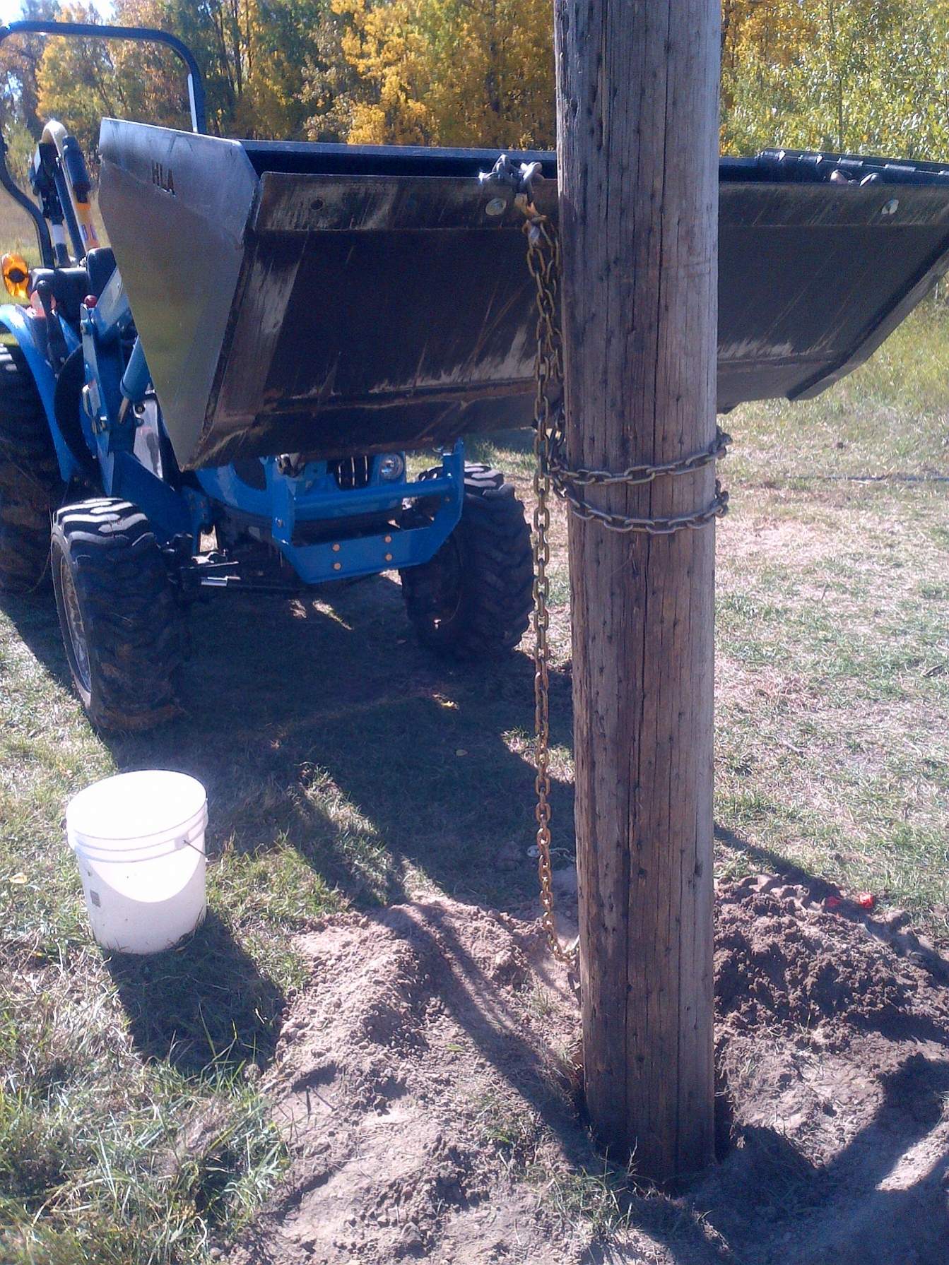

I agree there is defionitly something wrong. I relise that my tractor is the next size up but it cur;led 1800 pounds without even a drop in RPM at idle!..Not sure how heavy that mower is but i am gussing it shouldnt have given you any trouble..
Uploaded with ImageShack.us
i am not professional rigger:eek:
