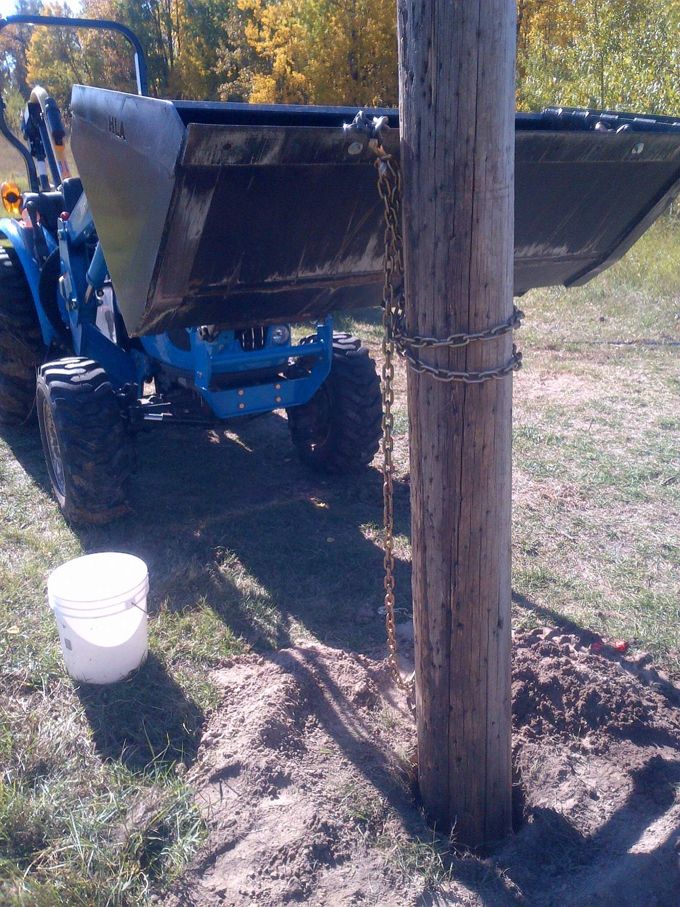

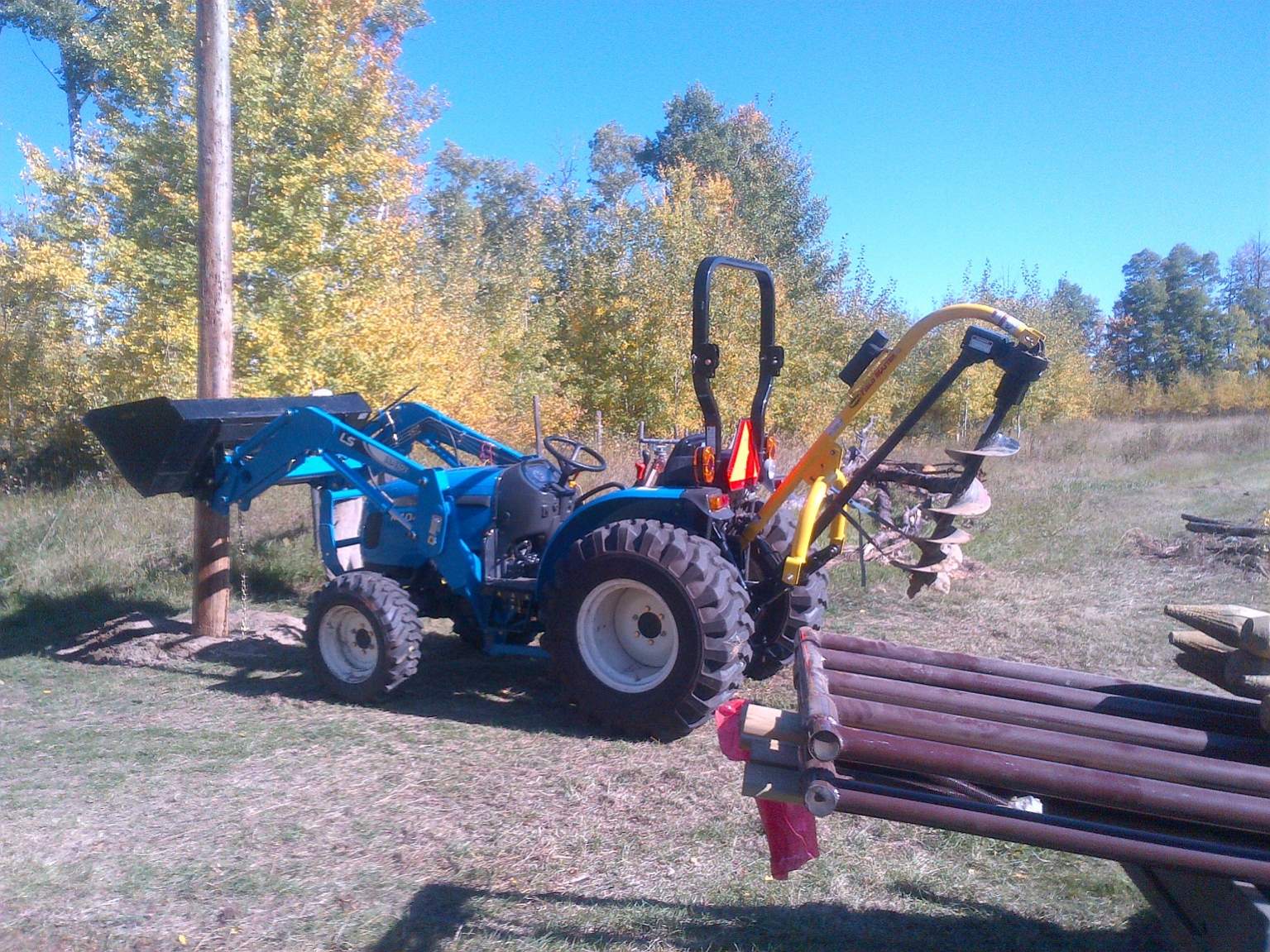

Here are a few pics of the 4101 loader installing a pole with our R4041H
