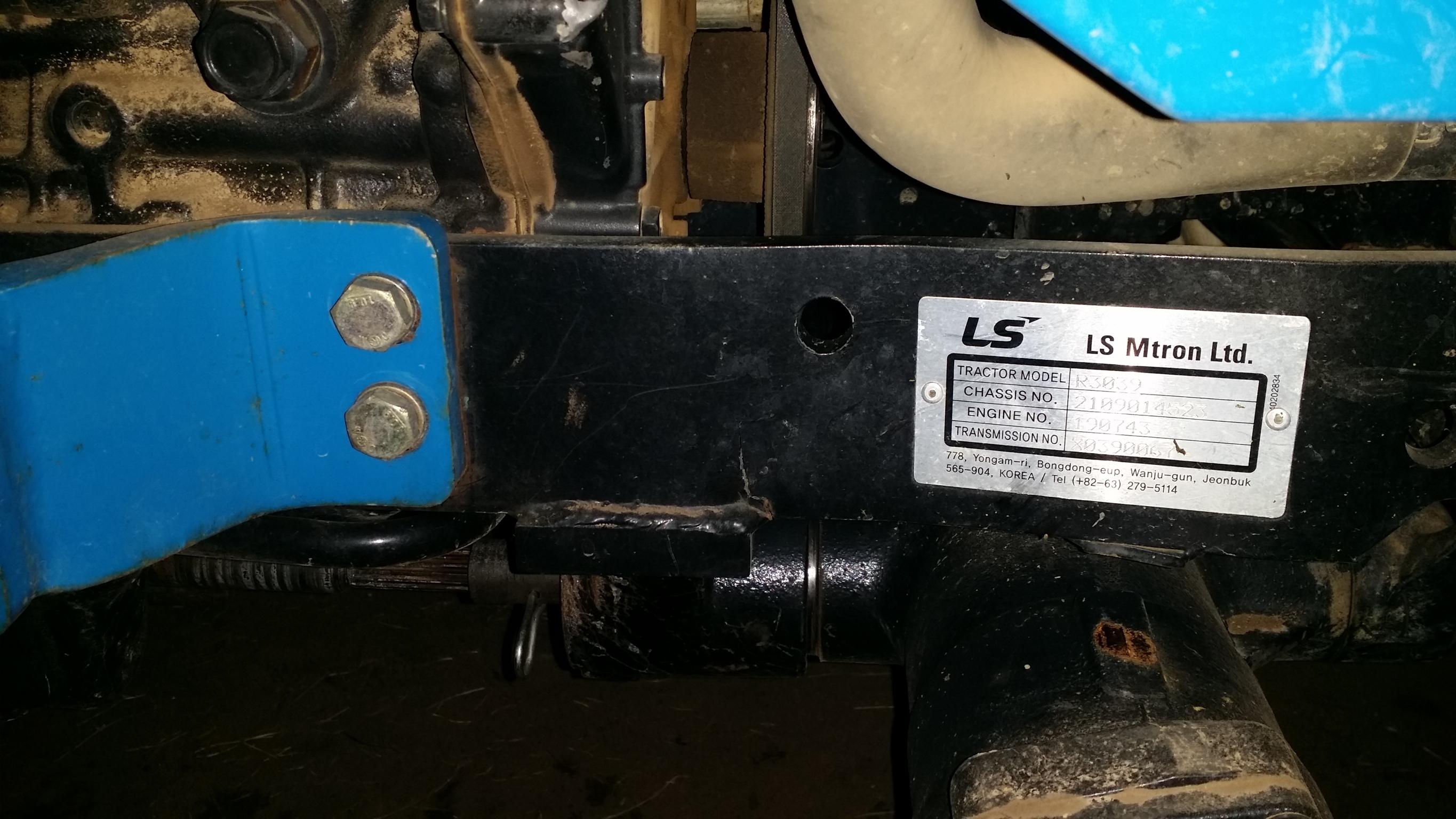

I think its just not enough metal on the R3039's, nothing more than that. The frame on my R4041 is easily double the thickness of the cracked ones when you factor in the extra plate that acts as a "strongback" so to speak or stiffener. Its true the casting of the front axle could contact that frame as it flexes/pivots, but you would have to do so pretty catastrophically and repeatedly to crack the frame on both sides. No doubt its that the loader is too heavy for the frame, it weighs 1000 lbs nearly. If you apply a downward force on something like a 2x4 that is on edge, the crack will most likely appear starting at the bottom. Remember, the R3039 is really an economy version of the R4041/47's weighing in 1000 lbs less. It seems like it's supposed to bridge the gap between the G and R series, an economy 40 horse tractor. It was discontinued for good reason, most likely b/c its too lightly built.

Looking at my tractor some more tonight, the more I think that it was a flawed frame to begin with. The cracks are just in FRONT of the 'rear' axle mount. Essentially putting the cracks between the 2 front axle mounts. Really an odd spot to crack just 'due to weight in the bucket' like my dealer suggested. I am going to maintain what I said before about the crack starting at the weld. I suspect it wasnt properly heat treated after the weld, therefore causing a fatigued joint to begin with.
Its really the only way to explain the cracks in that location.
That welded plate causes an abrupt stiffness change -- a stress riser. Its not the weld per se, but the notch effect due to the lack of blending from one stiffness to another in a hi stress area.

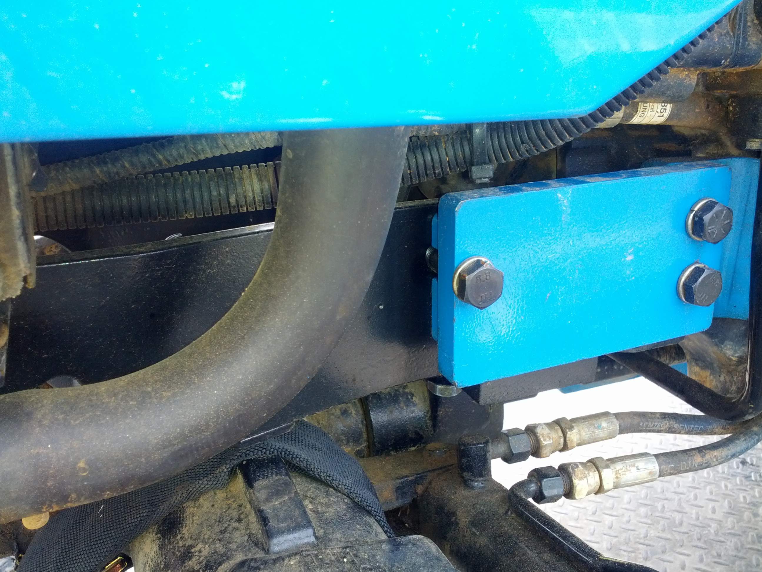

I would suggest touching base with your dealer. If nothing else, you should at least get the updated loader brackets. Keep in mind... you have had it 2 years... meaning, you have only 3 years left of warranty. It would be a royal bummer to have cracks show up in year 5 or 6 that were possibly preventable.

They have scheduled to take the tractor into the shop on July 7th and do the work. To be replaced, are the actual frame rails, fan shroud and fan. As well as adding the additional brackets.
When I stopped into the dealer they were aware of the potential, and they were shocked I didnt have the 'bracket upgrade'. Funny really, since they knew it didnt have them when I bought it! LOL

I never got to see the difference between frames since the dealer that did my repair is an hour away but they did tell me there was a difference. All I could tell by looking was the extra plates which about add up to the same thickness as the 41/47 frames.
