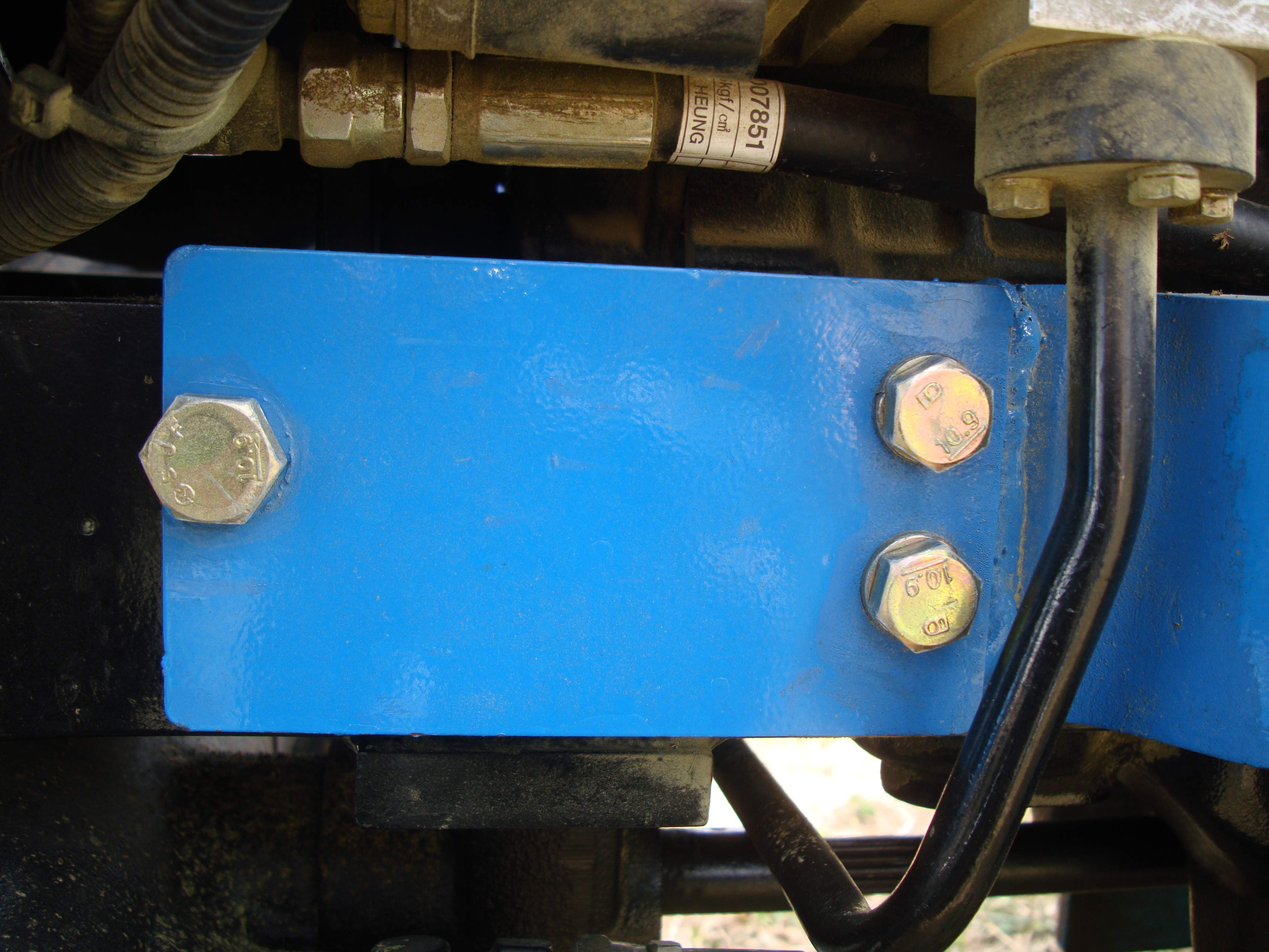

Can someone verify the reinforcing kit bolts are 10.9 grade and is the torque 76 ft. Lbs.?
For obvious reasons, I don't want to ask my dealer (who used 8.8 grade bolts at 55 ft. lbs.) who did my repair.
I'm afraid to switch to 10.9 grade bolts and that torque without knowing that's the latest spec. Don't want strip the casting.
I had the reinforcement kit installed on my R3039 in March 2015 and my dealer used grade 10.9 bolts.
/ LS Frame Issue Video #163
I called one dealer in my area and he was a total jerk and talked over me the whole time. I feel sorry for the customers that have to deal with him.
I called LS HQ in NC and was told the line mgr. said the torque is between 75-85 ft. lbs. This jives with the loader manual torque spec. for a 10.9 bolt (76 ft. lbs. in the chart)
You guys that got yours fixed that way ought to confirm the torque since I've encountered several dealers that will tell you something else.
