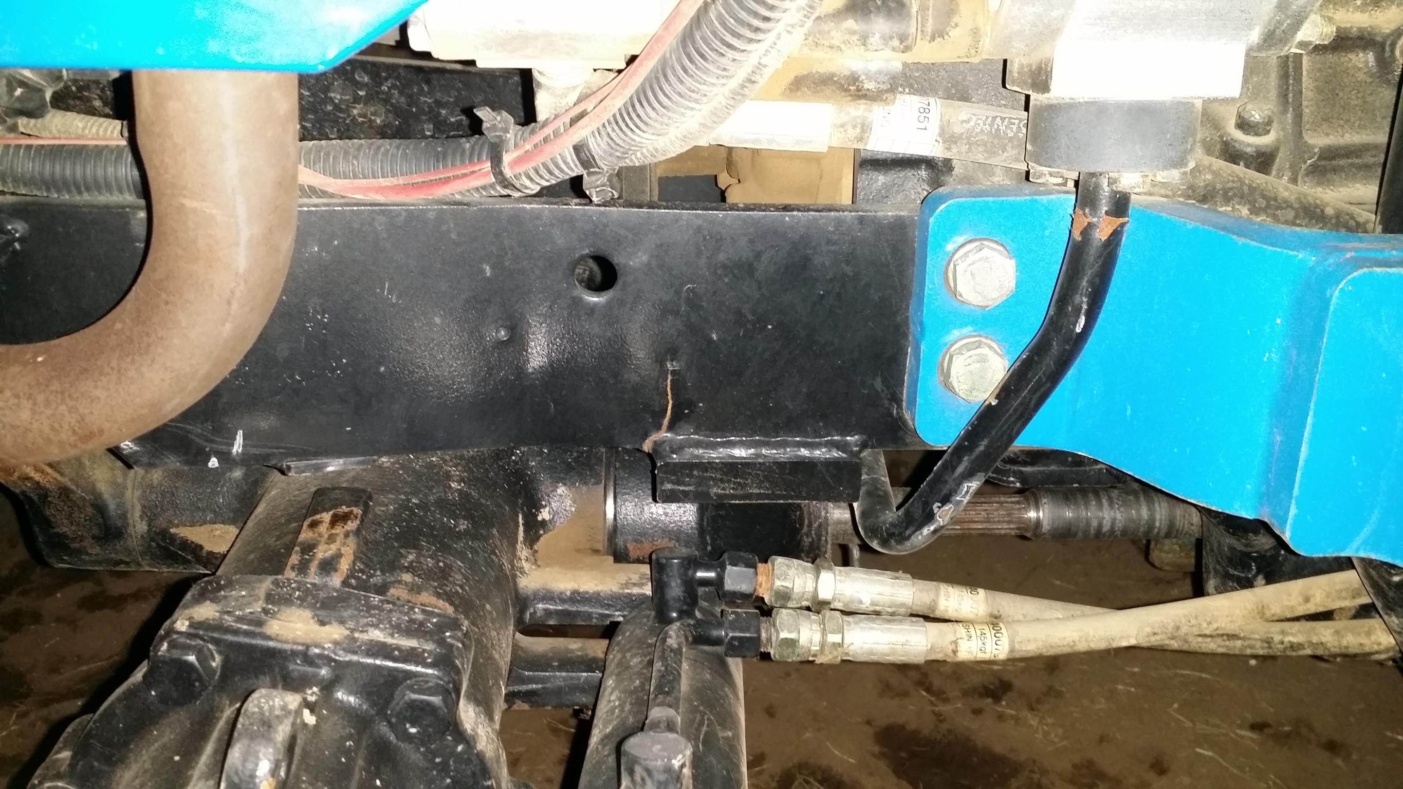

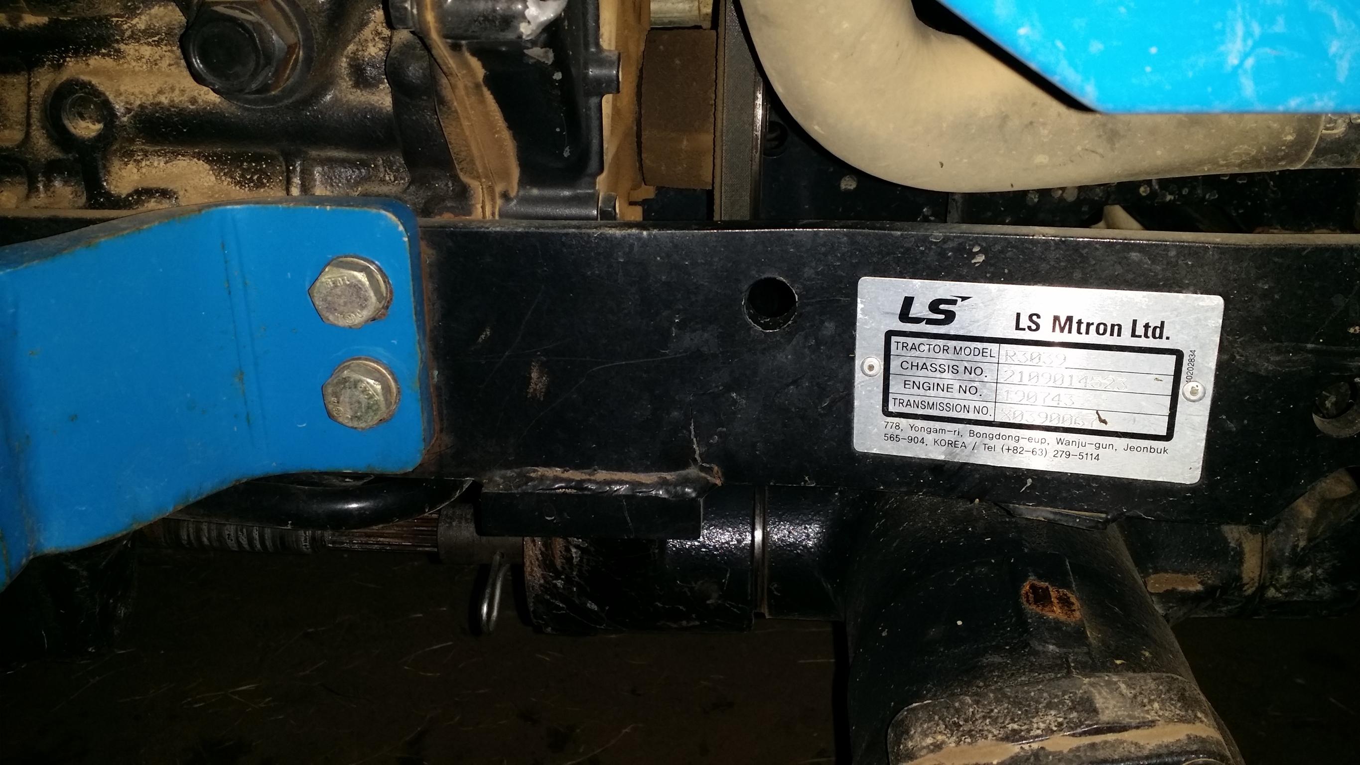

Is the R3039 the same frame as the XR3037C?? I am about to drop the $$$$ on an XR3037C but don't want any issues. Stepping up to the 40 series for me would mean another 10K in new WIDER attachments and i really don't want to go there right now.....
I know mjstef already has his XR3037C but for others considering purchases the XR3037 loader frame brackets are totally different design from what you see in the pics that have been provided so far for R3000 series. Here are pics of my XR3037HC loader mount brackets. There are 3 bolts in front and 3 at the back of the bracket. At the bottom is another bracket (square tubing) bolted to the lower part of the loader mount running to the back and bolted up to the rear differential.
Very similar actually, your second picture is just to the rear of the location in question...
