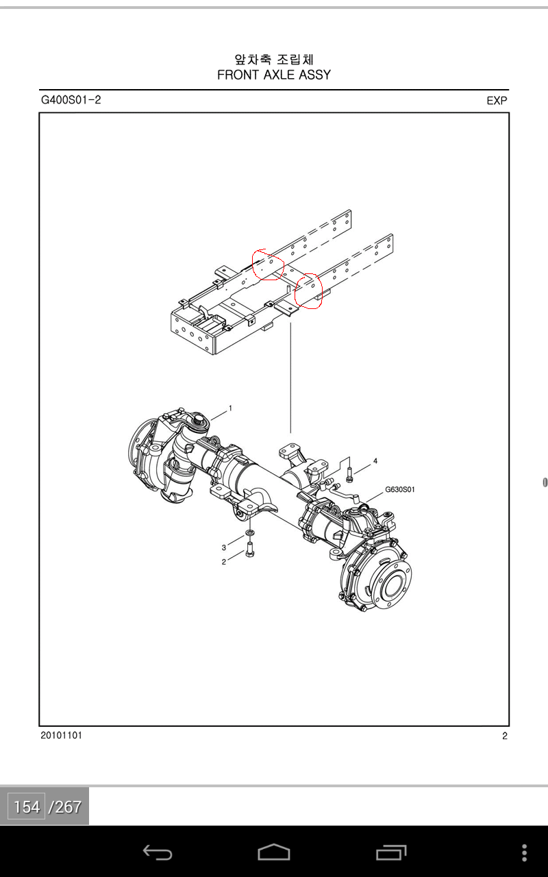

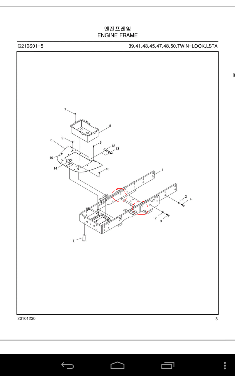

I think the issue is simply the loader is too strong for the frame in that area. The loader mount distributes the weight around and I think (I'm not a materials expert) there are twisting forces in that area (not up/down but left to right or from top of frame to outside) and the cross member limits this on the bottom so that abrubt stop is where the stress is. As I said before, the 41/47 is three times thicker in that area.
So it isn't quality of steel ... its because LS gave us the highest capacity loader in its size/class and someone missed some 2nd and 3rd order effects of that choice.
And technically, the warranty is only 2yr general which is what the frame falls under. Yrs. 3-5 are power train related.
/ LS Frame Issue Video #103
Here is a visual of the differences.
This is the R3039 subframe:
This the the R4041 subframe (same as R4047):
/ LS Frame Issue Video #104
Great Post!!!!
Wow, 2 pictures are worth a thousand words. I hope LS stands up and reinforces all the 3039 frames, it clearly is a design defect which shouldn't be the responsibility of the current owners, no matter how old the tractors are. :)

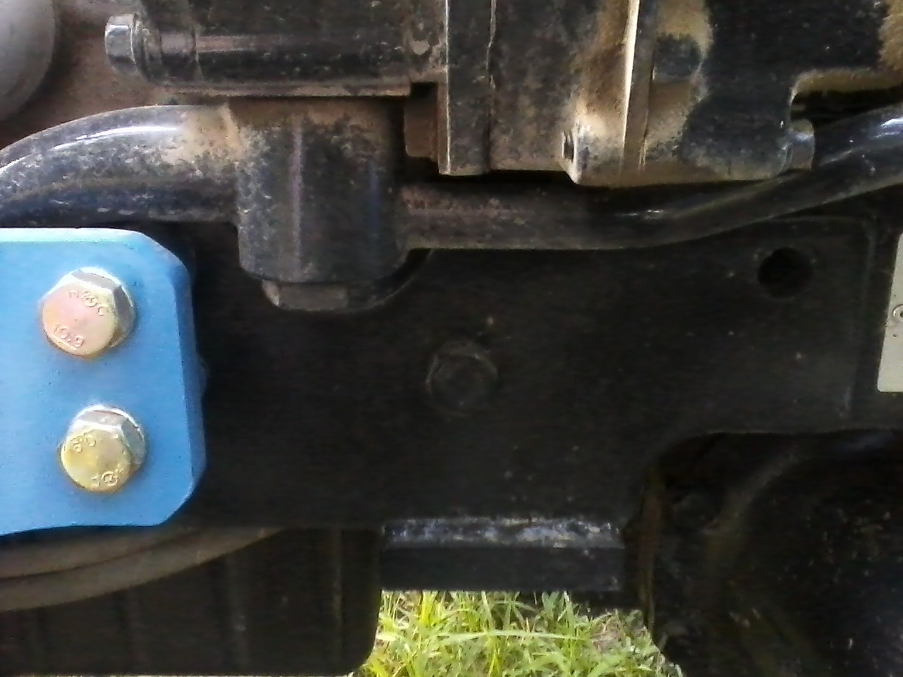

I'm about to purchase a 3039 today. Is there an easy way I can verify if the upgrade has already been done? I've tried to study the photos but it's confusing.
/ LS Frame Issue Video #120
The pictures are of the frame area just above the front axle. The blue loader frame originally ended with the the two bolts you see in the pictures (one bolt on top with another just under it in line). The new loader frames or tractors that have the reinforce kit have a thick blue plate (or solid metal in the case of the new loader frame) that runs beyond the two inline bolts and ends with a single bolt. Hopefully that explains the pictures a bit better.
I guess another easy way to say it is if there is not 6-8 inches of blue metal between the top/bottom bolts and the data plate on the frame, you don't have the fix.
