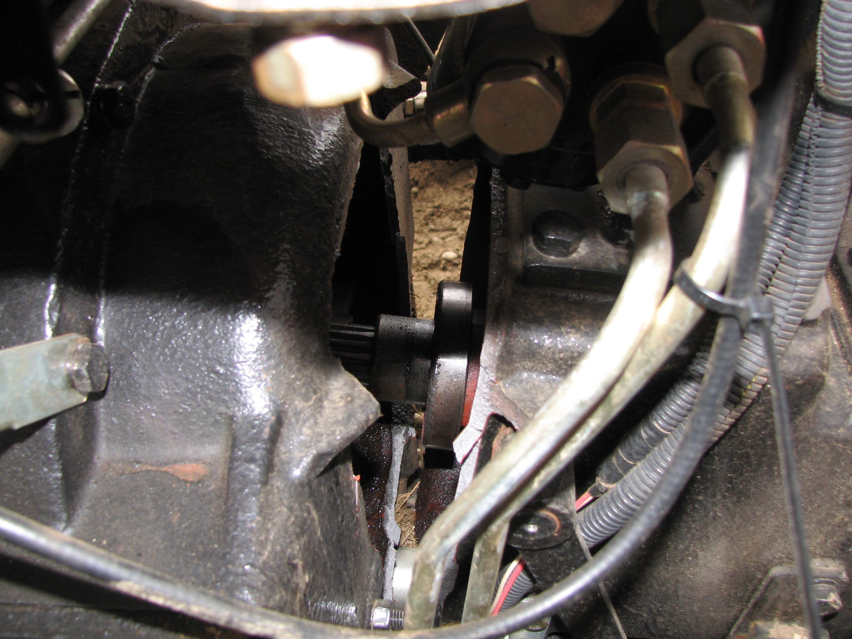

Now I'm worried! Took my week old new-to-me R3039 out for a spin (just driving it) and thought I smelled something funny like brakes or plastic.
Discovered fan is rubbing the bottom of radiator shroud. There are pads on each side of frame that look like they protect from the axle from making contact ... there is a cross member in that area too and it looks like there may be a crack starting from the bottom of frame growing up.
Is this the same area as the video you guys saw? I never was able to view it.

I watched the video too long ago to recall the details. Either way, I'd call your dealer immediately, and not use the tractor until they've looked at it.

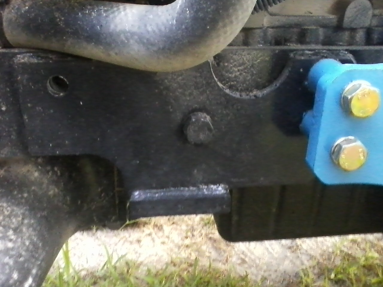

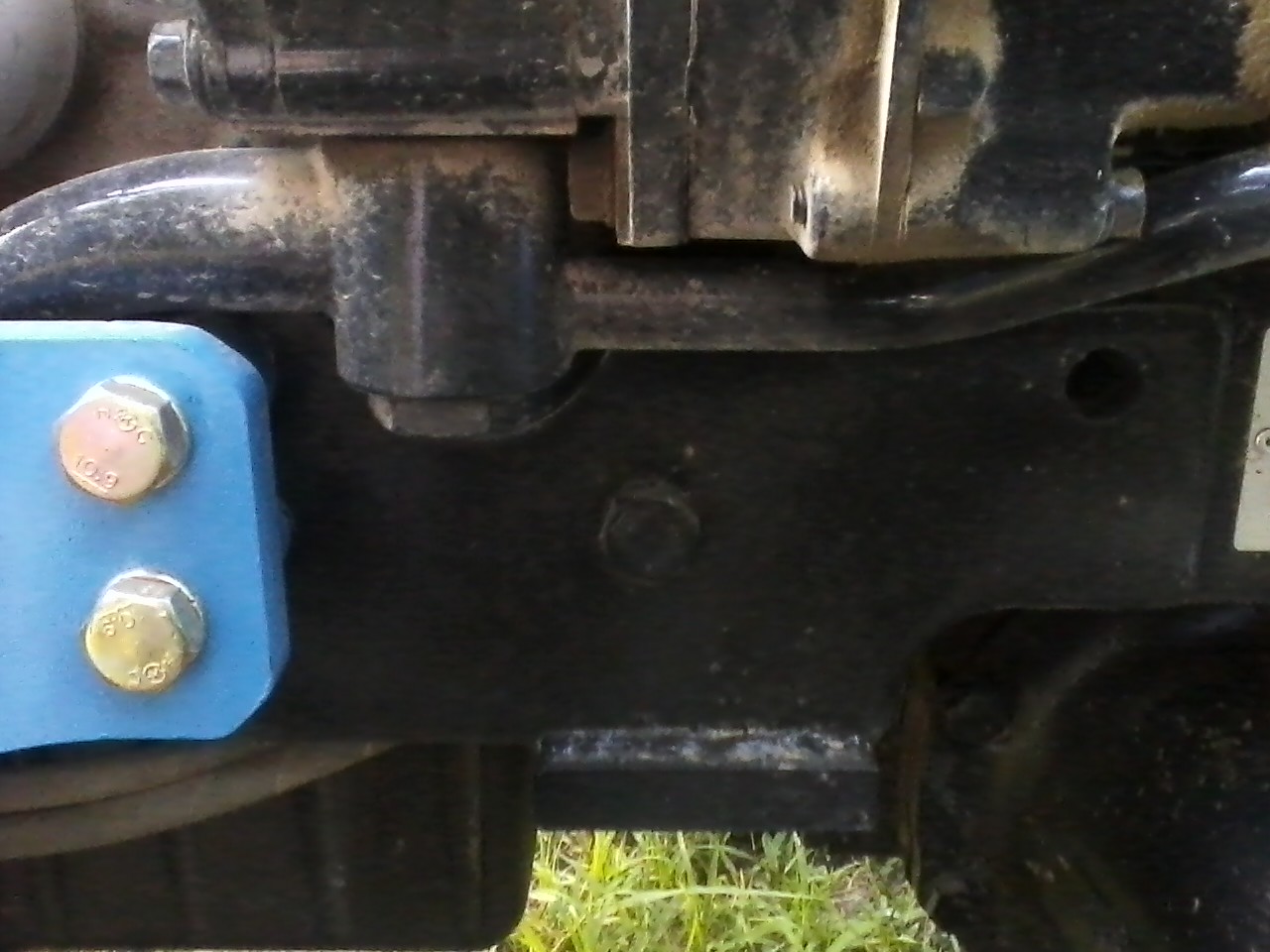

R4041RtFrame.jpgR4041LtFrame.jpgMangus and all,
Here are a couple of closeups of my R4041 frame in the same area of the tractor. Definitely beefier than the original frame of the R3039. Maybe this shouldn't surprise some people as the R3039 is 1200 lbs lighter, and that weight has to come from less metal throughout the tractor......hope this helps. There is definitely more metal in this area of the frame.

In the second picture are you missing the front bolt?
Guesseral,
I don't know.....I was wondering the same thing when I took the pics, I have a bag of extra bolts from when the tractor was delivered. I'll dig them out and see if they fit, one would think there should be some in there, but with both missing I'm also thinking maybe the holes serve another purpose.
Tom
