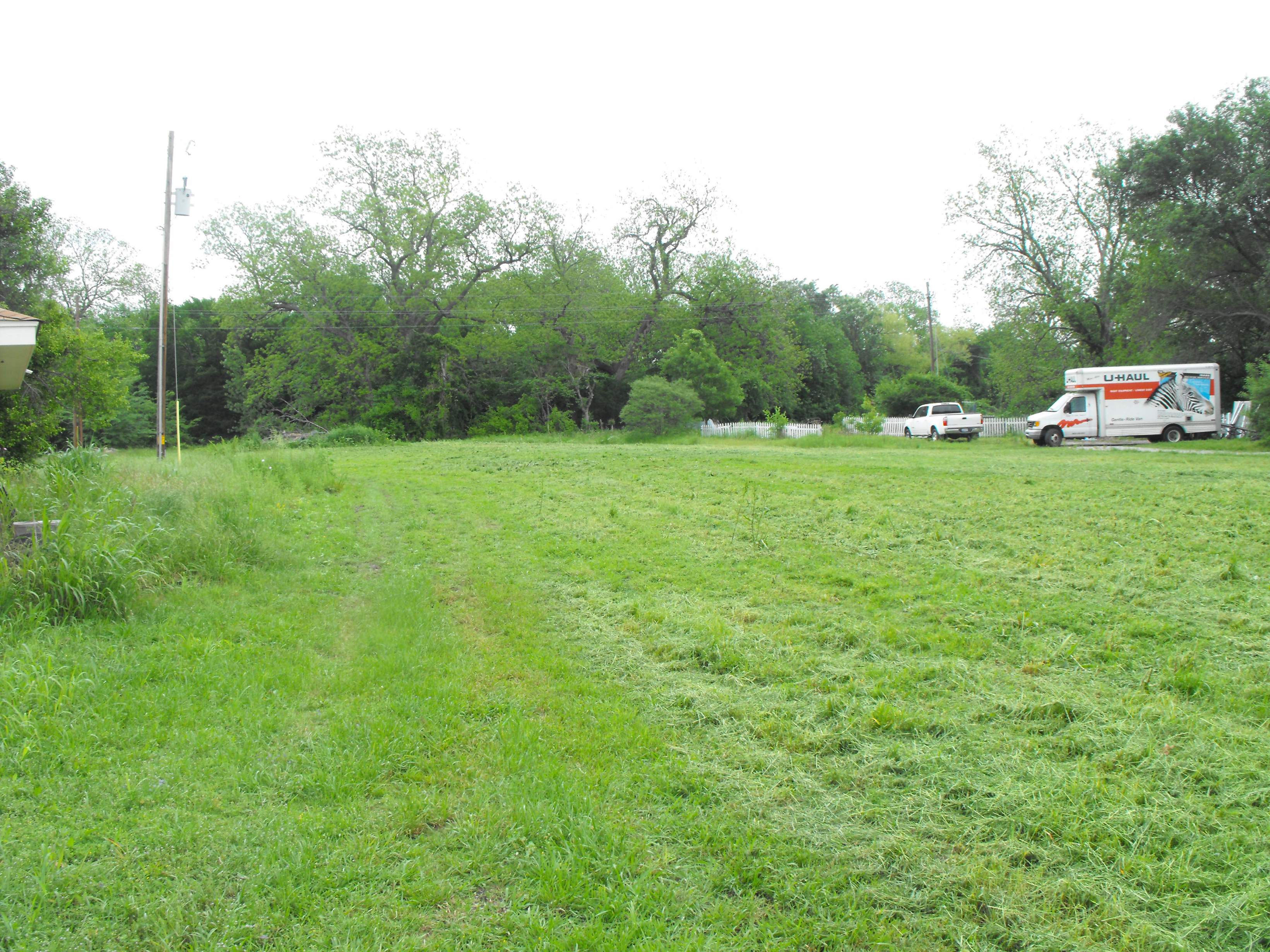

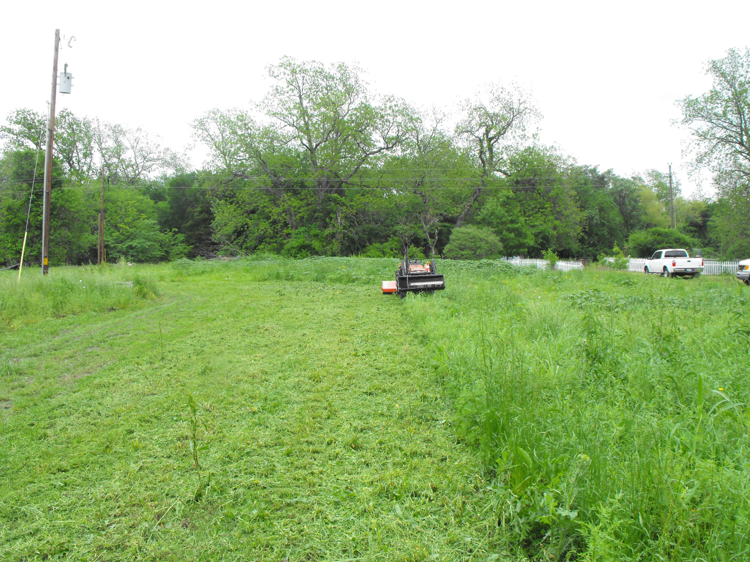

Here are the pictures of my 60" Befco and the work it does on a Yanmar 1610D. I love the way it doesn't throw rocks.
It doesn't pull the engine down, just go slower than normal.
/ Low HP flail mower #90
Forgot the pictures. First time try.

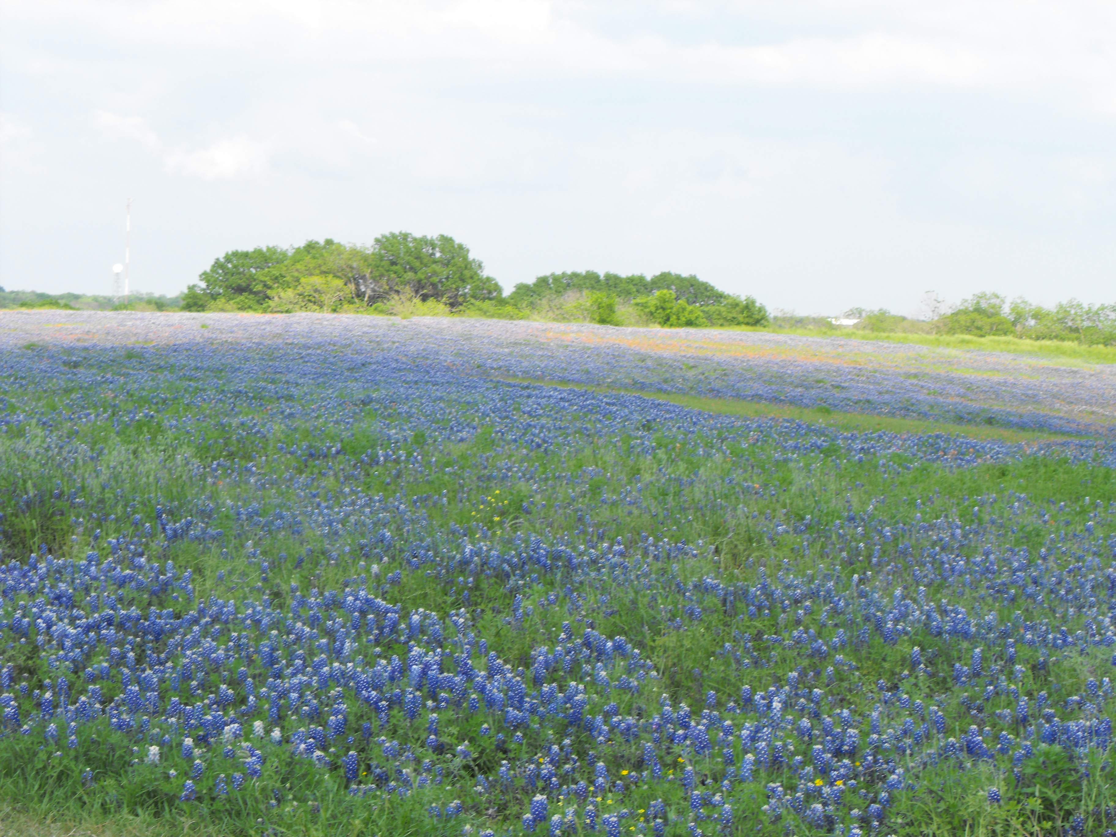

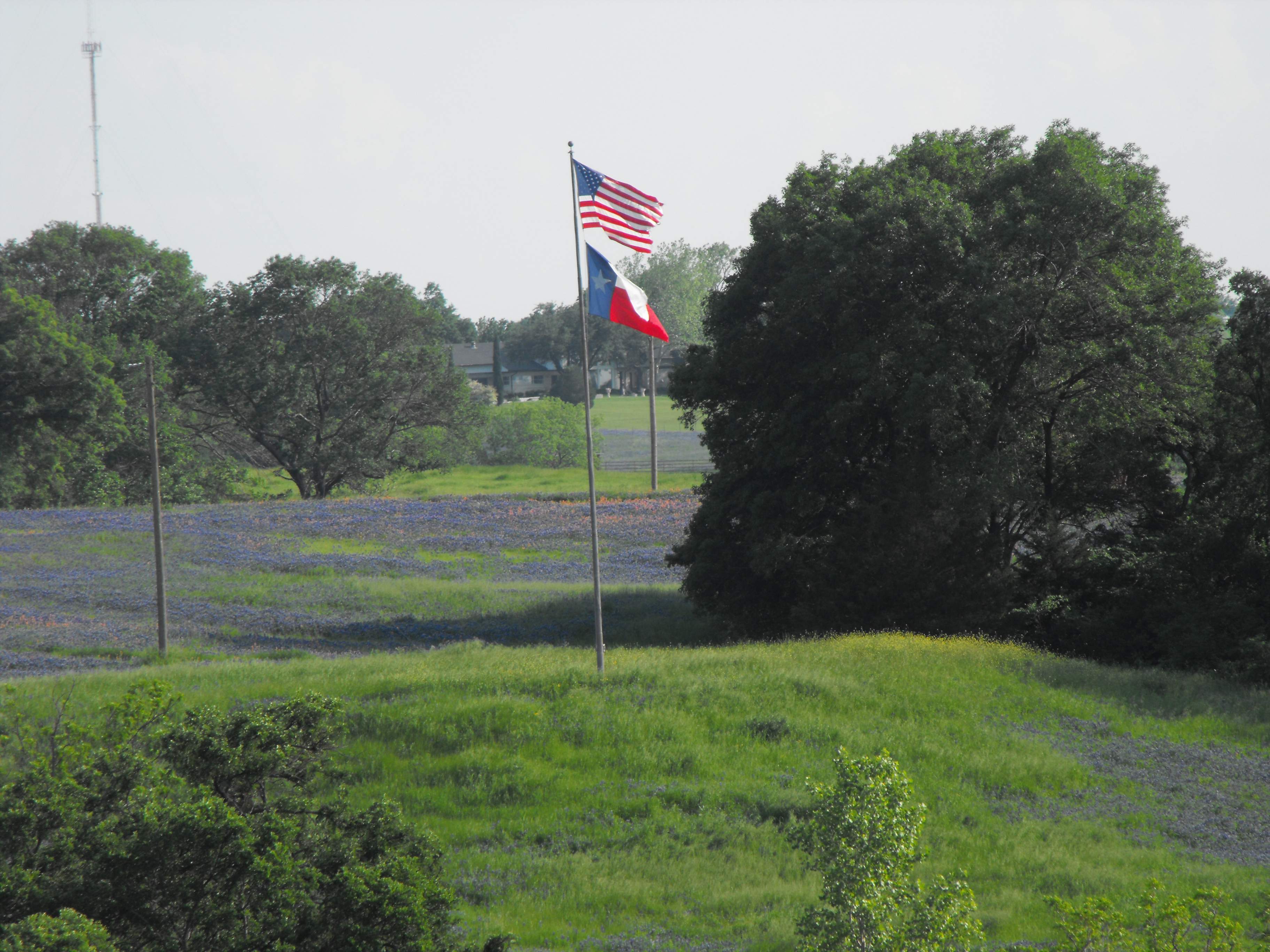

I'll get these posted eventually. Also, some bluebonnets.
