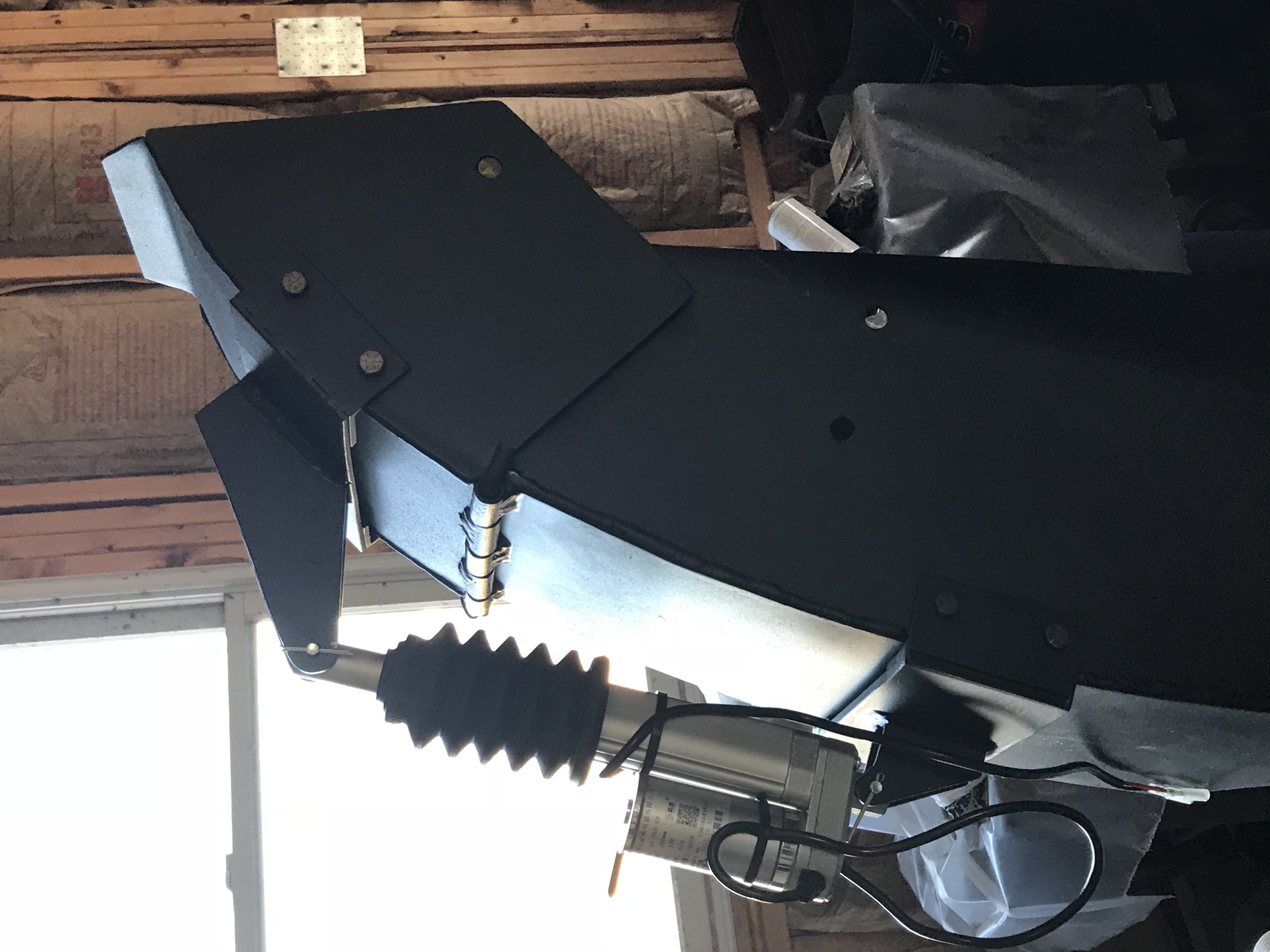

I just modified the factory non-powered deflector.
   / Lorenz 730 Blower #25
Looks good, did you source the kit someplace or just build it yourself?
   / Lorenz 730 Blower #26
I fabricated the brackets and bought the linear actuator off of the auction site for $32. 300lb 4 stroke IP65 which is more than enough travel. I added the shock boot to keep water from running down the shaft and freezing since the actuator end plate is composite. I wanted it bolt on in case I wasn稚 satisfied with it.
I bought a small 2肺2 aluminum box and mounted a forward / reverse toggle switch which fits in the palm of my hand and wired it up to a 12VDC lighter plug off an old spotlight. Plan on running the wires up through the cab by the hst range lever or simply between the back glass and seal.
