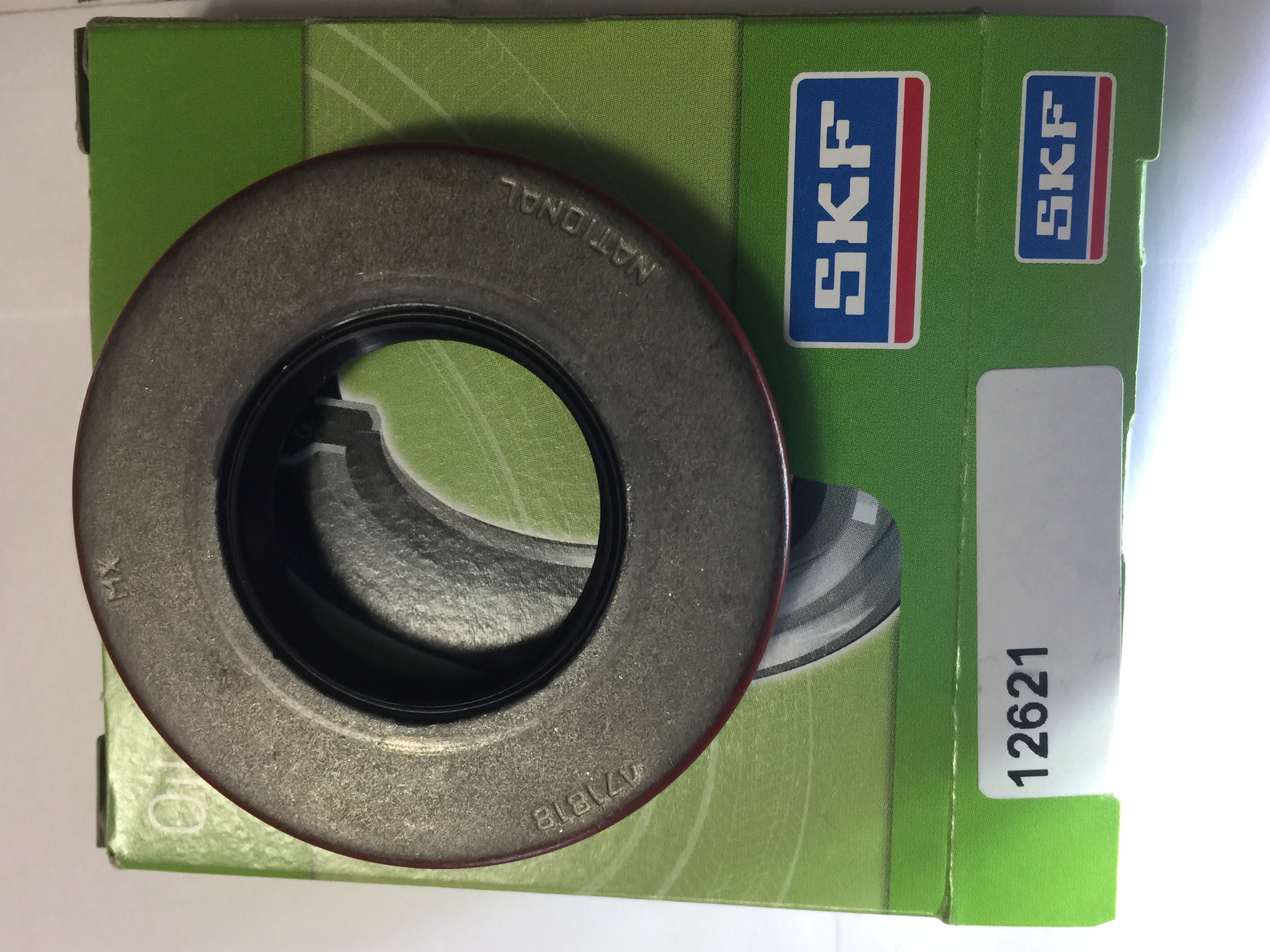

Not buying anything from Lorenz as most of the parts are basic general parts like seals, bearings chains ect that can be sourced at local parts houses or ag stores. Just takes a bit of time to get part #'s to cross and or in the case of the bearing had to measure it up and search out the part #'s that way too. I just torched the inner bore of the bearing off the shaft after trying to heat it and air hammer it didn't budge it.
