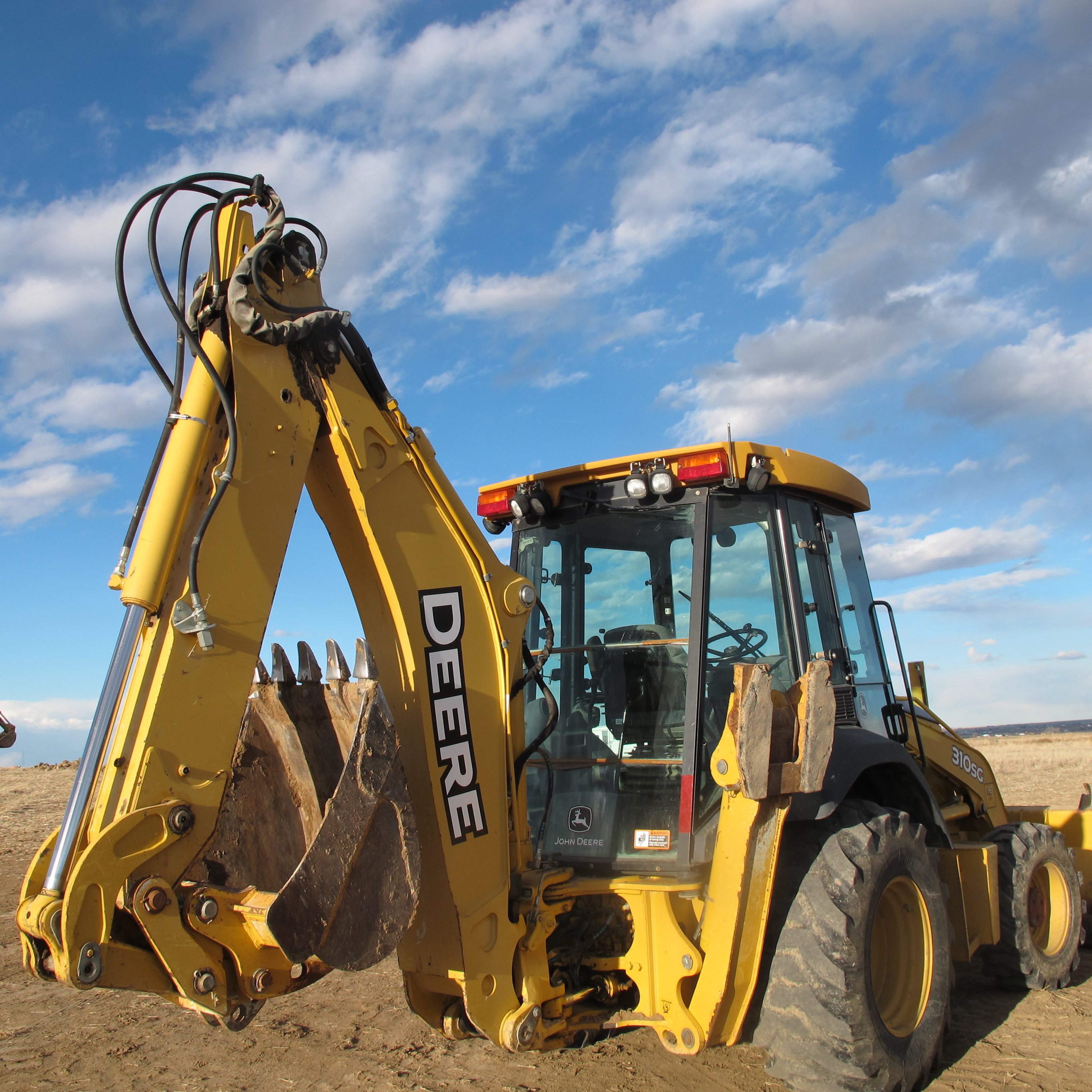

I got a lead on an 87 Case 580E. got the extendable and 4x4. going to look at it now, was told it's in decent shape. it's a friend who knows the seller, friend says he trusts the guy, sold him a tractor years ago.
anyway, we'll see. it's got 4500 hrs on it and priced for 12.5, perhaps I can get it for less.
this has the cummins 4.39 and about 63 HP and I believe and the geared transmission with shuttle shift. not sure if that means it has a TC or not.
does 63 HP seem like enough to move a 7 ton machine with buckets of rocks up and down a slope for a few years?
anyway, just wanted to see what the pos/neg are for a machine like that.
thanks as always for the thoughts.

HP not that important w/ industrial tractors. Would suggest oil analysis. Not very expensive these day, some owners are offended. Something to hide? Rather pay for a test than an engine, Check entire tractor for leaks, especially cylinders. Seals are often worn, allow dirt into reservoir/ pump. If oil recently changed, test results are skewed. Inquire if radiator flushed, coolant changed. ? Listen for plugged injectors, some did have head gasket issues, but most of those Cummins, good motors.
Know these older BH's can be money pits, eyes wide open.
/ looking to purchase TLB for 30 acre homested #32
-Check the brakes (can be a bigger task to fix than you might think).
-check the backhoe valve manifold for leaks. That can be a real pain to fix and expensive
- check for blow-by into the radiator or crankcase exhaust and water in any of the oils for that matter. At 4500 hours you got to think the piston rings would be worn if they haven't been replaced.

63 HP in those lowish RPM industrial engines is plenty of power for anything. My JD 310 is only a little bigger and the only chance I ever get to use more than half throttle is when I'm roading it somewhere uphill.
4500 hours is nothing on JD, Case, Cat engines. Even less of a worry for the non-turbos. If it has seen anything close to routine maintenance and use you will have no fears on the engine. Just well broken in.
The thing to check is brakes, leaks, and how does the oil/water/hydraulic fluid look. For that price I'd expect it needs tires. In fact, the only thing that concerns me at all is why is the price about half what the market goes for? What are your thoughts on that??
If it runs good now - and from the jobs you say you will have for it to do - then I'd expect that in the next few years you won't put enough hours on it to make a difference. Keeping it away from neighbors wanting to borrow it for their own projects is likely to be a larger worry.
Again, the only problem I see is what I don't see....and that's the why of the price, again.
If it checks out, grab it. You sound like a good enough mechanic to deal with routine problems.

That era of 580 tended to rust out in the floor of the cab and doors. Case also had quite a few backhoe control configurations: 5 stick, 3 stick and pedals, twin stick, etc. The 5 stick is one for piano players :)
They are good old work horses. Plan on doing a full service of basically everything. You'll probably have to replace quite a few hoses once your get using the machine, so find a place that can make them up for you that is close by.
/ looking to purchase TLB for 30 acre homested #36
I have approximately the same vintage 580D re-engined with the BT-4 Cummins-not 4x4 but extendahoe. Probably about 1500 hours on re-engine.
Brakes can be a major cost and PITA as well as loader and backhoe valve leaks. I have re-done brakes on mine and steering control valve seals. Overhauled dipper cylinder and boom cylinders-probably put 2500 into it in 3 years. Bought for 9000.
Great machines once you get rid of the for crap gauge panel that Case inflicted on these. I have dug probably a 1000 feet of water and power line trenches and moved, placed and graded 150+ yards of gravel. Love my hoe even though she’s a bit primitive of a beast. You’ll never lack for digging/lifting and pulling power- it puts the toy backhoes on CUTs and SCUTs in their place when it comes to working big or tough jobs.

All real good info, GS. I didn't think about rust; probably because it's rare to see rust here in Colorado. Don't know much about it.
And of course 4x4 doubles wear points as does extendahoe. Keep in mind that other than brakes, these old machines were designed to be built and rebuilt. They can be a PITA, but they are simple beasts. Lots of shop manuals available because they tend to age rather than break.
My buddy bought a basic 310 2wd standard of of that vintage on which everything worked ... but it needed attention to everything, too. If it had ever been serviced or even regularly greased it sure wasn't obvious. Over the past 3 years he has replaced a lot of pins, bushings, seals, and hoses. None of which kept him from getting a ton of work done with it. He even built a thumb for it! The upside is that it now works like a much younger machine. Probably worth more, too.
My own 310 hasn't been without maintenance. Something to consider is that parts & pieces are HEAVY. Even the batteries (2) are heavy brutes. When I took the boom cylinder off for new seals (it had been moaning for weeks) - it required another loader to lift the cylinder & put it into the trailer to take to the shop. BTW, the problem with leaky seals is less that fluid gets out than that dirt gets in. The seals on that cylinder were about half original rubber and half hardened clay dirt that had to be chiseled out. No, it didn't leak. Nor was anything damaged. Just needed cleaning & seals.
Like GSvette says, find a local hydraulic shop for hoses and cylinder seals. Half the price of dealer parts. Around here most every rural town has such a shop. Lots of times they are right there in the same area as the dealer. Here you can't quite throw a baseball from the dealership to the hydraulic shop - but you can see his front door from 4 different tractor dealerships - Case, NH, JD, & Kubota.
Along with not lacking power, these industrial machines are hard to bend or break. I don't know the 580 as well, but as powerful as the 310 is, I think it would stall before hurting itself. Clean fuel & filters, good batteries, a block heater, flush the coolant, backwash the radiator, hoses & belts. Just all the normal stuff. You buy a good tractor for low dollars & you gotta expect those things. What matters is that it continues working and that you keep your mind set on appreciating what you have when it's back into shape. You put any of those older Ag or industrial machines back into shape and it will last for generations of homeowner style work.
