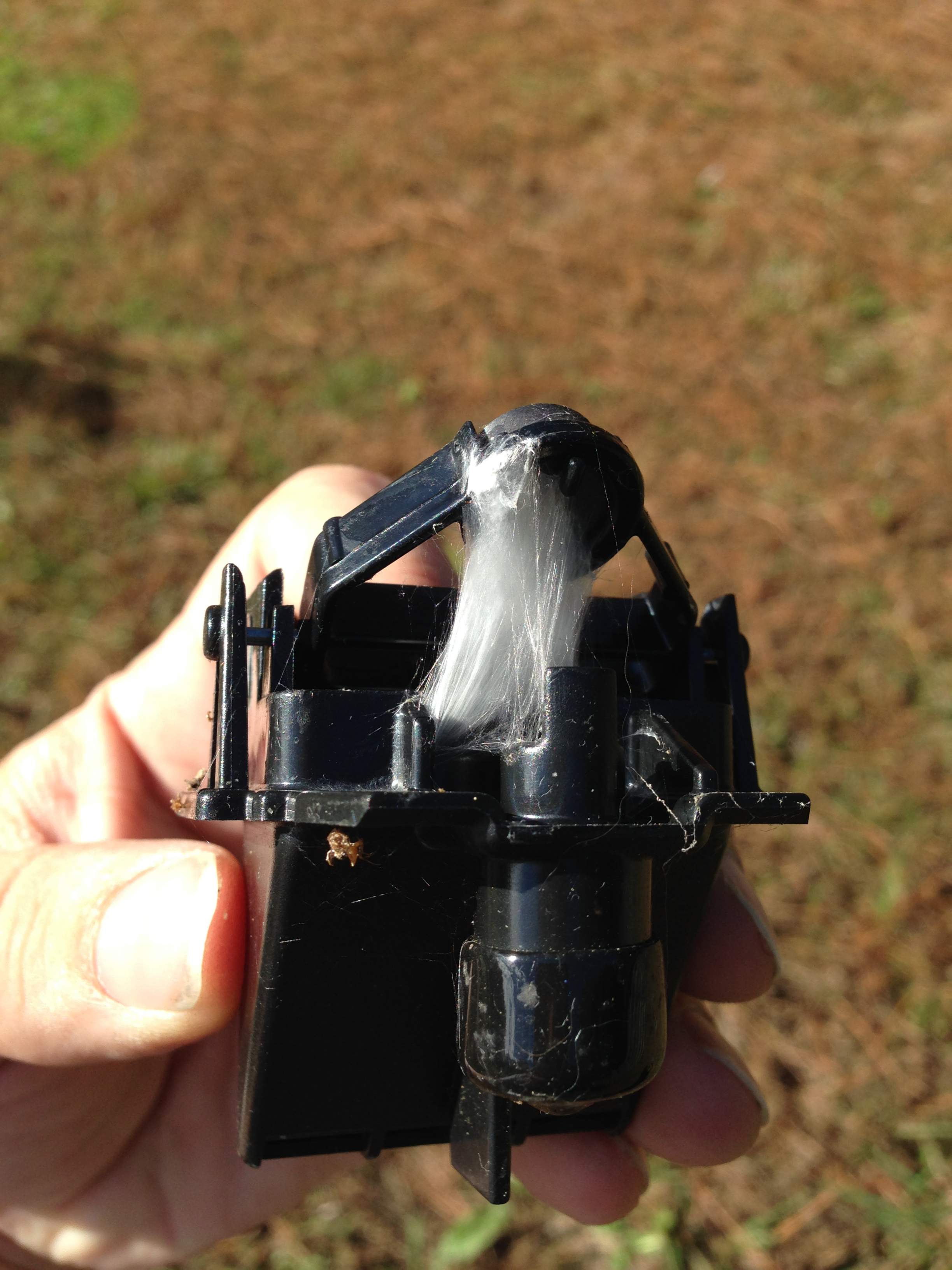

I've said many times on here that I don't think Davis is worth the price difference over AcuRite, but I will say that one nice feature of Davis is that the rain cup can be easily removed and cleaned. I've found on mine that's necessary 2-3 times a year, and maybe more often in the fall when the spiders start building webs on them. In the AcuRite units I've seen the the rain cup is internal and can't be accessed, so once a spider makes a nest in it, you're not going to be measuring rain any longer.
<edit> after googling it looks like you can clean out the AcuRite rain cup by taking the whole unit apart, so it is fixable. But on the Davis, the rain cup screws onto the bottom with thumbscrews and can be easily removed for cleaning without taking down the whole unit. So Davis is nicer in this respect, but is the convenience worth the extra cost?
Here is my rain cup after a particularly industrious spider got into it. The web was so strong it stopped tipping. I'm not sure how or if you could fix an AcuRite unit this happened to.
