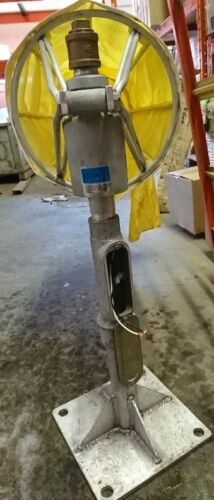

I think I might just buy a Wind Sock! Albeit, one with a light in it. It's probably more MY SPEED. I hope that high tech doesn't come back to bite me.
Transport Canada Approved. 1000 WATTS!!! Any possibility that is designed to melt snow and ice?
