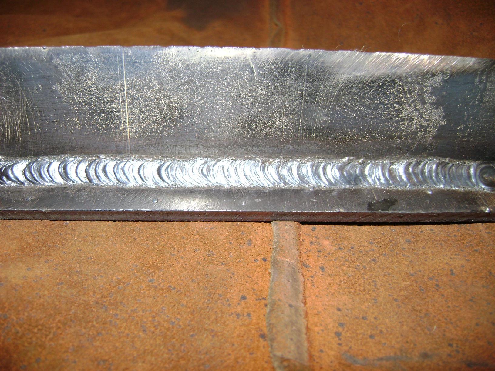

There was a discussion on another forum about the differences between AC and DC. I couldn't even remember the last time I ran a bead with SMAW on AC, so I went out to the shop and gave it a try. Right now I only have one machine hooked up in the shop that is capable of running AC.
I too bought a PowerArc 200 from Mark, I just love that little machine!
The first picture is a fillet weld I did on AC. I used Hobart's 1/8-inch 335A 6011. Soon as I struck an arc I was shocked at the sound, forgot all about the sound AC makes.:laughing:
The second picture is ESAB's 1/8-inch 10P-Plus 6010 on DC

Your AC weld looks excellent, you are an experianced welder. I guess the point is for inexperianced welder DC is easier, at least that's what everyone says, though for me it was not like night and day. That said I wont be going back to AC only any time soon.
Yeah that was the first thing I noticed about DC, alot quieter and smoother.
JB
/ looking for a stick welder... #10
And the 2nd thing I noticed, was less spatter, and less slag inclusions.
