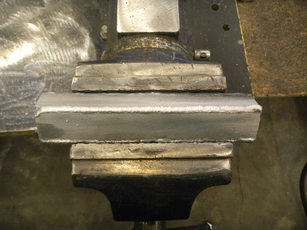

You're correct, aluminum just sucks up the AMPS!
What kind of budget are we working with?

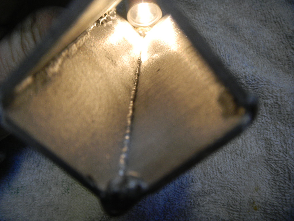

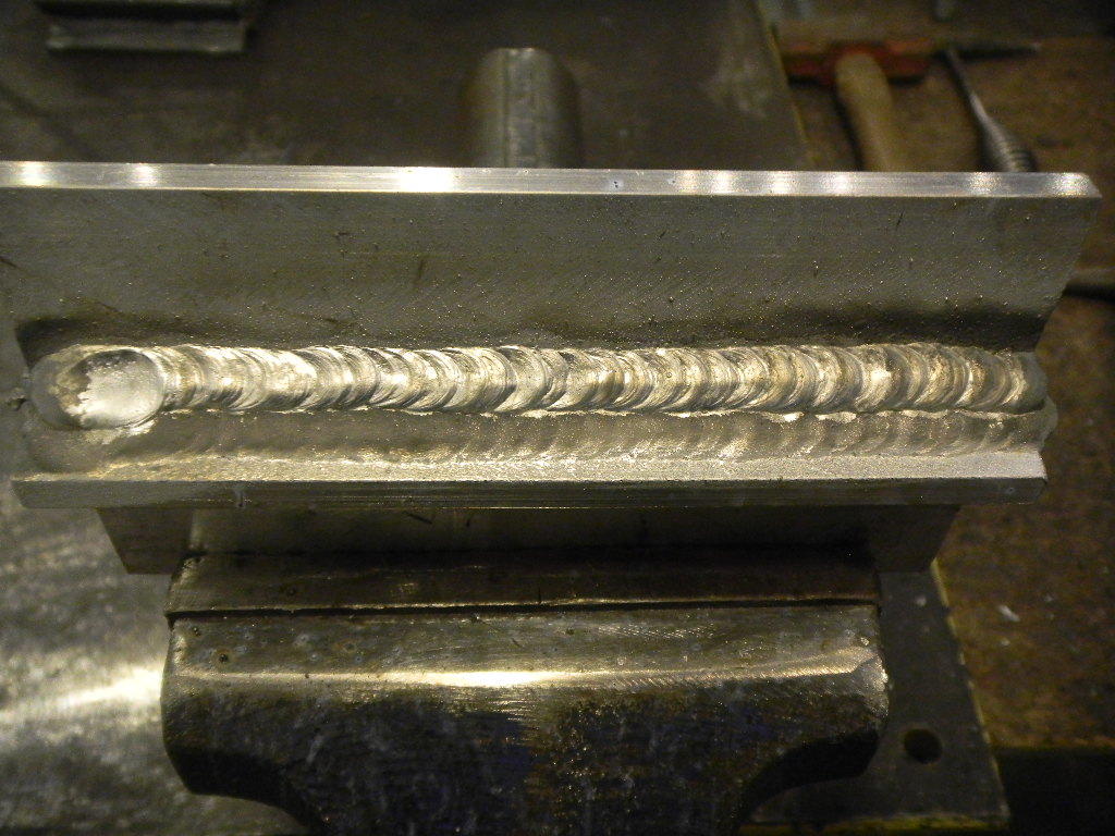

My V350-Pro with SG spool gun does pretty good on a wide range of thickness with aluminum. But she is spendy!

The thing is, Tig welding aluminum has a big learning curve!:eek: Any welding with a wire feeder is going to be so much easier to learn. Welding thin aluminum, Tig is the way to go!
With my Miller Dynasty 300, if it's a very small piece of aluminum, I can weld 3/8-inch thick. But if there is any volume to the piece it will not do it! That's why I bought the bottle of helium.

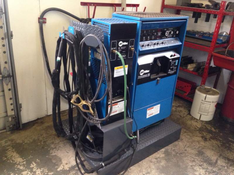

Furu, only you can decide what's best for you. Personally I would lean towards the mig with spool gun option but good used AC DC transformer tigs come up for sale when you least expect it.
I found a Miller 351 Syncrowave this summer for $850.
Here's a pic of it all 'cleaned up' and skidded.
Have fun shopping. :)
Terry
