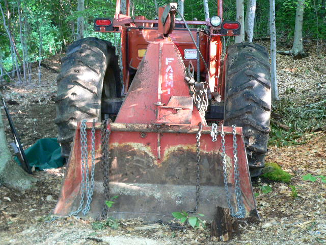

I also have a small Farmi. I like the fact that it pulls from the top. It really helps when the tractor is backed to a rut or ditch or on a bank to have that upward pull when the log gets in close.
You will not pull the tractor over if you have the upper link adjusted so that the force is directed at the rear axel or below ( which means use the lowest
hole on the tractor end of the upper link).
The Farmi unit will definately not dissapoint you.
My old Farmi 601 (600KG pull) has a movable snatch block that adjusts (and pins) up and down the center spine of the winch dozer blade. (you can see it in the picky just below the FARMI lable on the winch) This allows moving the "pull point" from the top pully to a position as low as a foot off the ground, depending on how deep the dozer blade is dug in.
It may well be that smaller farmi's don't have this feature but I was under the impression that even the 5,000 # model had it.

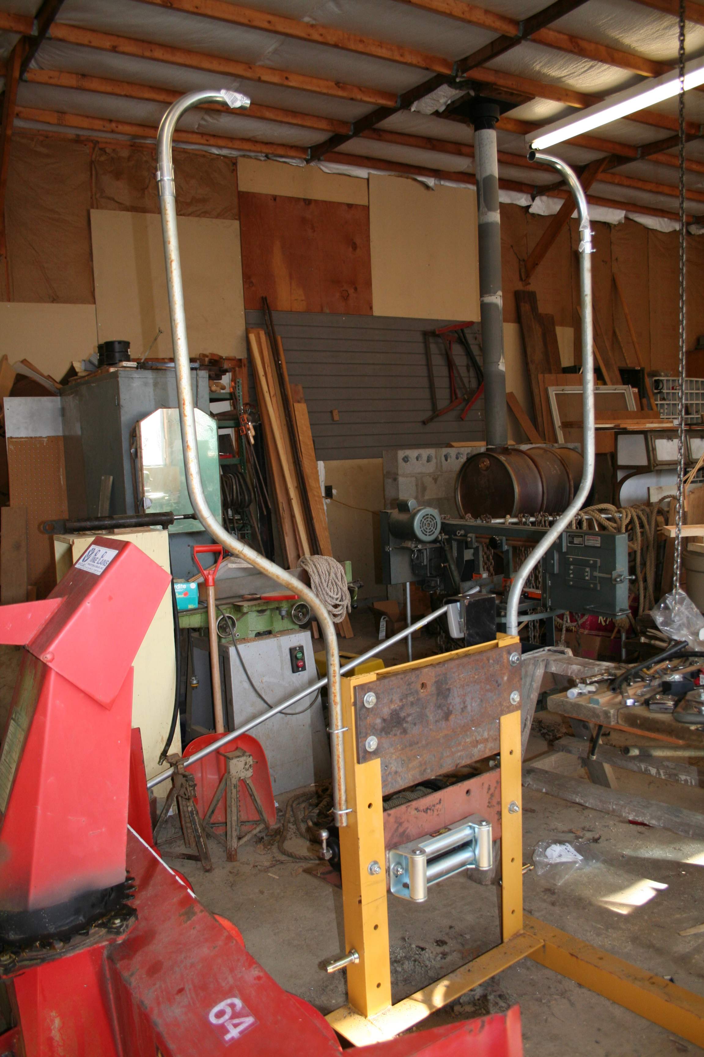

I had to wait for fittings , And of course one they had on backorder, then of course I needed some different ones. So I worked on the safety guard. 1" EMT tube. $6.00 for 10ft. I have a bender and could have done it all with one joint but the preformed 90d are a little easier to work with. I will gas weld the joints with a high temp fillet forming alloy , great stuff, used for racing car tube frames. The bracket that holds the gate receiver has a slot to hang the 2 button transmitter. I used a Prince 1500-3000 psi cross over relief valve just before the motor. You can see it with a flow control plumbed in. Two more fittings on that valve and I am ready to start hoses. I think I will have to have loops in the hoses 3/8 R1 , the spaces are too tight. The winch is off center by 1.5" I was trying to protect the winch motor from getting banged around , also was trying to tuck the winch in as close as possible to the frame. The winch shift handles stick out a little bit on the other side , I will attach a guard to the frame in front of it. The safety guard I will weld some kind of heavy fence wire to, I have some 1 x 2 12 g around.
There is a plate bolted high on the pull side. This is for a pull chain hook bar. It is too high I will have to lower it so the pull point is closer to the center line of the tractor axle. The plates are all 1/2 steel. I have a lot of it around and I used it for everything. I will have to take every thing apart to paint and I still have to add something on the bottom to dig in when pulling. I have two suitcase weights and will probably attach a point to hang them from. The real reason everything is going slowly is that while I was visiting some friends on a dairy farm up north a couple of weeks ago I slipped on a patch of ice and cracked 2 bones in my wrist when I went down. Healing well , brace on it all the time, Doc says don't use it for 4 more weeks. I think the DR and xrays will cost more that the parts for the logging winch. Bummer

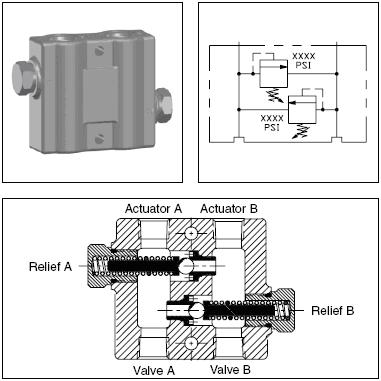

Look a the second picture . The black thing on the left is the cross over valve.
It has one fitting on top on the left. Just below that is an other valve with a round handle . That is a flow control valve. There is no check valve in it so it will restrict flow in both directions. I figured I would spool out some cable , put a drag weight on it and time the spool in. Adjust the flow valve to what ever the winch specs are. The cross over valve is factory set at 1500 psi. I have a gage 0-3000 that I will attach at some point to check the 1500 psi.
The aluminum square on the right side is the manifold mount for the Vickers Solenoid valve. Tape comes off and the valve bolts right onto the block. The idea is if solenoid coils have to be changed no oil is exposed. If the valve itself has to be rebuilt or swapped out no plumbing connections are disturbed.
I will attach some info on those parts.
