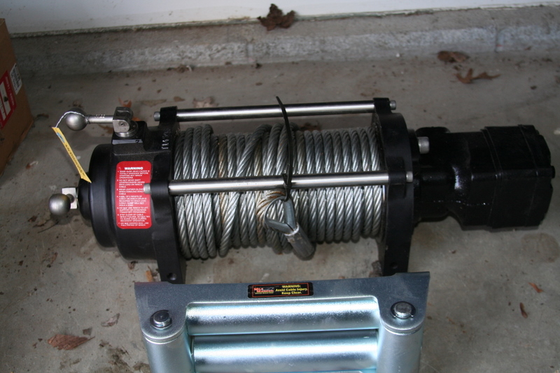

Just a few weeks ago I bought a #9000 Mile Marker that is about 10 years old and never has been installed or used. It looks a bit weathered having lived in an unheated shed all that time. I will try to start my own project sometime in the Summer. Your thread is very informative and most helpful.

The Mile Marker comes with 100 ft of 3/8 aircraft cable rated at 14,400 # working load I would think. I think it will take 150ft of 5/16 Amstel blue. 13,700# average working.
