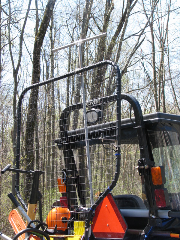

Still waiting for the flush cover but in the meantime got to wondering about the efficiency of the antenna that came with the wireless unit. I hooked it up to the back up alarm and with the monopole antenna mounted at what seemed appropriate . It worked solid at 20ft. it was intermittent out to 100 ft but that is all you need to trigger a normal gate or garage door unit. I need a solid signal. Now I am not an electrical engineer but I have been around them. I remembered 30 years ago we made some dipole antennas for fire radios. we just pulled the center a a piece of coax out . The center went one way and the shield went the other. Like a tee and the down leg is the rest of the coax.
The length of the leg is dependent on the frequency. In this case 300mhz the
dipole leg is .78 ft or 9.36 inches. Thats exactly what the monopole measured so I knew I was on the right track. I made one, see the picture, and the signal was solid to 60ft. You can see both in the picture. Maybe the dipole works better because it is higher and not in front of the shield but I think it's more than that.

How much do atmospheric conditions affect the signal? I know that in humid weather my car remote doesn't have as good a range as in cold dry weather.
If nothing else, you should be able to get decent TV reception ;)
Chilly

Flush block cover came . Flushed the system and put the Vickers valve on. Hooked up the winch motor. Closed down the needle valve. Had it wide open for flushing. Maybe 20% open. Temporarily wired up the electricals till I am sure it works. Magic Wireless . first button spool in, second button spool out. A lot of speed control with the needle valve. The two speed gearing on the winch is obvious. Of course I ripped off the dipole antenna 30 seconds after I was in the woods. I think I will stay with the monopole and raise it up. It has some give so it should not get broken off. I spoke with a friend of mine who knows all this stuff and he said an antenna on the transmitter would help a lot. But it looks like a garage door opener and it would be kind of difficult to stick an antenna on it. Next is to winch something maybe a log.

Found out the wireless signal does not go through my body. I moved the monopole antenna up to the top off the shield, work solid out to 30 ft. I am going to try the dipole one more time with a wound spring connector to mechanically connect the vertical pvc pipe one piece to another. The theory being it can spring around.

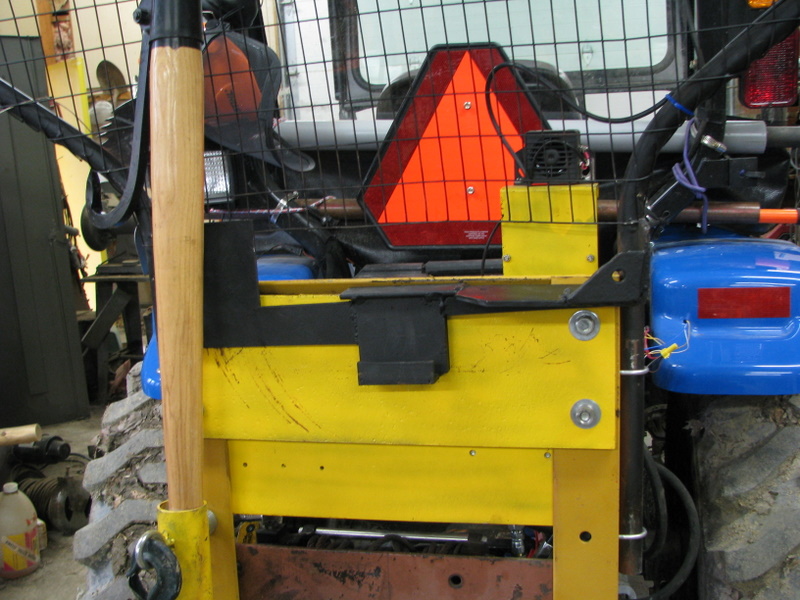

I can't resist, I am attached a What is it picture.
Hint it is part of the 3 pt attachment . Answer tomorrow.
   / logging winch

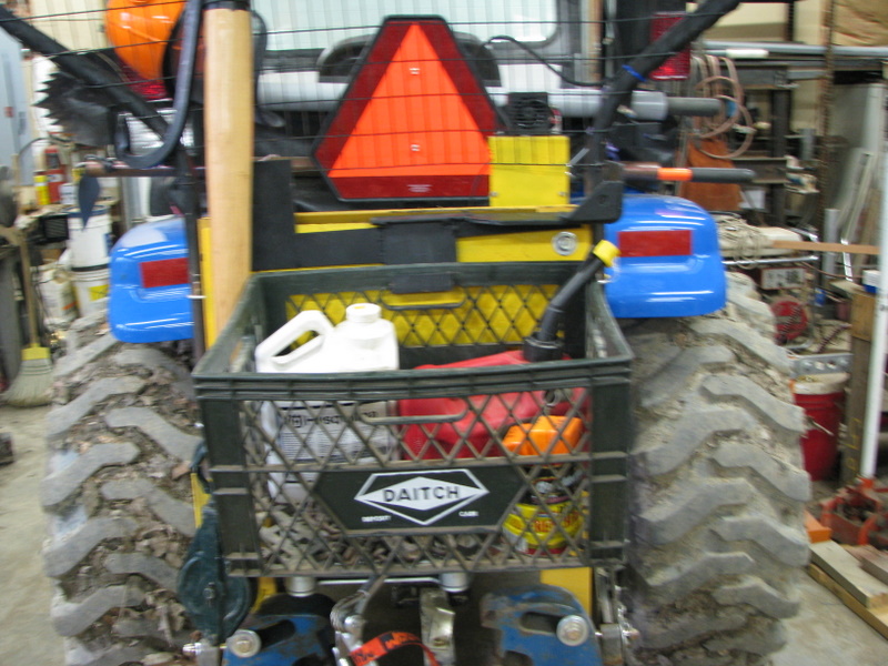

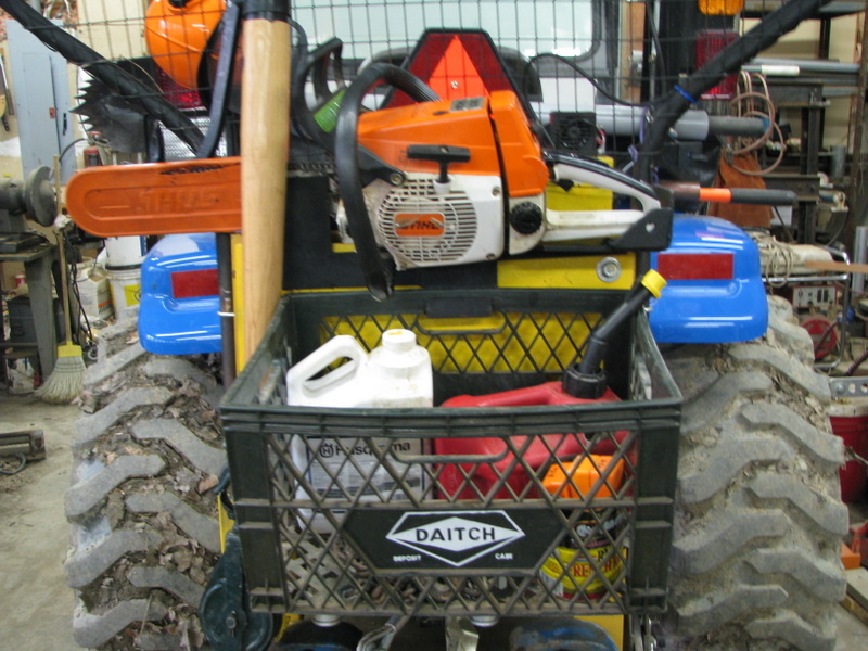

#67
Ok Here is the answer. I hesitate to weld every thing together the first time on a new build. Depends what it is. I welded the dead man on but all the plates things mounted on I bolted on. I was always thinking about the chain saw and gas/ oil etc. As I got to the end I started looking at how to bring that stuff along. Did not want to tie anything down. I was going to weld something to the top plate but then saw the slot. The milk crate has a chain in it which is still too heavy so I will add a pipe container somewhere for the chain. Yes I could put all that stuff in the bucket but for forgetting it was there and then , you know, dumping. Also I have been leaving the forks on the front and taking out 7ft logs that way. I will probably add a slot for a chain drag , would be handy for short pulls. I also have a couple of those blue plastic 50gal drums.
