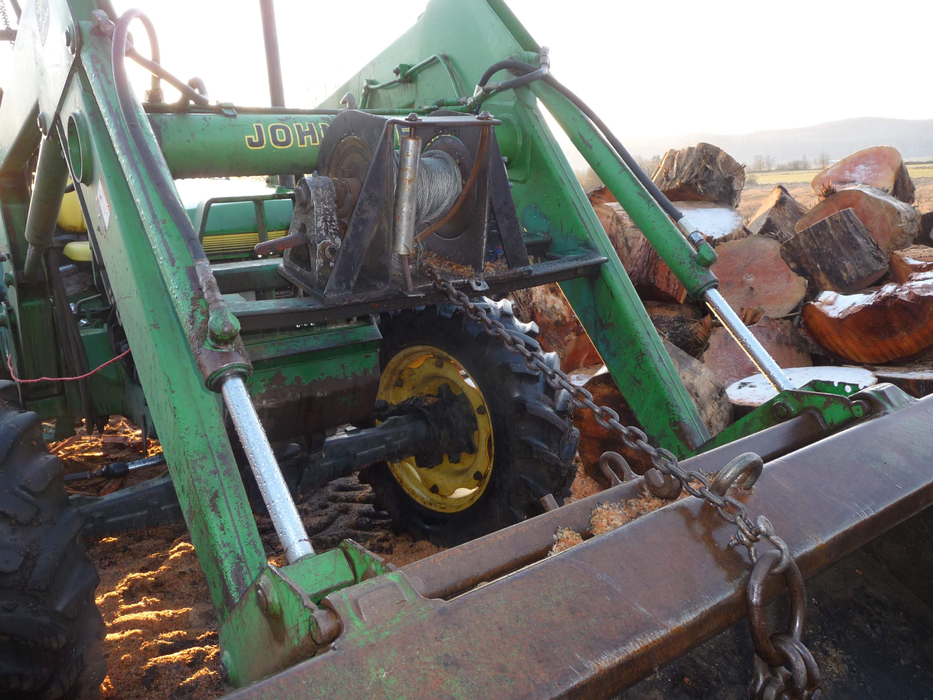

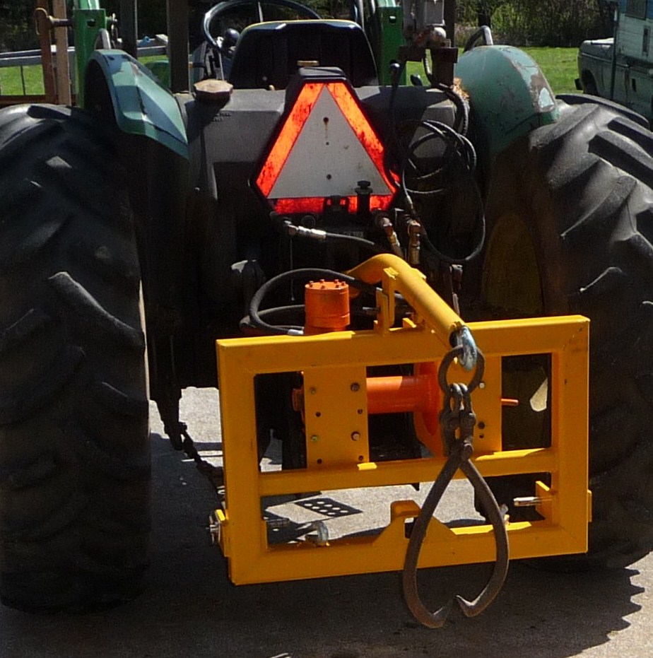

I have built 3pt winches in the past using koenig units. Another company took them over and I have tried to contact them without results. I come across a couple of hyd units and picked them up. When I was in production, I used pto units.
Here is a pic of my installation up front and the one for the rear, both being hyd. The rear unit I just put together this last fall. I have it on most of the time as it is handy with the hitch system built in. I generally leave the upper arm on, but can use the normal toplink if needed.
As you can see the front winch is well used. I took the rollers off the front and use a small pulley if I have to pull sideways on the eye on the bucket. Only had to do that once as I was stuck against a fence and had to be pulled sideways. Other than that, it is an easy matter to turn a bit this way and that to spool the cable in evenly.
What is so nice about having the winch up front in my apps, is that when cleaning up brush and such, taking the cable and lying it on the ground, throwing the limbs, brush, whatever onto it, hooking, and winching it into a bundle to be packed or loaded. Stuff that you cannot keep in the bucket. I picked up a grapple bucket from a bobcat that I am converting to a quick release like my bucket and the hoses for the winch will quick disconnect to run the grapple. In the meantime, the winch works great for all around needs.

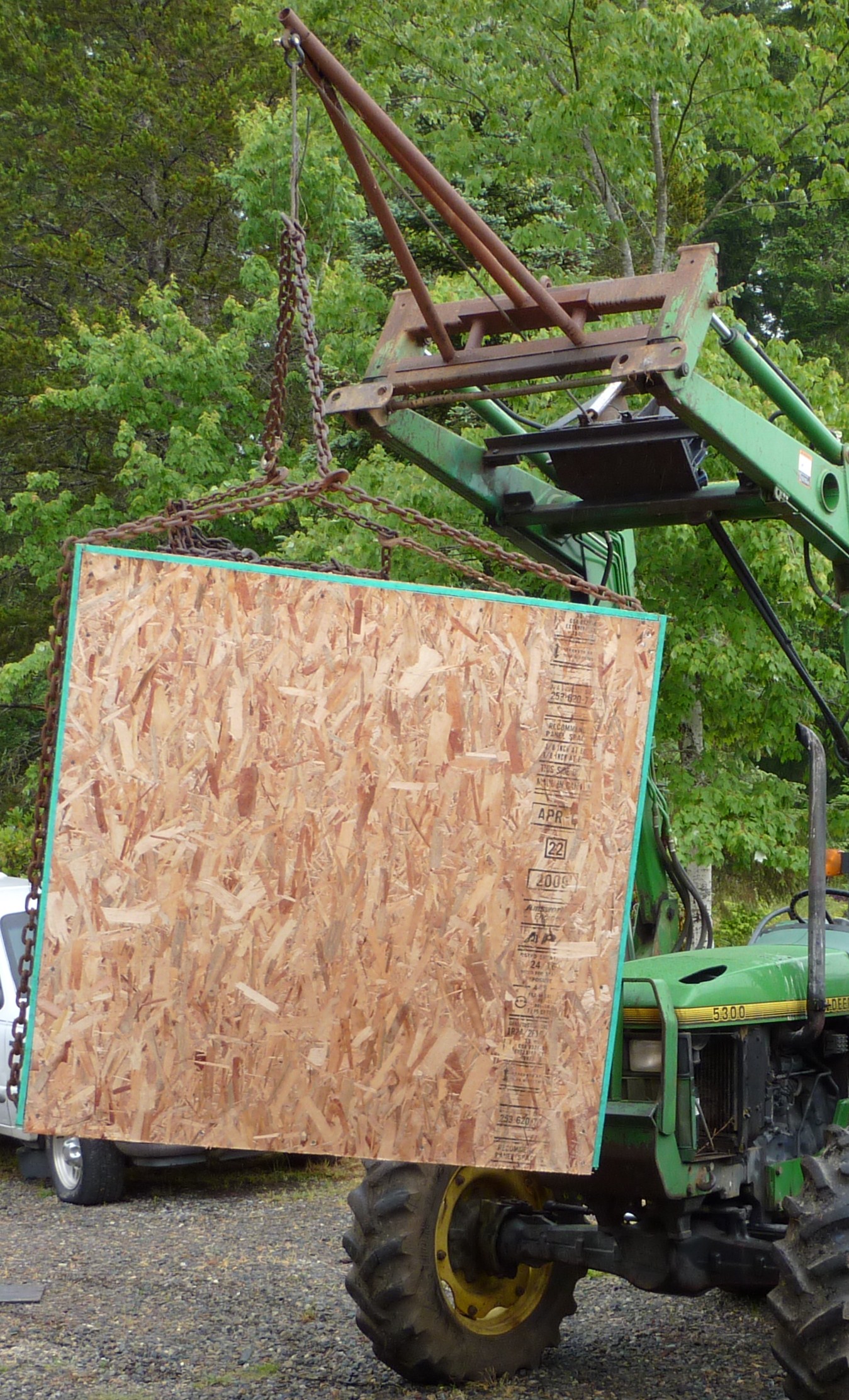

Normally when picking to load I use a tripod on the loader with the bucket off.
Was in a hurry to load this and wasn't spooling so didn't put the block on the shackle. this weighs 1250

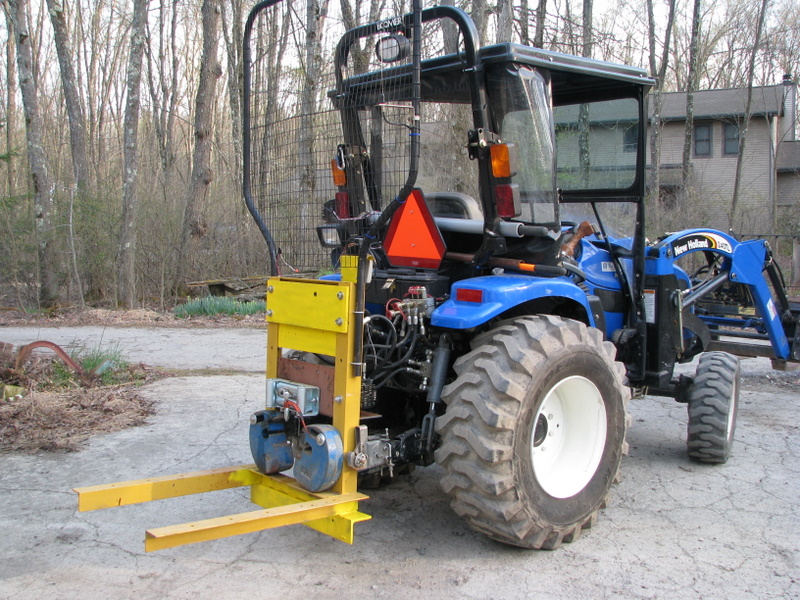

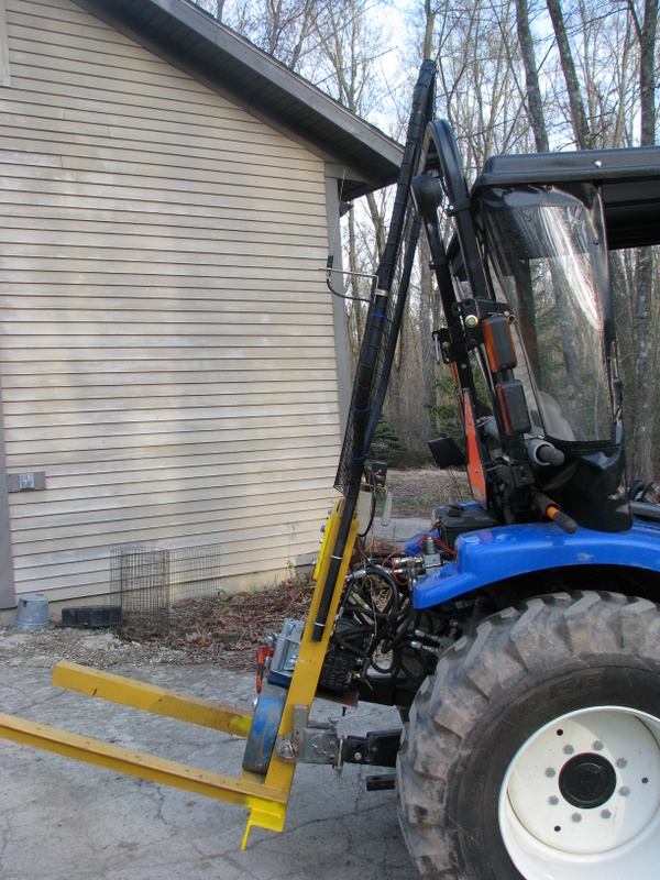

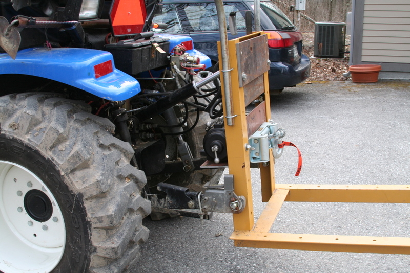

#60

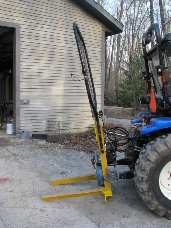

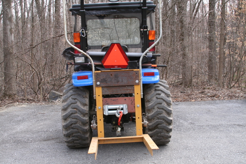

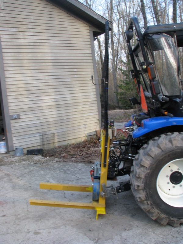

I am almost finished with construction. Now I know why the commercial units bend then the shield back at the top. I thought it had something to do with deflecting flying objects . I started to do the bends but it was looking not so good so I abandoned it. As it turns out if the 3 point is up and the top link retracted ( assuming one has a hydraulic top link) then there is interference between the safety shield and the Rops. The solution would be to bend the shield. I think I could still do that. Or cut off the Rops, right. Or be careful . or put a sleeve stop on the top link. Or put the fixed top link back on , right.
I think I will leave it for a while and see if I can be careful.
The last thing I was going to do was cut off the carry all carrier legs but then I thought , what a good way to carry 7' logs out instead of dragging them all the way out. So head out with forks on front and carry all sort of forks on the back, winch out the logs, cut into 7' lengths , roll onto the forks and take it away. I can see I need some sort of spring loaded keepers at the end of the arms to keep the first row of logs in place.
All I have left to do is attach a tool box for chain saw etc and wire up the valve. I am going to get a cover plate for the D03 manifold so I can flush the system with out the valve in place. Also take the winch motor out of the circuit when flushing. I will just connect the pump lines with a fitting.
I probably have 100 hours in this thing. Oh yeah I am not fussy about paint colors, I want it not to rust so it's Rustoleum primer and some color that was close to the carry all, but after that it's what ever is around.
