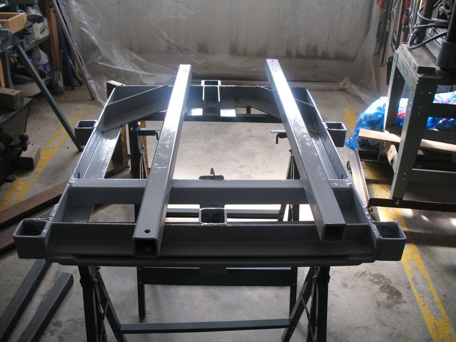

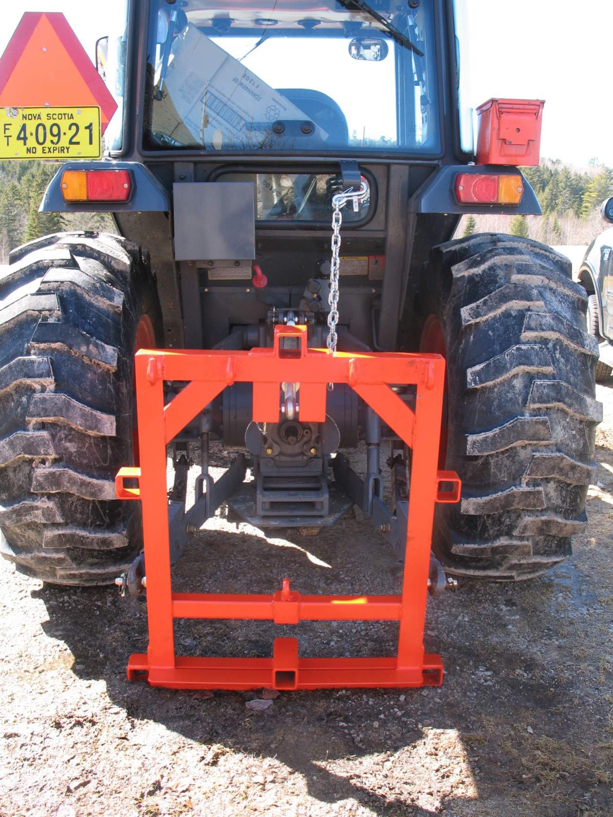

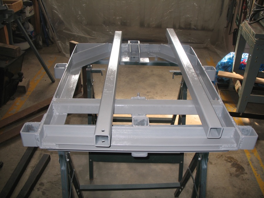

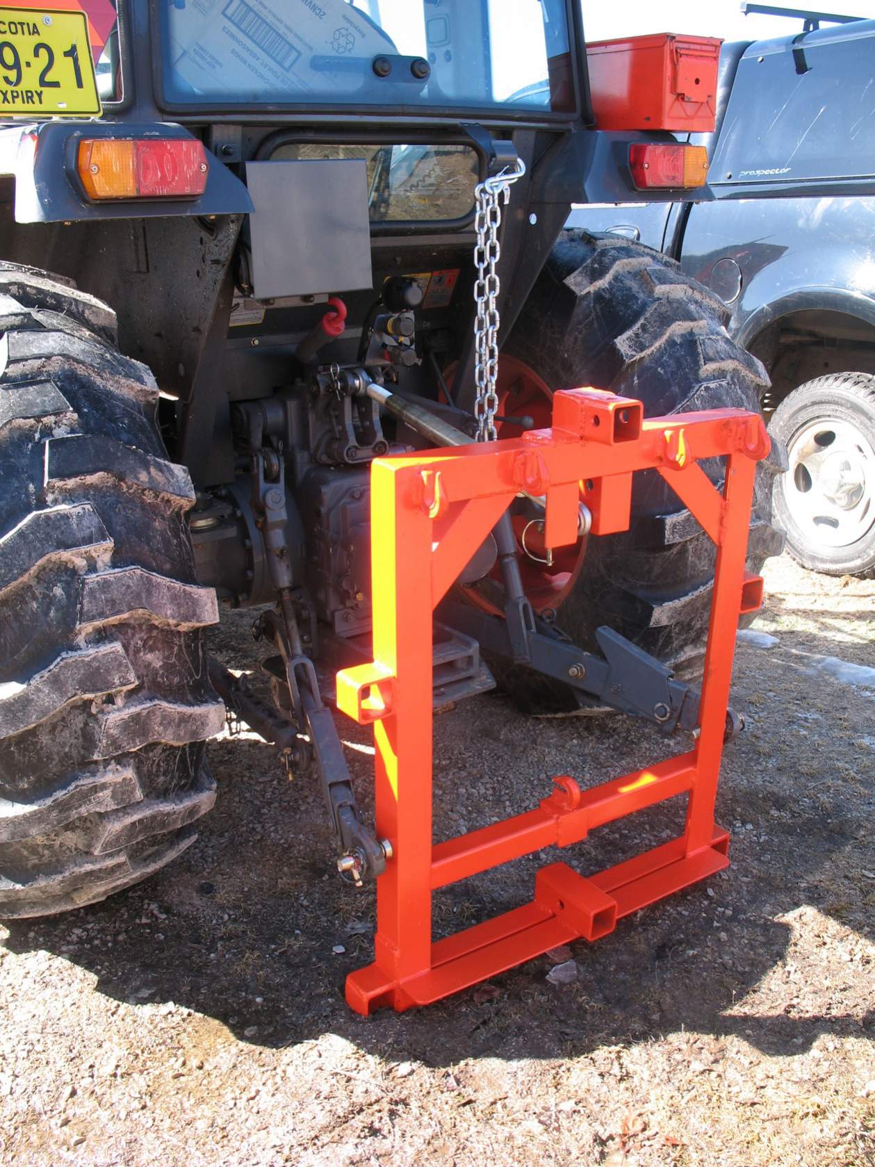

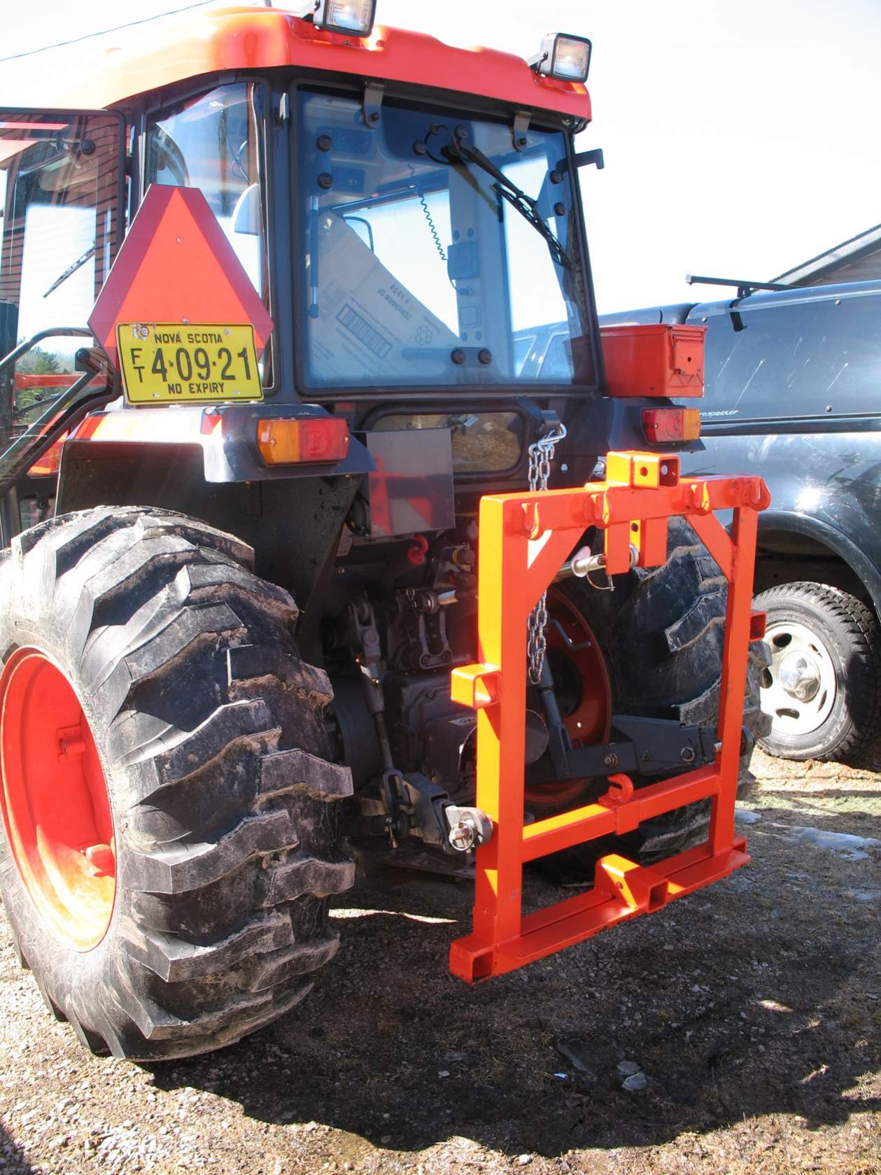

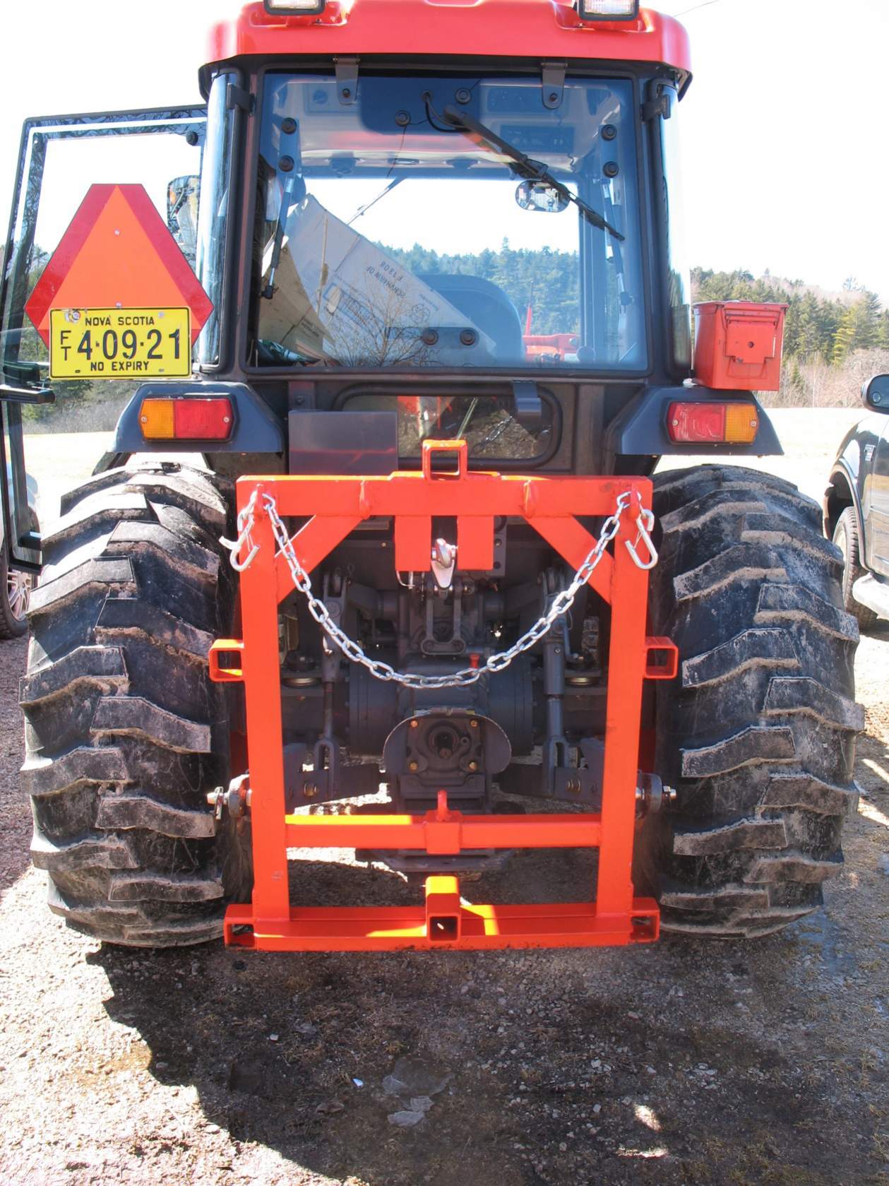

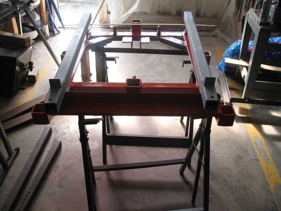

Finally finished...
The forks are still drying but at least the frame is complete.
A few photos of final build plus install.
lloyd
PS: worked on loader hooks & receiver ports today - will post images later.

Lloyd,
You really did a great job on yours also!_- Looking forward to the rest.
I like how you put a extra hitch on top._...What was the extra 4 boxes on the side for.?
Can you tell me the measurement from the top to bottom??
Thanks for the pics.~ This has been a good thread:D
/ Logging Hitch #96
jd4300,
I will take measurements and post. The 4 boxes are to hold things on receiver 2' hitch pipe.
I have a number of hitch balls with different rises plus a pintle hitch. I figure it is a good place to store them. Plus I can drop in the forks (in the top two ports)and it makes a good bench height with some plywood or 2x. I am trying to cover as many bases as possible. If you look back a few threads you will see a drawing with measurements - I didn't deviate much from the drawing. The bottom two ports will hold forks.
I was going to mount a carry all to 2" receiver pipe for the bottom ports. But since I made the forks I figure I will get a decent pallet and use that as a base to build the carry all on.
This was a fun project and my welds got better as I worked along. I think we really should thank TEACH for the design and inspiration....!!!!!!!

jd4300,
36" Height
28.75 (28 3/4") width probably 29" if you count the chamfer on the pins.
Hope this helps.
lloyd

Lloyd,
Very well done! I am quite impressed. I hope you are happy with the way it works, let us know how you make out.
Also, I don't know what you use for chains, I found that skidding chains 6' in length were perfect. I also keep one 10' chain handy just in case. Finally, the actual logging/skidding chain hooks, verses just the typical more open, rounded hooks, are well worth the extra money. I picked up a few of the actual logging hooks, but I can't remember what they are called. Mine came painted red, and use a roll type pin that you set with a puch as apposed to the traditional style of pin to attach the hood to the last chain link. They are so nice because they don't slip off the chain if you happen to get some slack in the chain, thus saving you from having to jump on and off the tractor.
Happy logging!
