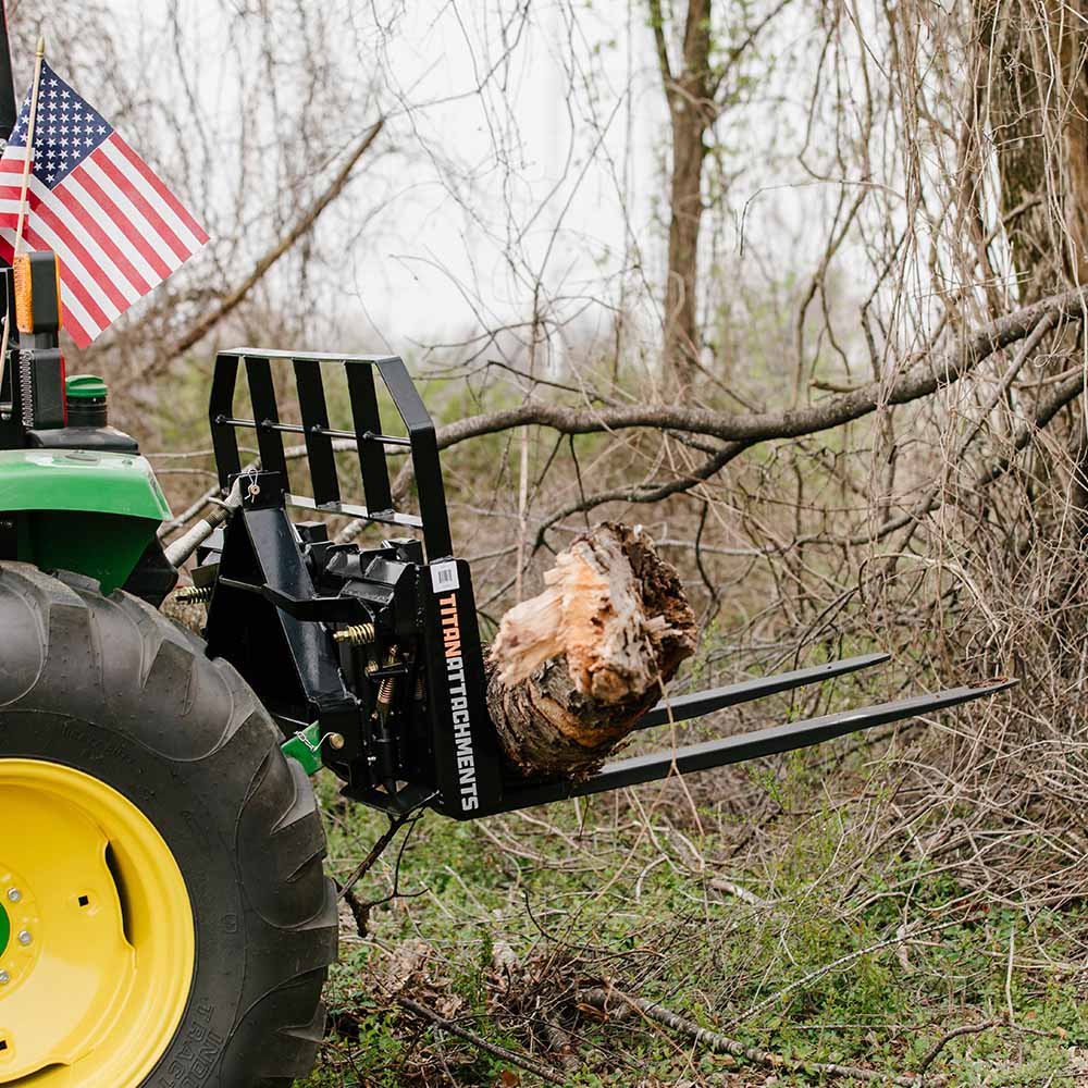

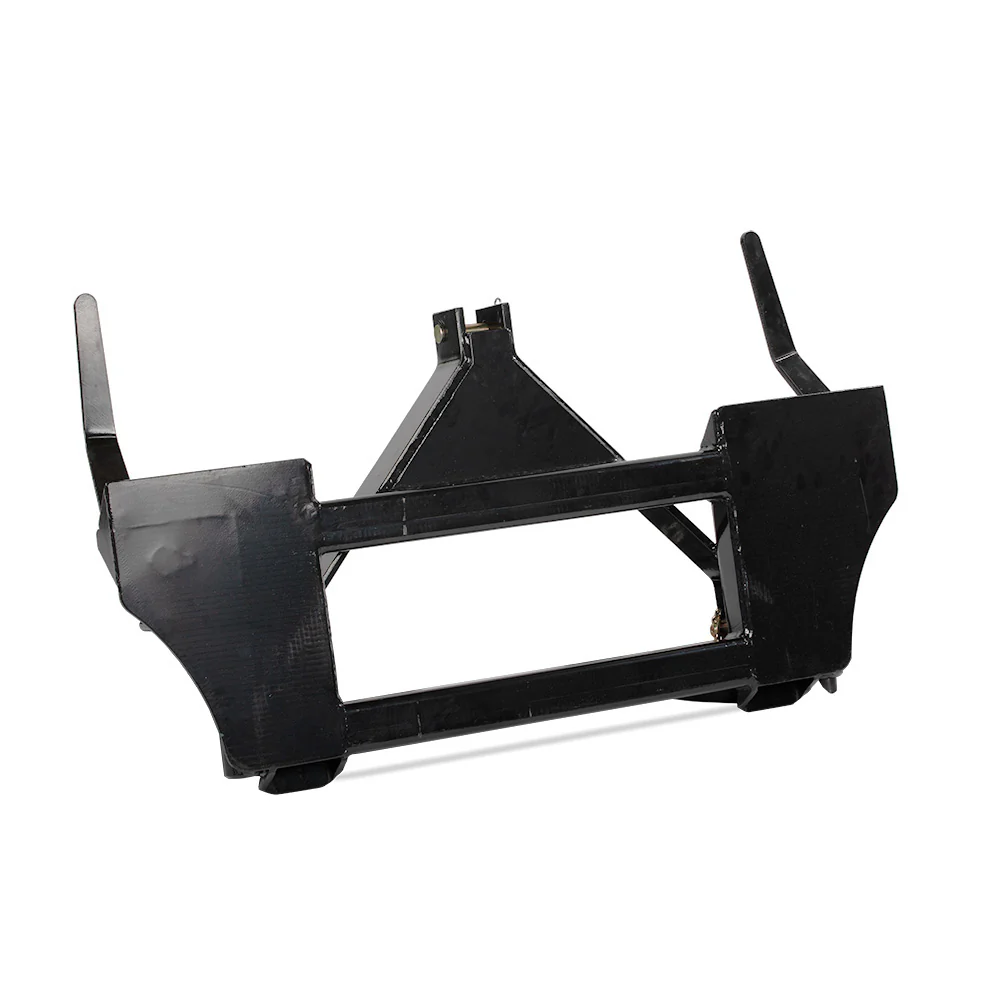

Instead of spending the money on a carryall, I bought this 3pt to SSQA adapter and use my forks with a pallet as a carryall. I have a deck box bolted to a pallet that I use to carry tools, chain saw, etc. It also keeps the FEL bucket free to carry the coal bags
The forks are rated at 4000#, much more than the 3pt will lift, so no worries about breaking anything.

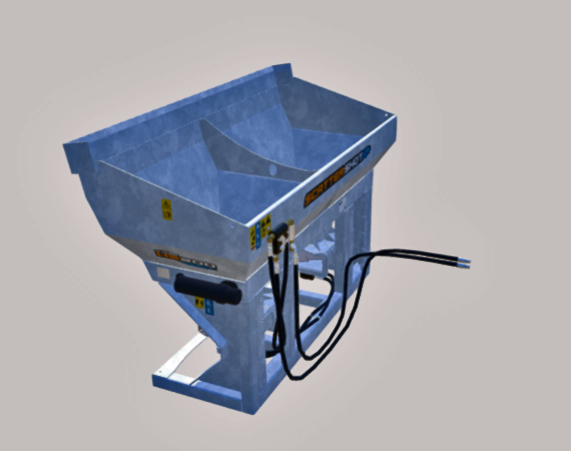

I also burn coal and spread the ash with an SSQA 3pt spreader. When the road gets slick, I drop the forks and pick up the spreader:
When not on the tractor, the spreader sits by the back door and I just dump the ash pan from the stove into it.

Mr. BDHSFZ6, since you've had good luck with your set up, do you recall where you purchased the 3pt to SSQA, and was it a specific brand?
   / Suggestions on customize a carry all please. #14
I bought mine from Titan per my link above. There is no label, so I'm not sure who makes it. It's pretty rugged though and I haven't managed to bust it yet.
Not cheap now, the price has gone up 40% since I bought it 5 years ago. There are cheaper adapters out there but I'm a bit concerned about strength.
