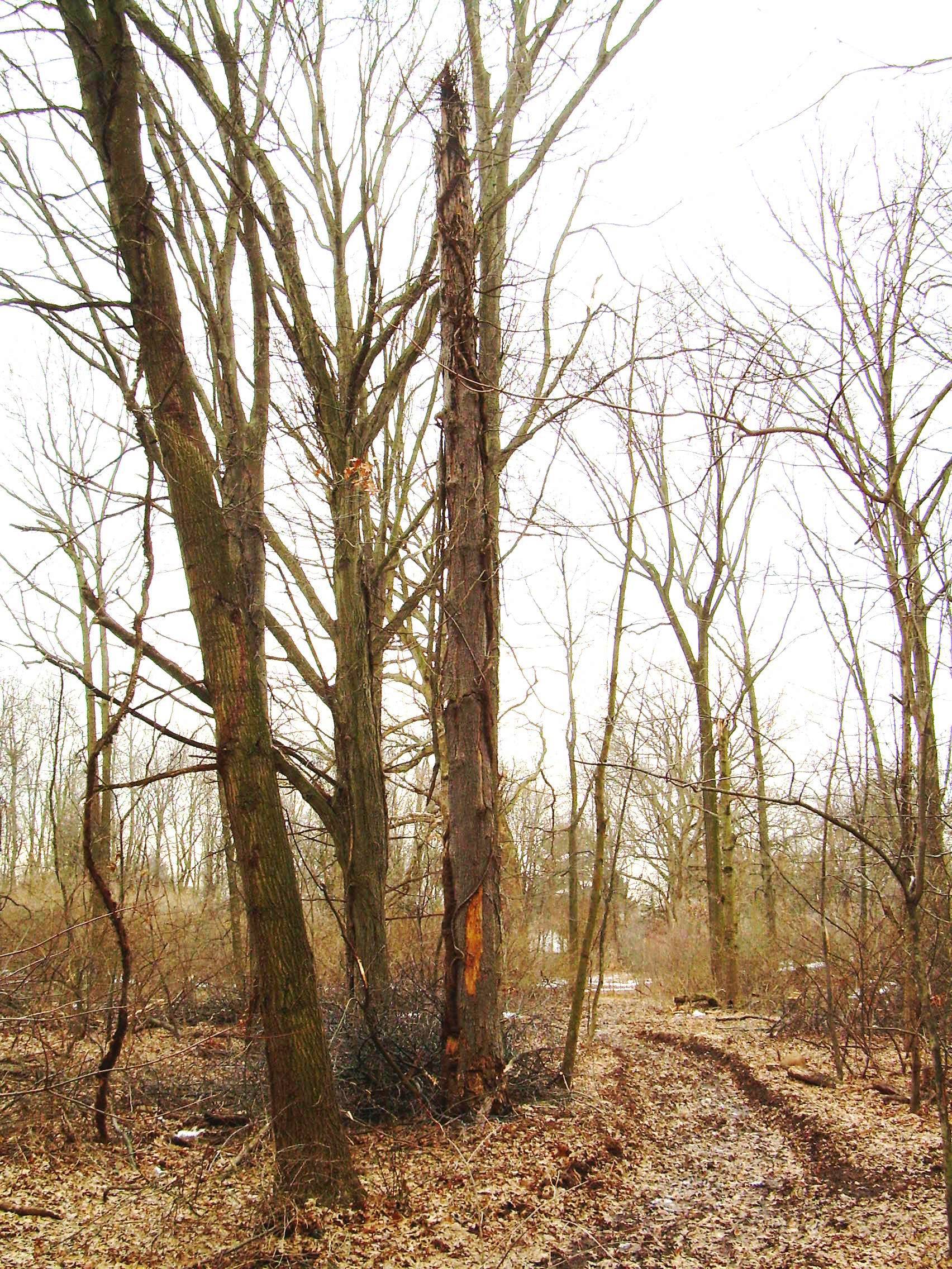

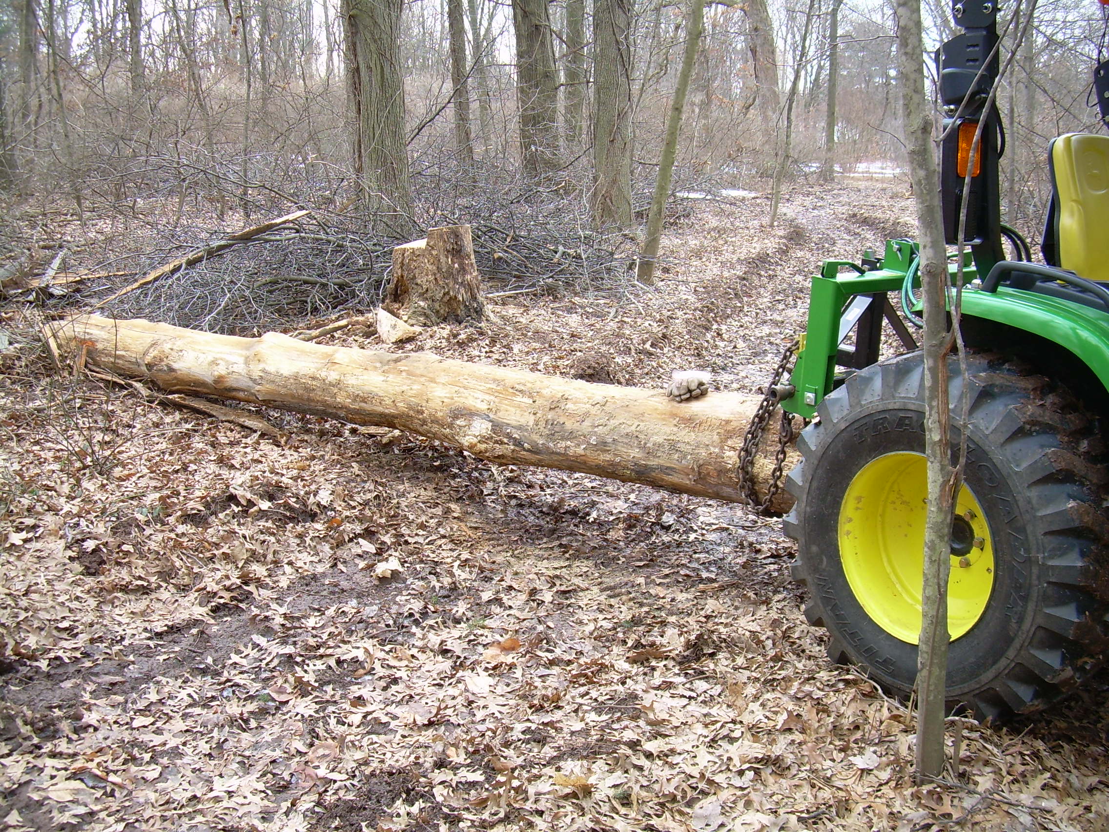

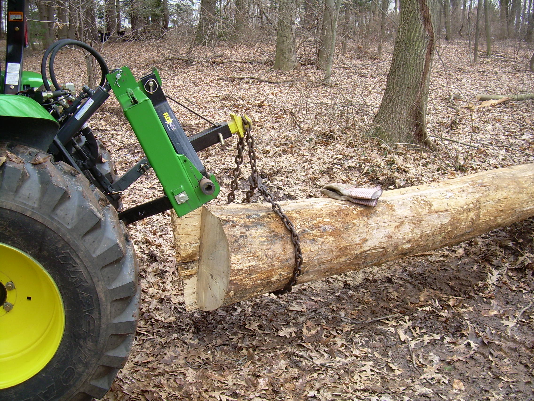

I cut down a standing dead tree (branch-less pole) the other day. 20+ " dia Hickory, by the look of it, it's been standing dead for 10-15 years, looked like it was getting ready to fall by itself so I was worried about the kids who play back there, and thought I may get some dry wood out of the deal.
Sure enough I got a 16' log of nice debarked dry, ready to burn hickory, which I've found to be the best wood to burn in a fireplace.
Pulled it out with my 3 PT Flexpoint receiver adaptor and homemade weld on hook insert.. I'm gonna mod this adaptor to install trailer chain loops and a limiter chain to attach to horizontal draw bar, I may add a couple more weld on hooks like OP did just to hold chain slack, as I see that's a useful idea.

Is that a cylinder jack that you have on your 3-point hitch.?

It's just a typical hydraulic top link I just put on last week

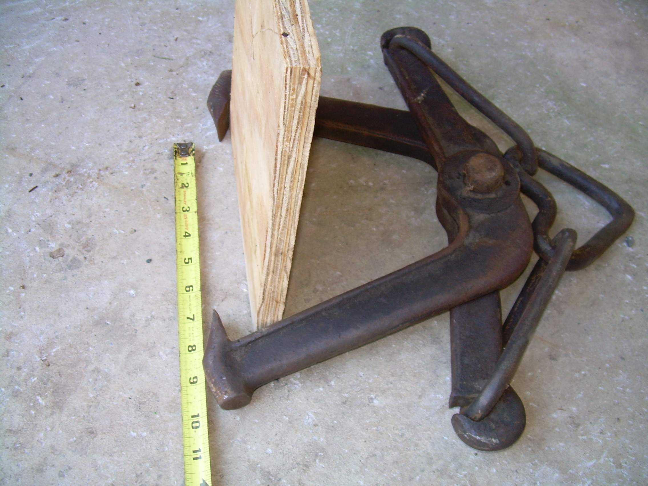

I saw your grapple J_J, looks nice I was wondering what the cable was for, how wide do the jaws open?

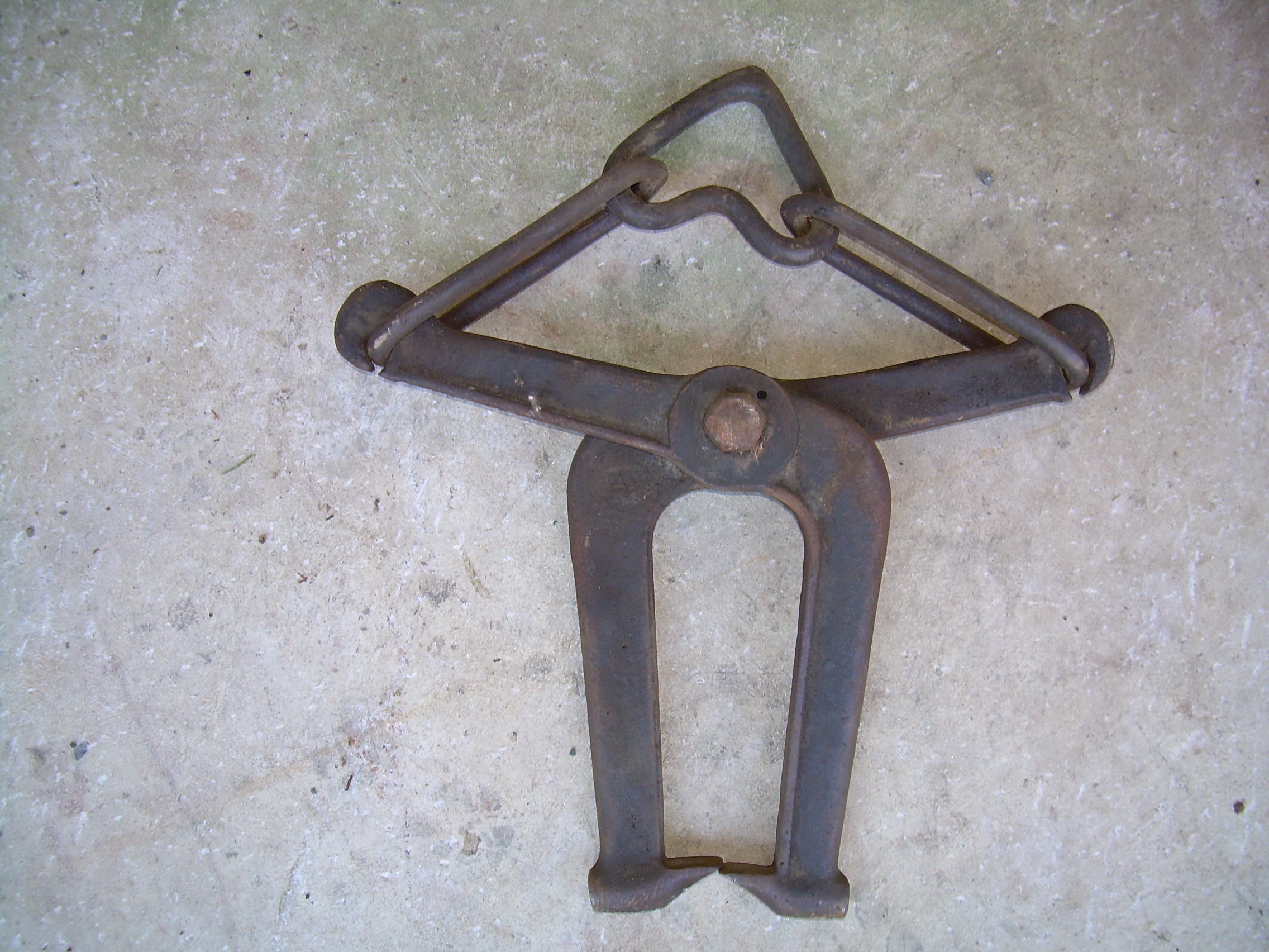

I just found this mini grapple in a garage, thought it might work for logging but it only opens 7-8 inches, anyone know what it's for?
JB

That looks like a logging grapple or wood post puller, or a pallet puller.
Here is the data on the HoggDavis tongs.
MODEL 30
10,000 lb capacity, 16-3/4 opening, Approx. weight 30 lbs, made of Hi-tensile steel rated at 67,000 psi, 1 full floating pins w/welded heads, 3 flame tempered 1-1/4 teeth in each jaw, Machined Nylatronï½® pulleys.

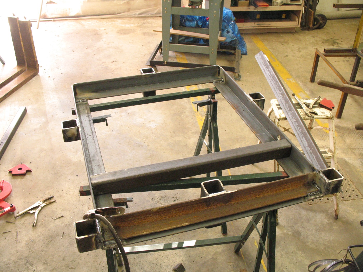

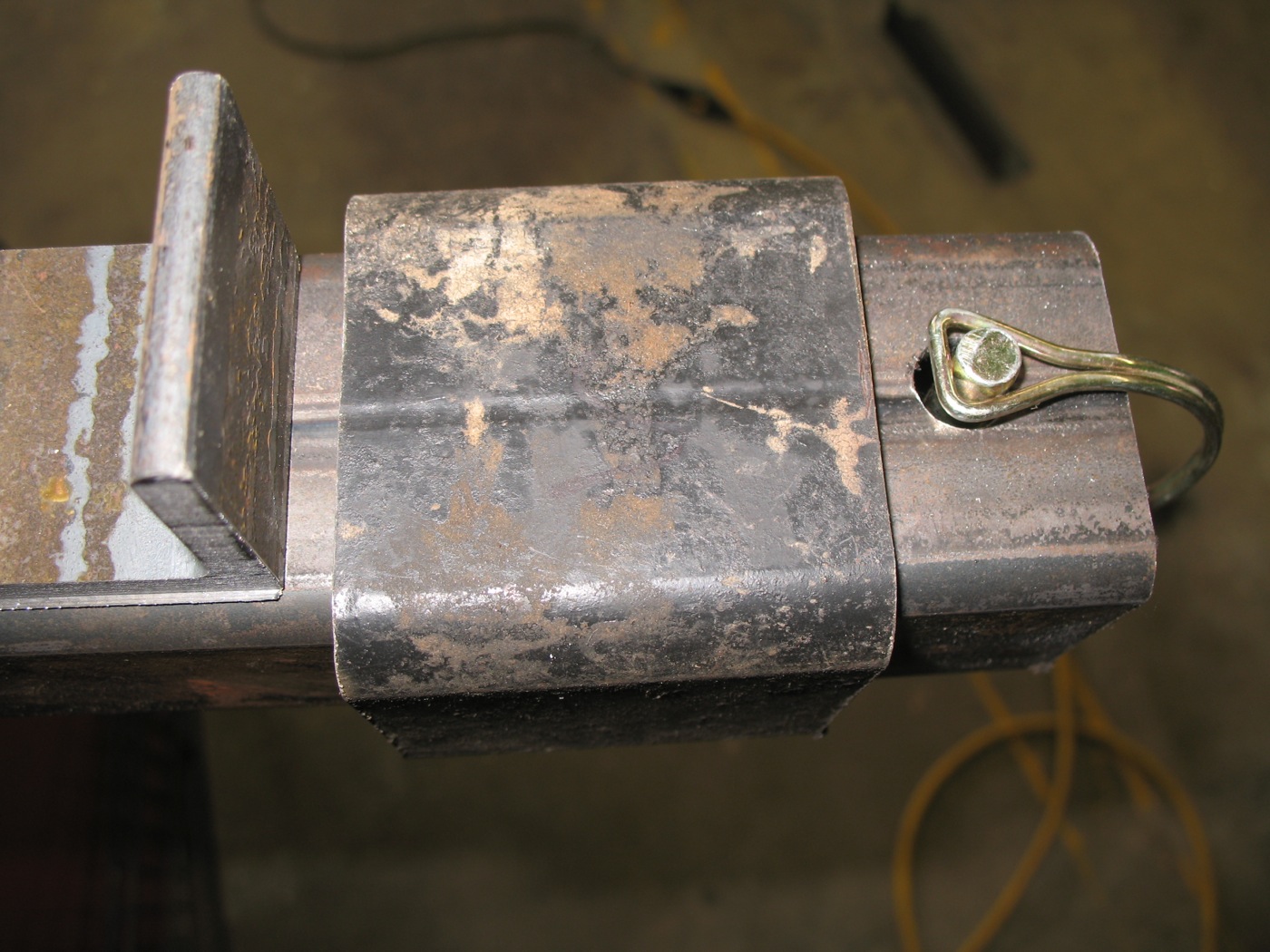

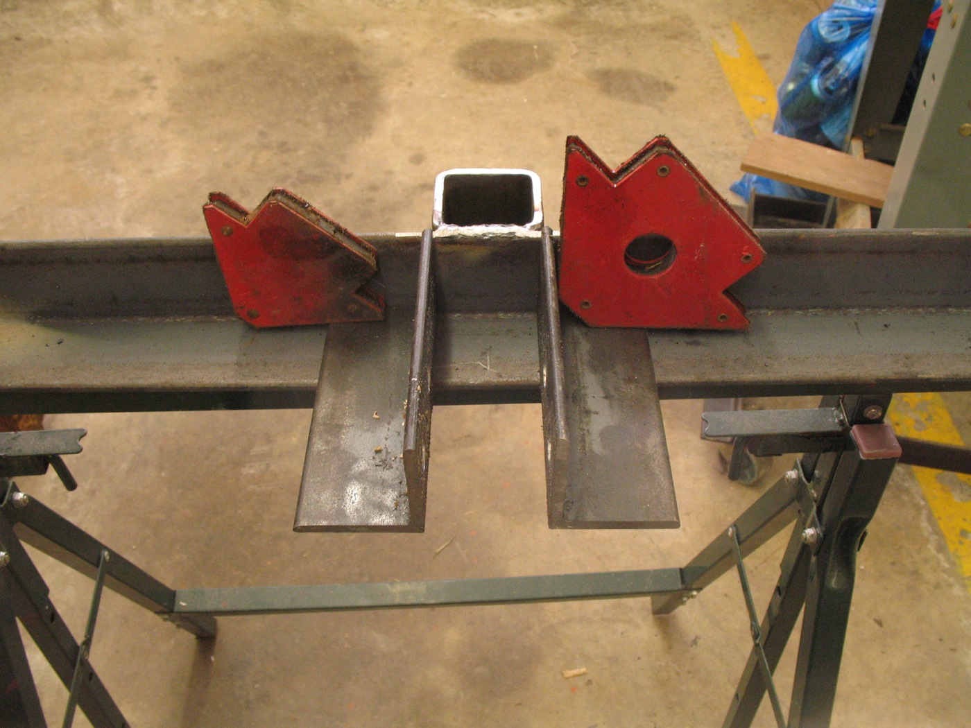

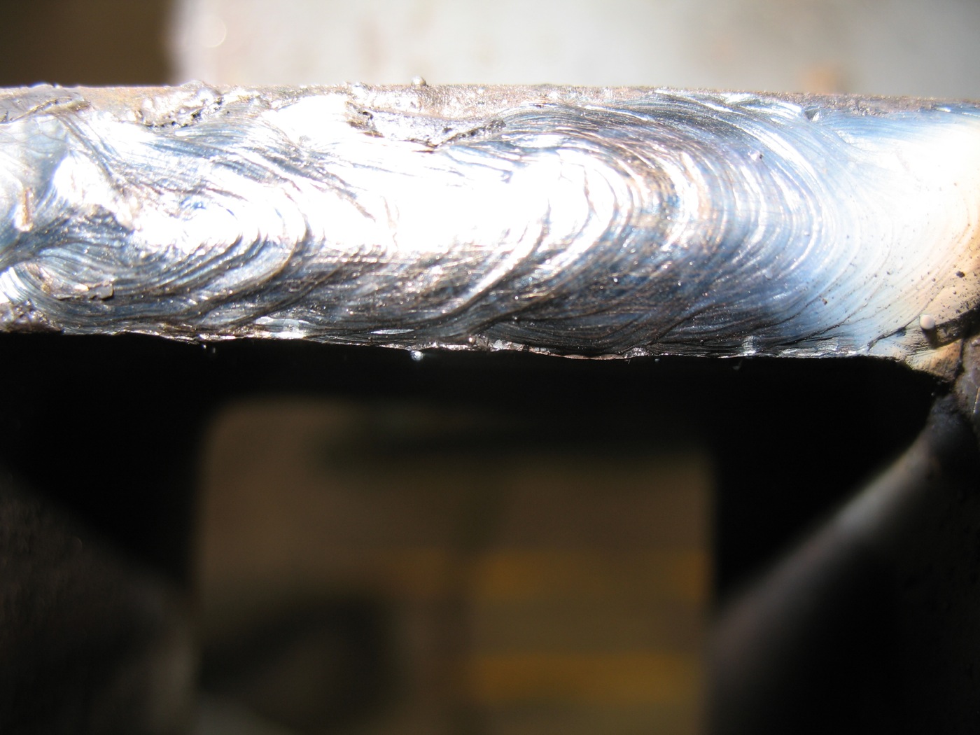

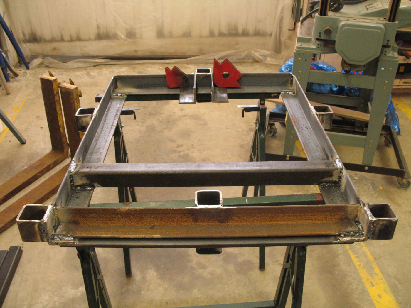

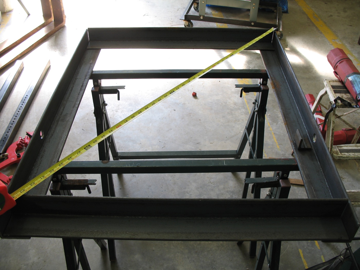

Managed to do a bit of work last night - late into the evening.
I tacked everything together, checked forks in 2" rec. ports - off by 1/8" - than I put a level on the concrete floor - not level. Works for me.
The detail of the fork shows a stop and a pin for holding in position. I need to do another set
which will be used as a base for a carry-all.
I still have to cut 45 degree supports and weld, weld top link connector in place(I drilled two holes for positioning) add a few more 2" rec. ports, weld on hooks and add a few re-enforcing plates and do final clean prep for painting.
I am pleased with the progress so far - but when you have a great design to begin with it is easy. Thanks teach....
lloyd
PS: I try to put photos in order but for some reason they do not appear as I select them - why?
