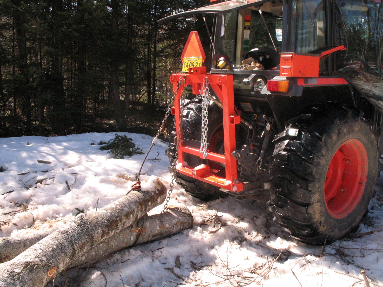

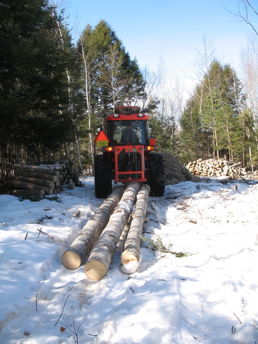

Spent the last two days chipping and logging for a friend. He's in the pictures - I am not.
I drove the tractor there - half hour drive. Did it early in the morning to avoid traffic.
Image 2 is the third pile. Forgot to take before and after of the first 2 piles. Image 3 is the after. Image 5 is on to the next piles. Image 6 is a closer look.
Image 8 is using the log hauler for the first time - welds held!!! Image 10 - another view.
We used the chain more so than the wire choker. The length of the choker didn't allow it to be hooked on the upper clevis hooks. Some times I used a short length of chain to get it connected. We found in the end chain worked better and allowed us to lift the logs. The ground was fairly level - so even dragging on the ground worked. We ran two 7 hour days at 2300 rpm and used 20 litres of fuel - not bad.

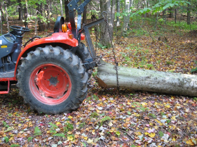

lloyd
Lloyd,
With the hooks on top...How high could you lift a log off the ground??
Bill

jd,
With the chain the hitch will lift the logs off the ground as much as your 3pt will travel vertically - different for each tractor I would assume - less the slack in the chain. About 12 to 18 inches I guess. We tried to align the butts of the logs, than I would back up with the hitch and lower to rest on the ground and hook up. Some times I lifted the logs and set them down again to gain more scope on the chain.
