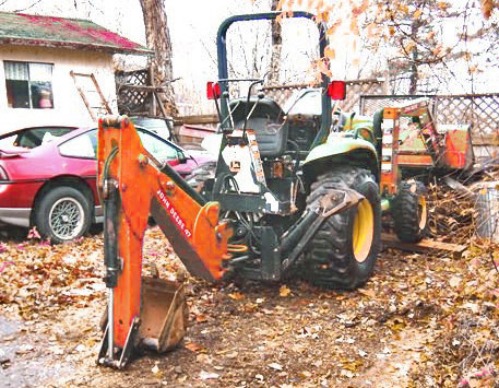

Finally finished...
The forks are still drying but at least the frame is complete.
A few photos of final build plus install.
lloyd
PS: worked on loader hooks & receiver ports today - will post images later.

Lloyd,
You really did a great job on yours also!_- Looking forward to the rest.
I like how you put a extra hitch on top._...What was the extra 4 boxes on the side for.?
Can you tell me the measurement from the top to bottom??
Thanks for the pics.~ This has been a good thread:D

jd4300,
I will take measurements and post. The 4 boxes are to hold things on receiver 2' hitch pipe.
I have a number of hitch balls with different rises plus a pintle hitch. I figure it is a good place to store them. Plus I can drop in the forks (in the top two ports)and it makes a good bench height with some plywood or 2x. I am trying to cover as many bases as possible. If you look back a few threads you will see a drawing with measurements - I didn't deviate much from the drawing. The bottom two ports will hold forks.
I was going to mount a carry all to 2" receiver pipe for the bottom ports. But since I made the forks I figure I will get a decent pallet and use that as a base to build the carry all on.
This was a fun project and my welds got better as I worked along. I think we really should thank TEACH for the design and inspiration....!!!!!!!
