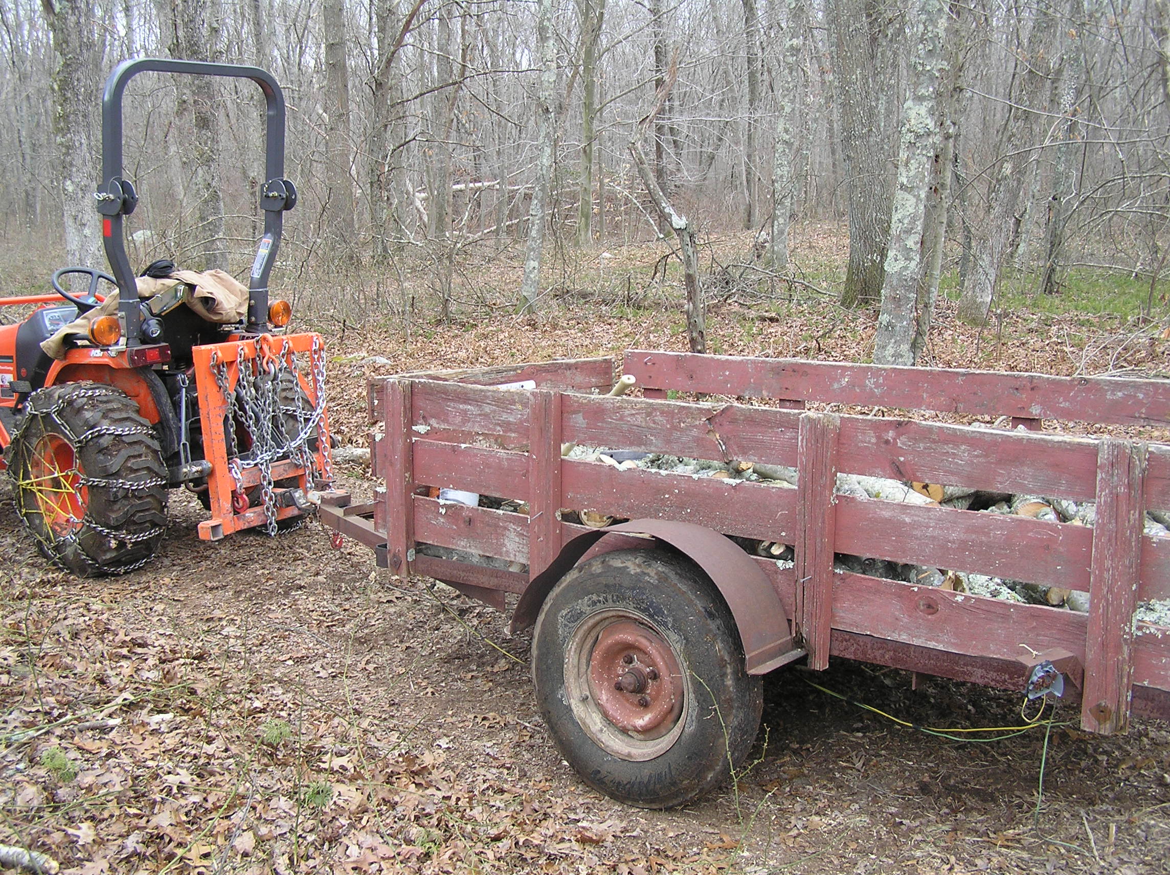

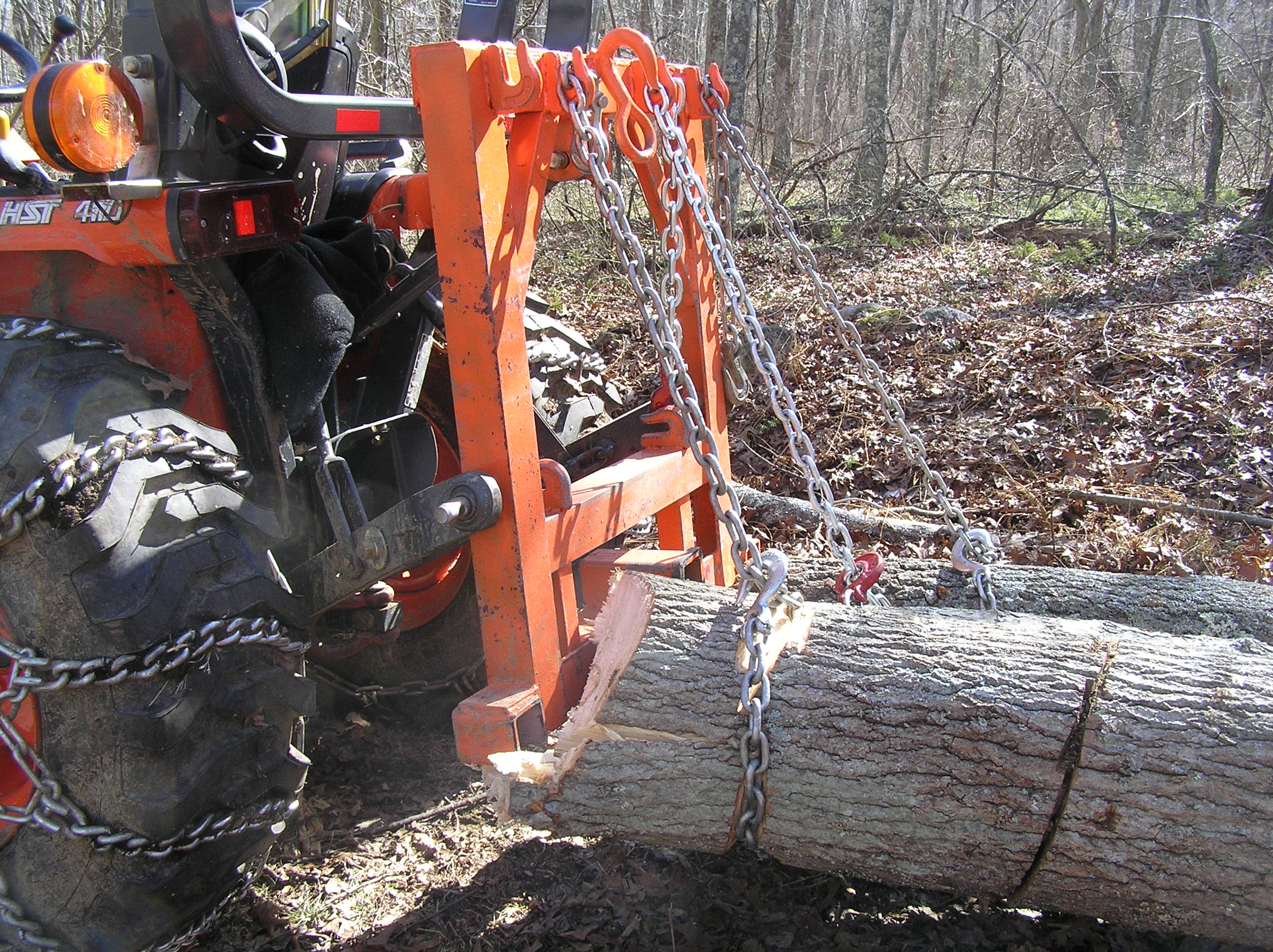

Here are some more pics of the hitch in action. Full size trees get skidded out and the tops are taken out in log length in the trailer. Also a pic of Boomer enjoying the fruits of my wood cutting labor.
Teach
That is a real nice setup, glad to see some pics. with it at work.
I know what i will be building.
Thanks for the pictures.
___________________
Good Mornin Teach,
Very nicely done ! That thing looks like it would work great ! Good idea on notching out the larger logs for the chain.
BTW your missing a lynch pin on your lower arm !

I see a problem with your logging hitch.
The chain attachments are high up. If you pull from an angle you will flip the tractor. I know you need them high to keep logs from catching, but you will flip your tractor if you turn and pull from an angle.
/ Logging Hitch
#23
Knight,
While I appreciate your concern, and I have given that some thought, I actually designed mine from the Farmi-type winch set ups. I have been using my hitch for over a week now. and it works perfectly. In fact, I couldn't be happier with it! It lets me lift up the logs high enough to clear the butts consistenly, as apposed to using a drawbar. This in turn allows me to drag more weight and keep more of the tree out of the dirt. Also, you will notice that I have two hooks DOWN LOW that I use to move logs that might be suspect. With my 21 hsp, hydro. b7500 w/ FEL, the only way my tractor will flip is on a steep side-grade (which I should not be driving on anyway). IF I had a gear shift tractor, I might agree, by not with my hydro tranny and all the weight I have up front. If the angle of the pull is too sharp, usually I can't pull the tree anyway.
Teach
/ Logging Hitch #25
I wasn't trying to put down your hitch. It just reminded me of when I was pulling a log from a high hitch point. I pulled and turned the tractor to the side, the tractor started to tip over. I caught it, but it happened very quickly. Just think about what your doing all the time. I'm sure you know to always pull down low when you can.
/ Logging Hitch
#26
Like I said, I appreciate your concern and I'm always willing to listen to fellow TBN users. Any ideas are always welcome!
