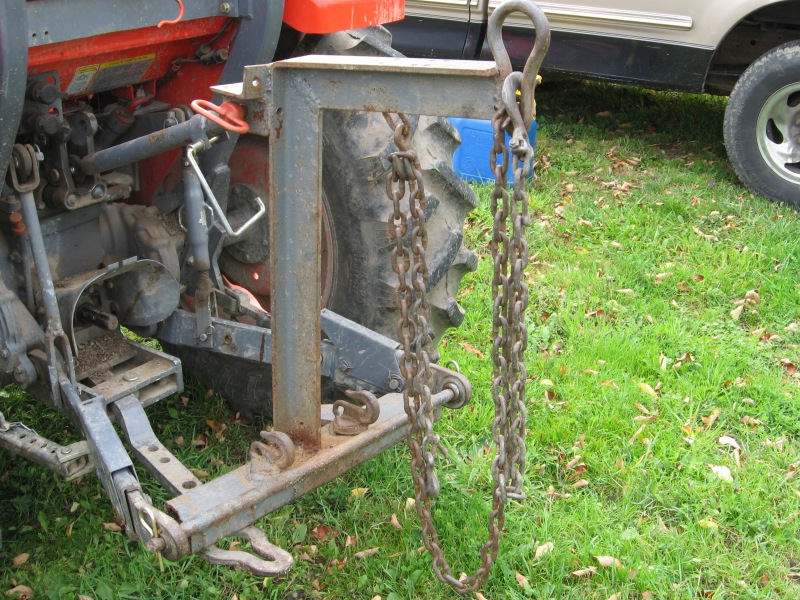

I have various lengths of chain with a clevis hook on one end and a round hook on the other. They are stored in the ammo box mounted on the fender. I also have a proper logging wire choker too. I also plan to use a small grapple/grubber as well: http://www.tractorbynet.com/forums/projects/137965-clearing-alders-4.html
This is still a work in progress. And once I get into the woods next week I will report back on it's success.

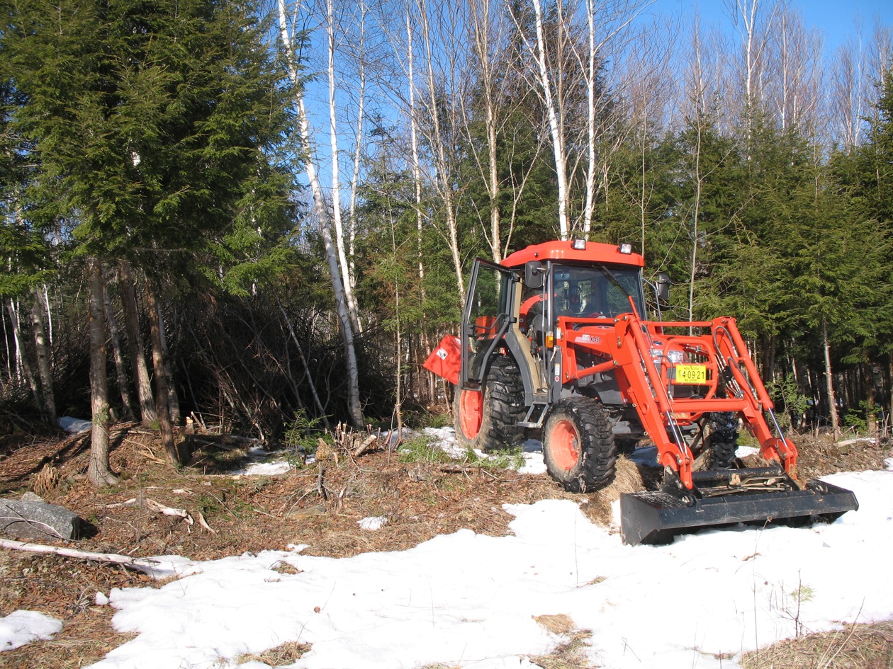

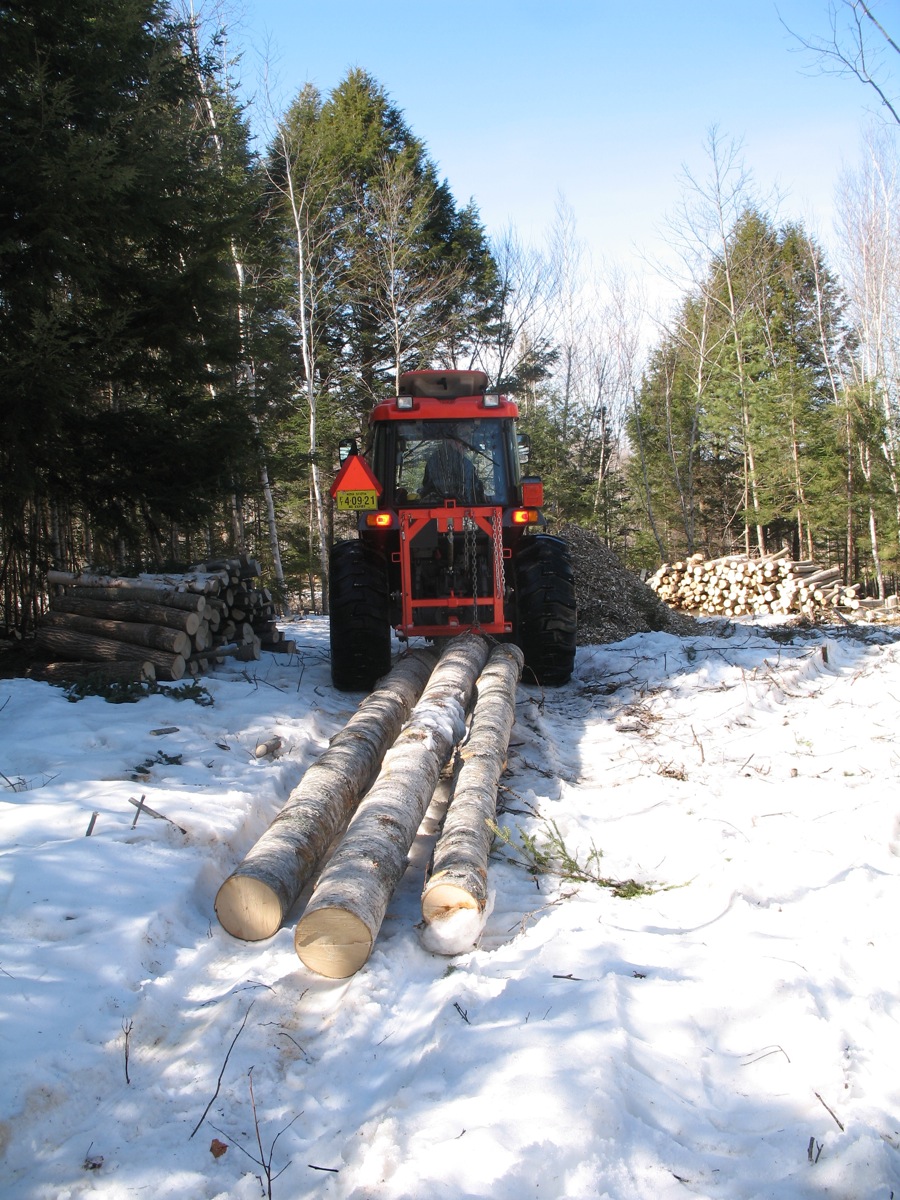

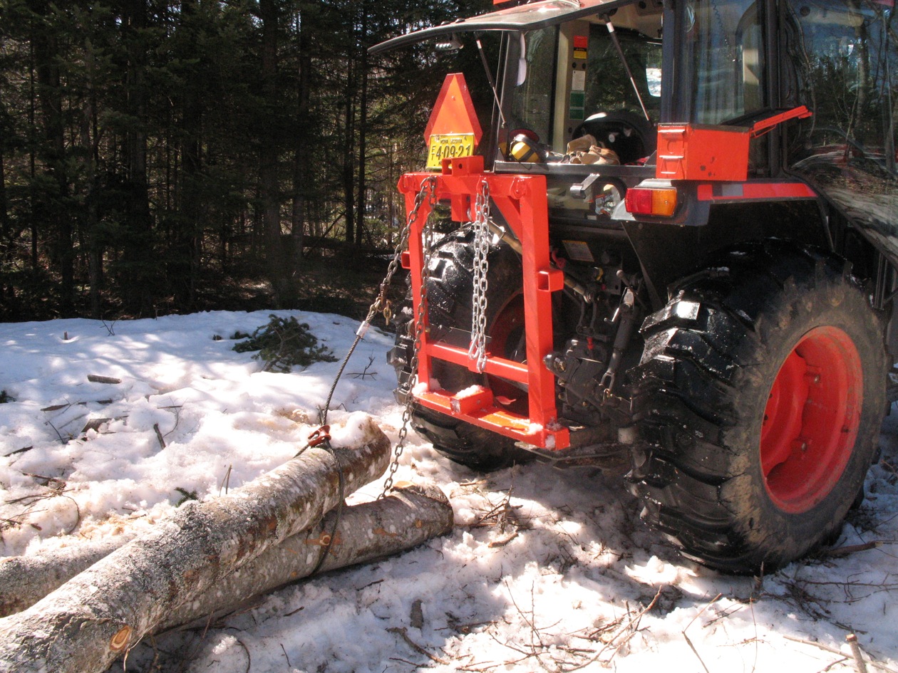

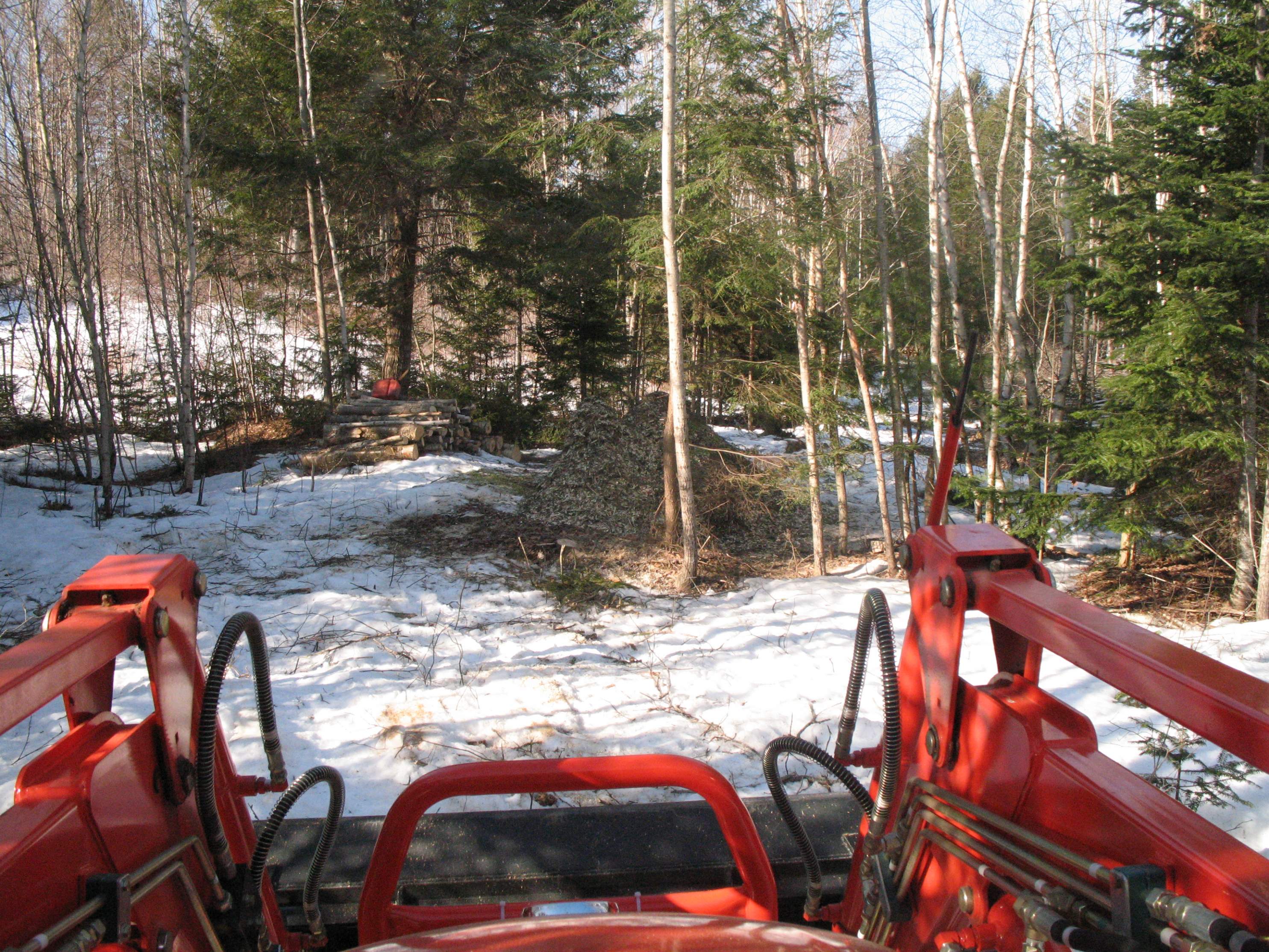

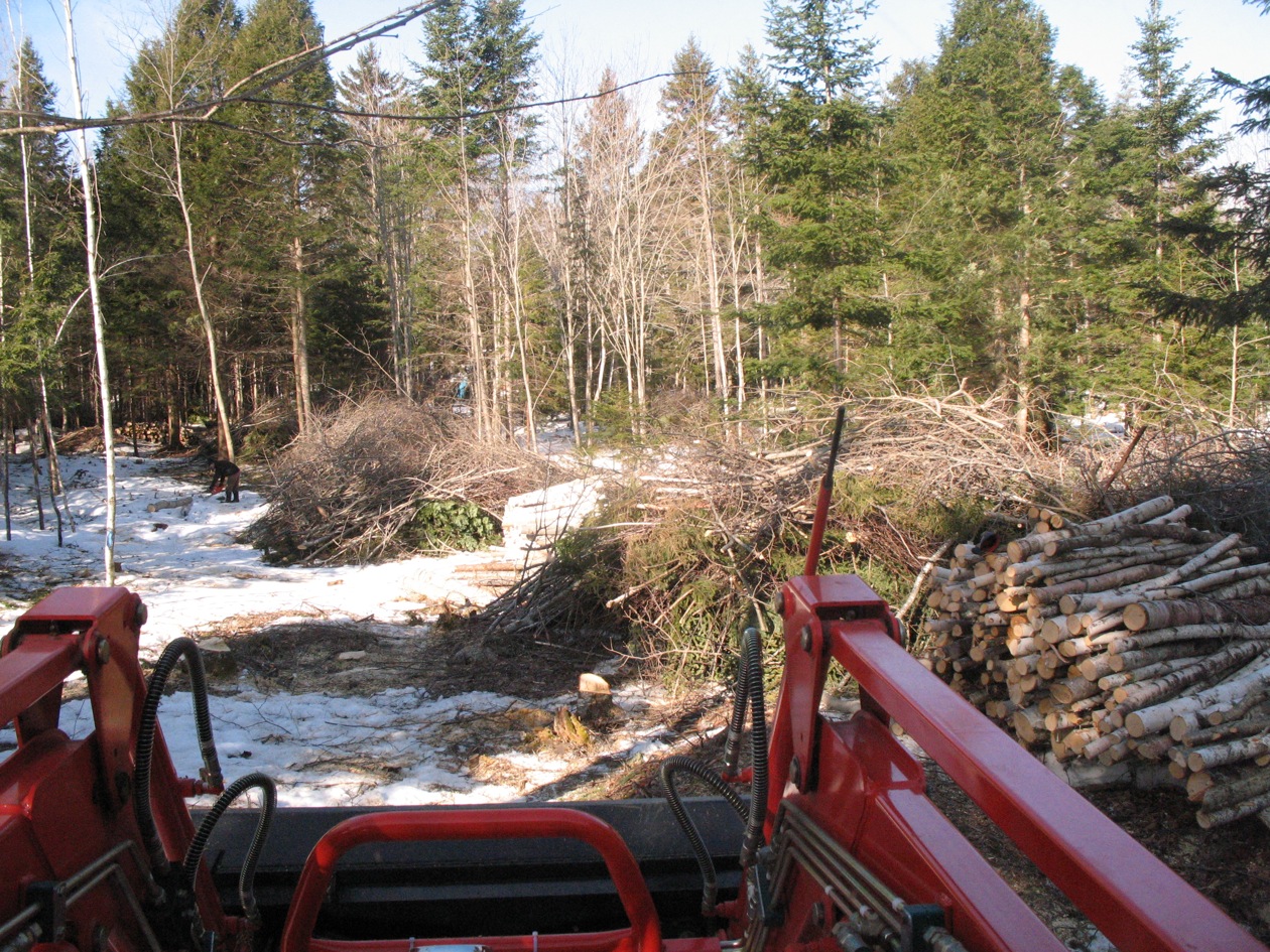

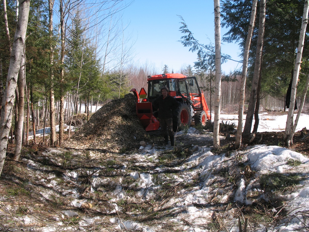

Spent the last two days chipping and logging for a friend. He's in the pictures - I am not.
I drove the tractor there - half hour drive. Did it early in the morning to avoid traffic.
Image 2 is the third pile. Forgot to take before and after of the first 2 piles. Image 3 is the after. Image 5 is on to the next piles. Image 6 is a closer look.
Image 8 is using the log hauler for the first time - welds held!!! Image 10 - another view.
We used the chain more so than the wire choker. The length of the choker didn't allow it to be hooked on the upper clevis hooks. Some times I used a short length of chain to get it connected. We found in the end chain worked better and allowed us to lift the logs. The ground was fairly level - so even dragging on the ground worked. We ran two 7 hour days at 2300 rpm and used 20 litres of fuel - not bad.

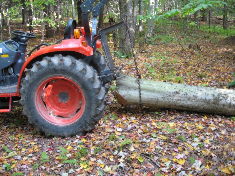

lloyd
Lloyd,
With the hooks on top...How high could you lift a log off the ground??
Bill

I've been using this for several years now, It works great.
