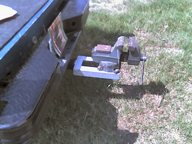

Do you mean have an adaptor so you can plug a vice into a receiver tube? Have the vise attached to a plate, attached to an insert tube.
If so that's what I want to do also, was just thinking about for my service body truck, my last truck had one on the bumper but didn't get used that much so I thought with the new truck just have it removable via receiver insert.
You have me thinking it could come in handy on the tractor as well, I have a receiver on the top of the bucket as well as a 3pt unit.
Thanks, JB.
/ Logging Hitch #118
Here is a receiver vise set up. Yea, I know, but when I look at it on my computer, it is full screen. Well, the top picture works.

JD,jj,jb,
Exactly. I got a record vise at a yard sale. I will mount to a base with insert tube. Now re: the truck I think I will make an adapter to fit my truck as well.
Darn TBN - too many ideas - not enough time!!! :):) Keep them coming though!
