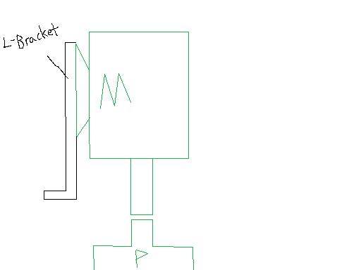

I have been searching for a motor for my project. Running to the local electric shops. JJ that sounds like a great deal on a 5hp electric. I was more interested in experimenting with this set up as opposed to a gas engine. The motor from nothern that was posted, looked like it would work until I noticed that there is no way to attach the pump to the face of the motor. A pulley set up is out, because the pump can not take any lateral force. I am going to keep working on this one and will keep you all posted.
/ log splitter plans #54
Are you talking about the air compressor motor that bassgrinder posted ot the one that I posted. If you are talking about the one I posted, that was just for an example, but you do want to get one that is a TEFC.
As far as attaching it, it does not have to be a c-face motor. the base mount will work just fab up a vertical L-shaped mounting plate and bolt it to the motor, and then to the plate where your gas motor bolts. Heres a diagram
/ log splitter plans #55
Sorry, but did not look at the motor face. However, you can connect it shaft to shaft using Love Joy units. Just build a stand for the pump and align the electric motor shaft to the pump shaft, and it should work.
