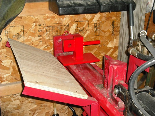

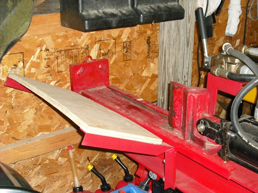

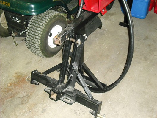

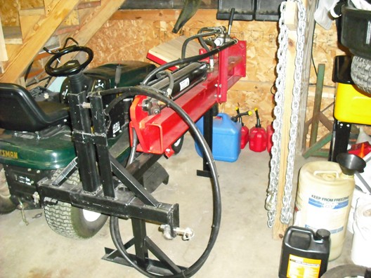

I built one 4 years back to run off my tractors hydro system. I used a 4"x24" stroke. My hydro system is 7 gallons per minute but I am sure that is probably at PTO speed or somewhere near. I have split about 100 ricks with it and 1200 rpm on my tractor works fine even though my PTO rpm is 2250.
As you can see I utilize my 3 point hitch I made out of a Ford Ranger Hitch for the attachment. I also made it go long ways out the back of the tractor so two guys can work from it. I added the wood log cradle later which is a must and I also made a adapter in the 3rd picture that allows it to double as a shop press.
Chris
