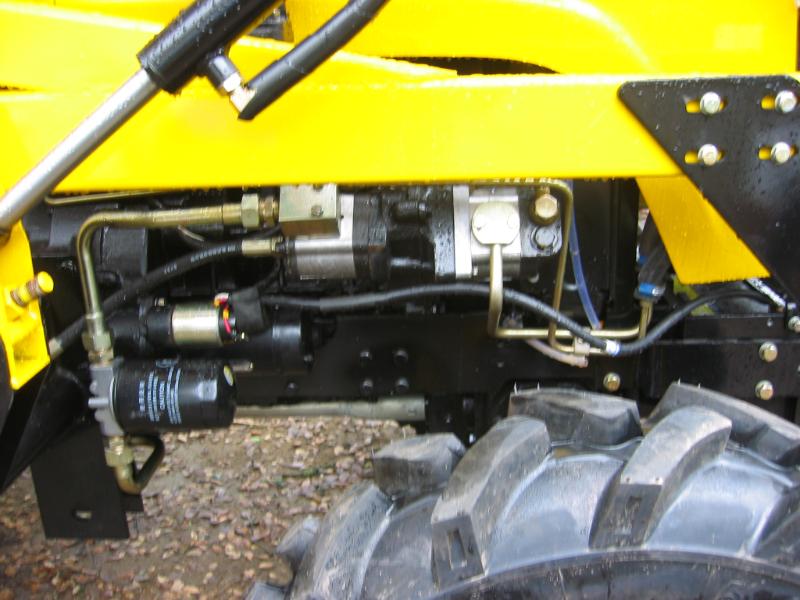

I guess I should have explained better. My tractor has a pto pump that is mounted off the front end of the engine. It is drive by a gear the runs the injector pump. It is not PTO drive but at any rate I am only running the engine at about 1/2 throttle.
By the way the tractor I am using is my Jinma 28 HP.
Chris
Chris
I just reread what I wrote JJ and I screwed up again. It should have read "My tractor has a HYDRO PUMP that is mounted off the front end of the engine."
Its a engine drive pump, not pto.
Sorry
Chris
