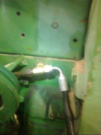

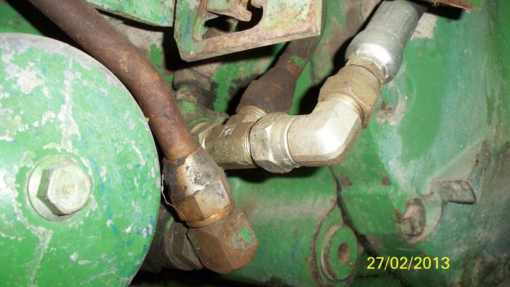

can anyone tell me exactly what i will need to get live hydraulic power and how to do it so i can feed my loader instead of using the rear remotes from the tractor on both my 4010 and 4020 john deere tractors or is there some kit out there and where can i find these parts thank you

On 4020 large line on RH side in front of brake valve for pressure and rockshaft return line on LH side for return oil. I think 4010 is identical. If it's not post back and I'll do some research. The fitting part #s are AK40462 & AR35712

thanks for the info are these john deere part numbers also they don't have 3 point hitch
/ loader supply #4
Yes the part numbers are JD numbers. If you want to get tee's from another source I can provide the spec's if you need them. The trans case should still have the threaded opening even without the 3 pt(rockshaft)
