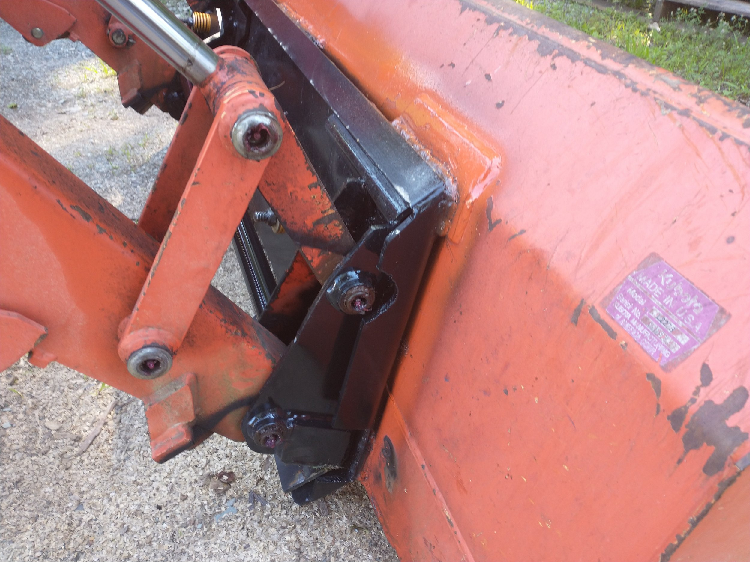

I do them all the time, I cut the pin mounts off the bucket and weld them to the QA latch boxes then weld a quick attach plate to the bucket.
Take your time and get all the measurements correct, you may have to add a stop to the bottom so the bucket doesn't roll too far over, check that on your bucket first.

You use these inexpensive attachments? They seem strong enough? What do you mean by the bucket rolling too far over? My snow bucket has a rounded back that works beautifully causing the snow to roll out in front of the bucket. I was thinking of leaving it as a pin on because welding a plate to it would require a bunch of filler strips. Most farm loader buckets do not curl back far enough to keep things from falling out in my experience.
Yes I use those latch boxes, I have done many tractors for people, never had a problem and I've done some pretty big tractors. If you lift your loader and look at the bottom of the pins on the bucket there is usually a thick piece of steel to stop the bucket from going any further, just have to keep that the same.
Here are a couple of pics:
