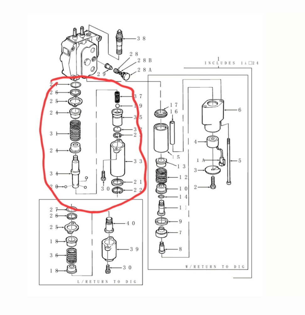

new holland ford 445C
eKretz, please let me know how to set the float on my NH 445C loader. I can't get the bucket out of the mud. Would it damage anything if I just forced it with my 20-ton bottle jack? Should the control linkage be in a certain location? Fred
/ loader float #3
Most spool valves for front end loader boom control were designed to push control valve spool fully forward to engage float position. I would think with tractor engine operating one could use tractors hyd system to raise bucket out of the mud.
/ loader float #4
Push the loader all the way forward as to lift the front of the tractor, then push the lever forward a bit more, you should feel the lever go into a detent that is the float position
/ loader float #5
The 445c Does have the bucket float function when the lever is pushed past the down position. Access float in any bucket position with a quick jab of the lever forward to drop the bucket.
/ loader float #6
Fred, on my 555D, it's just as the usual and as these guys have described. Push the lever fully forward until it hits the detent and stays there. Pull it back to get back out. If the lever won't go forward into float position, don't force it or you may bend or break the linkage. You may need to take the valve apart and do some cleaning.
BTW, are you saying it won't go *into* float? Or that it won't come back out? By your description of bucket stuck in the mud, I'm thinking the latter.

What Erik said plus the chain is not going to do much at that angle. I would try to lift the back end out of the mud with the backhoe and try to drag it backwards with the loader bucket in curl (use a bungee to hold ot in curl) and the loader lift in float. Solve one problem at a time.
Also, loader detent may be sticking valve. Can you verify if the loader stick is actually moving the valve spools?
