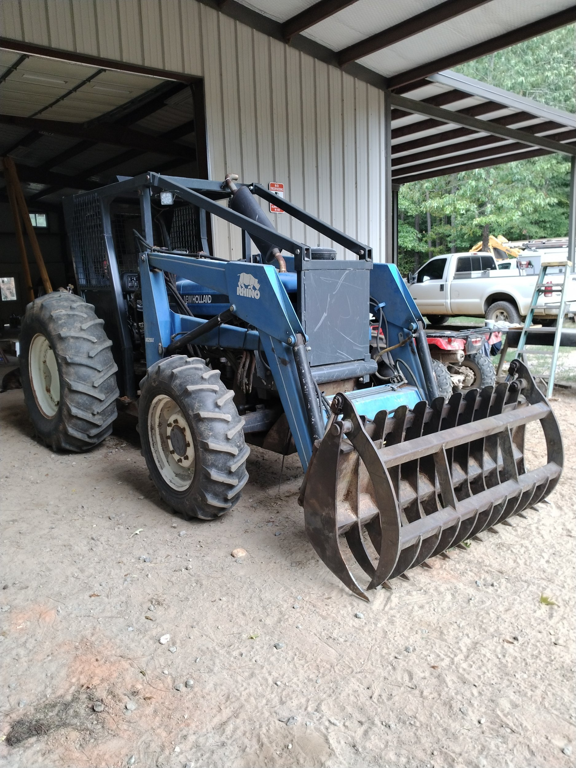

Both Bioballast and Rim Guard are significantly heavier than water
And significantly more expensive. We build a HD belly pan with 3x6 tubing and 3/8 plate. Covers the extra weight, plus added protection. Debated filling square tubes with lead. I don't quite have enough yet, but I'm close.
Already have the belly pan (I forget if we used 3/8" or 1/2") plus the weight of the backhoe subframe the belly pan is mounted to, a heavil built grill guard, limb risers and FOPS... and still filled reae tires with CaCl (no one was selling Rim Guard or anything like that in my area when I bought this tractor).
I've not met anyone in my area who uses plain water (freezing is a problem), or even water with antifreeze.
