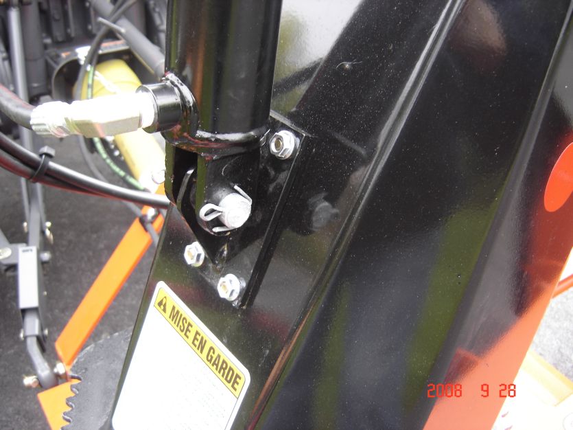

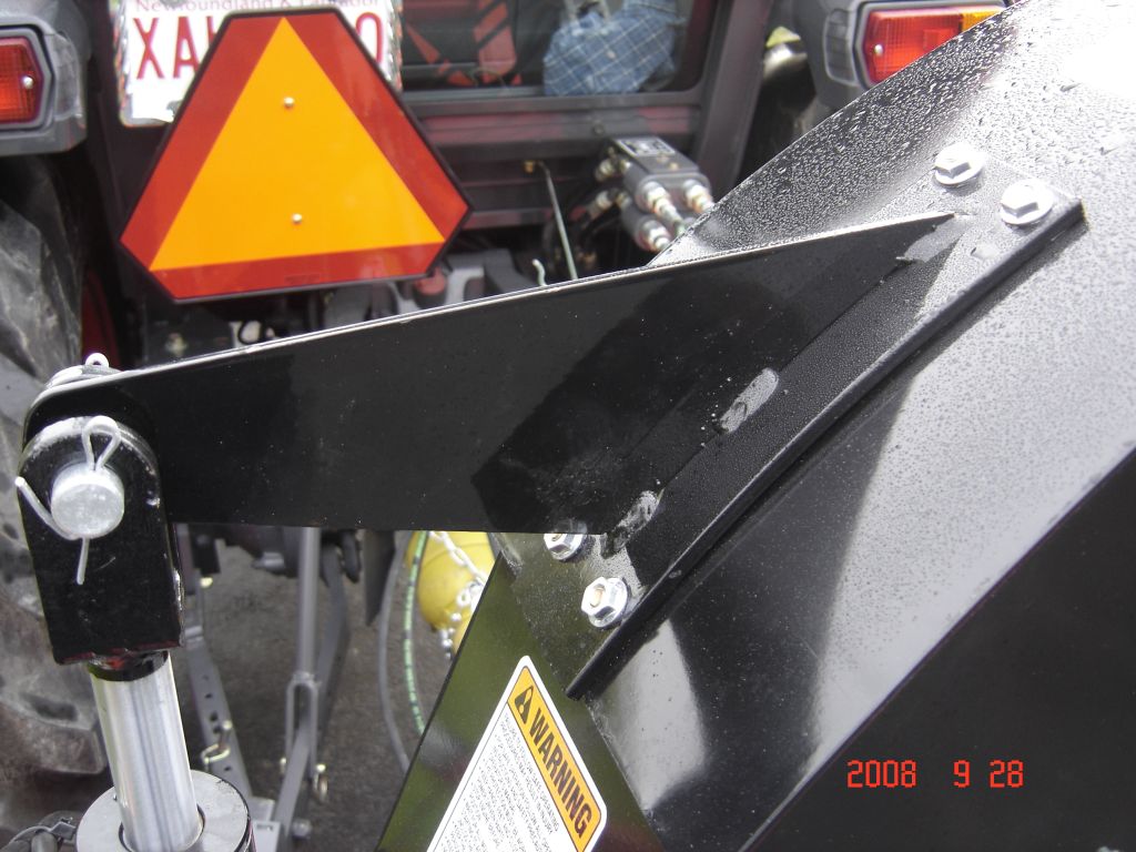

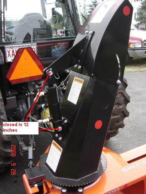

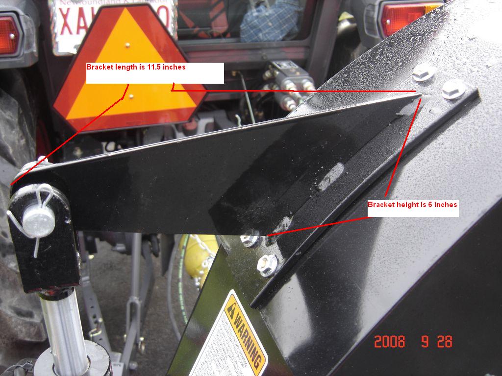

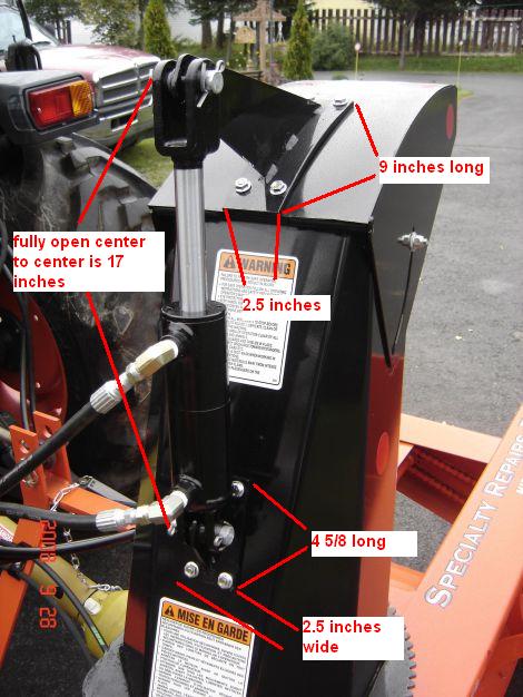

Here are the pictures originally provided to me by Paul? Repair Specialties
I have obviously adapted to fit my application but you will get the main plans
Hope this helpsView attachment 239448
:laughing: I forgot about them. I made the same brackets for my buddy's chutes and mounted the linier actuators between them.
