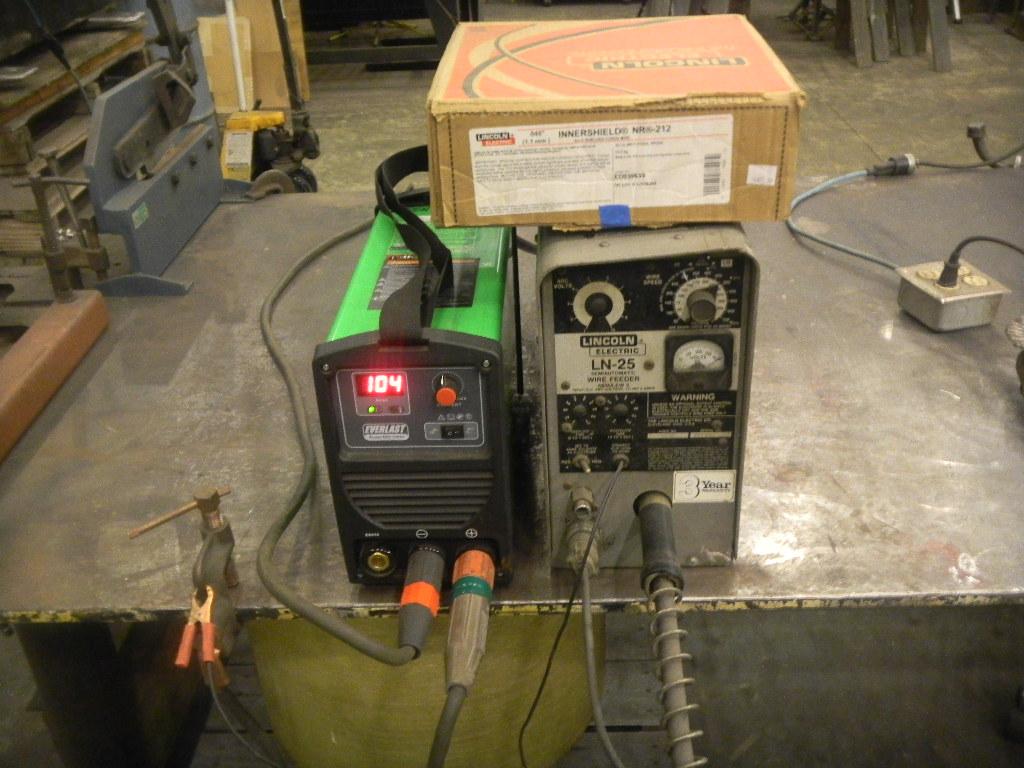

Doesn't the Lincoln Arc 225 take 15-amp jumps? If so, that would drive me crazy!:confused2:
I'd contact Mark with Everlast and see what kind of a deal he can make you on a PowerArc 200ST.

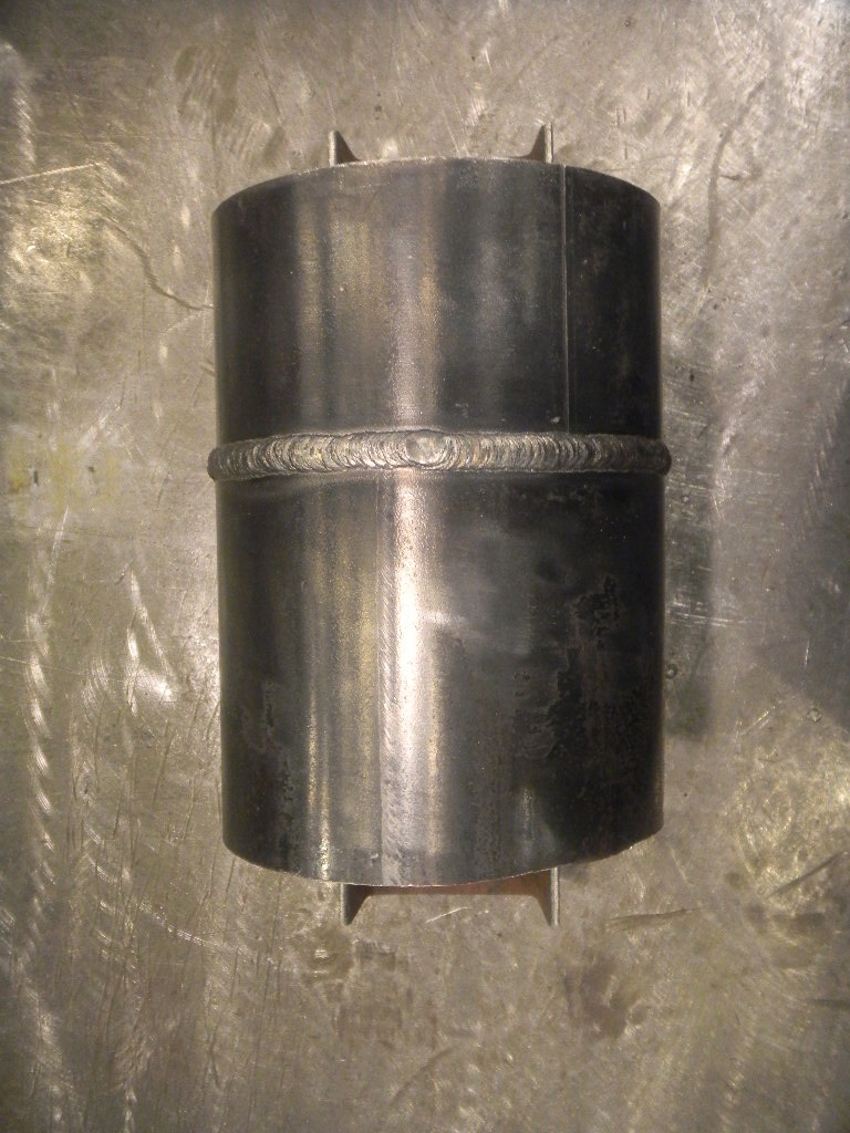

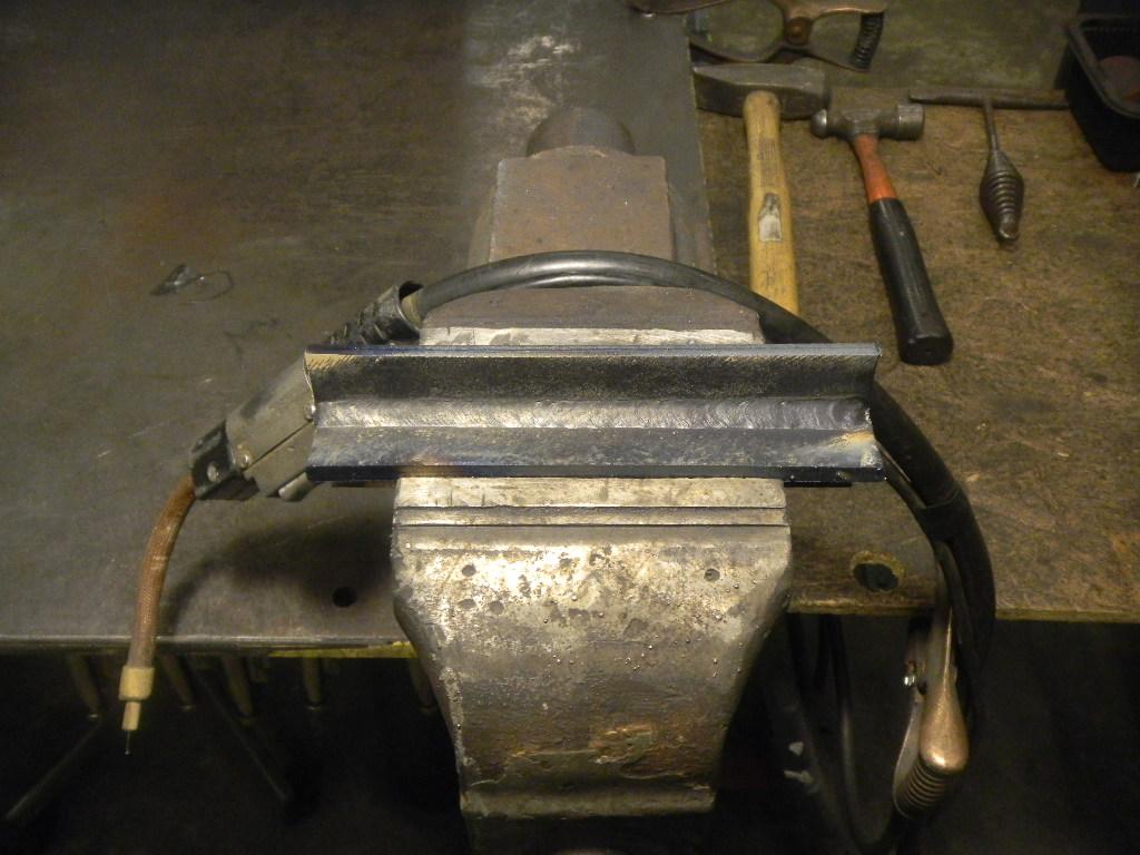

I've had three Everlast welders to date. For the money they have a very impressive arc:cool2:. Here is what the PowerArc 200ST can do with an LN-25 wire feeder with self shielded wire, and 6010.

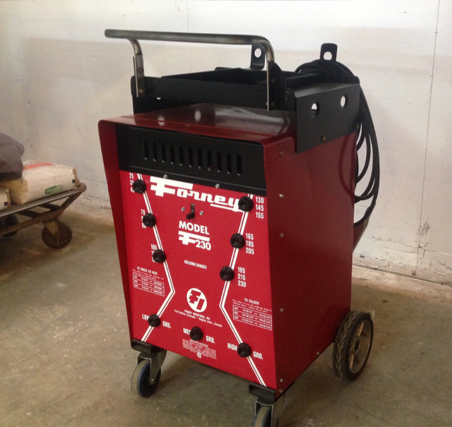

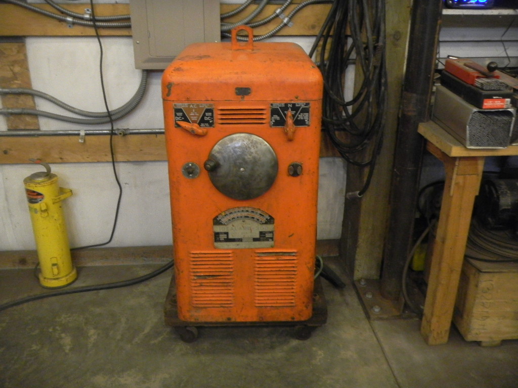

This is my original buzz box I used for 35 years. Notice the 10 - 20 amp jumps between tapped settings. It never drove ME crazy because I didn't know any better!
Plus 1 ^^ on recommendation to consider Everlast.
Terry
