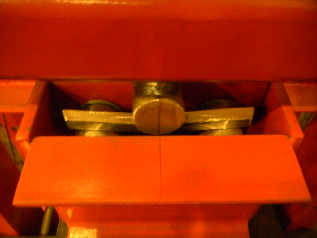

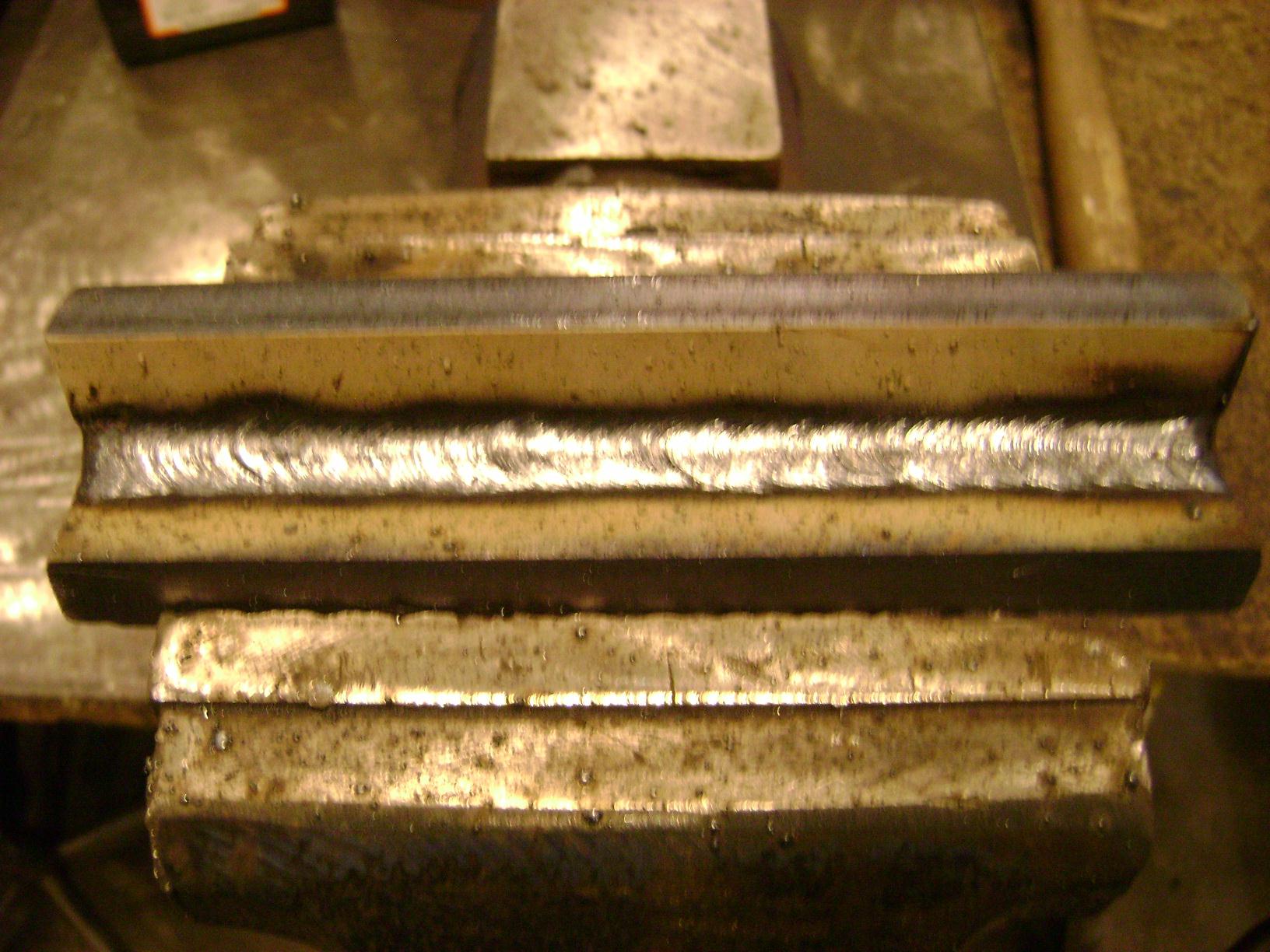

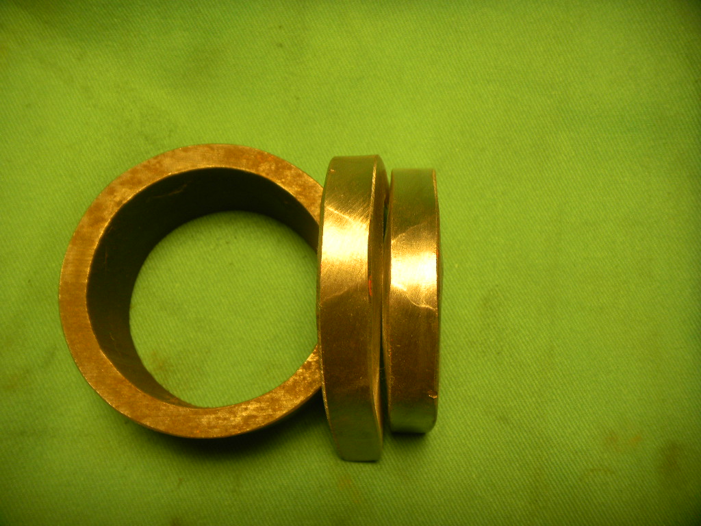

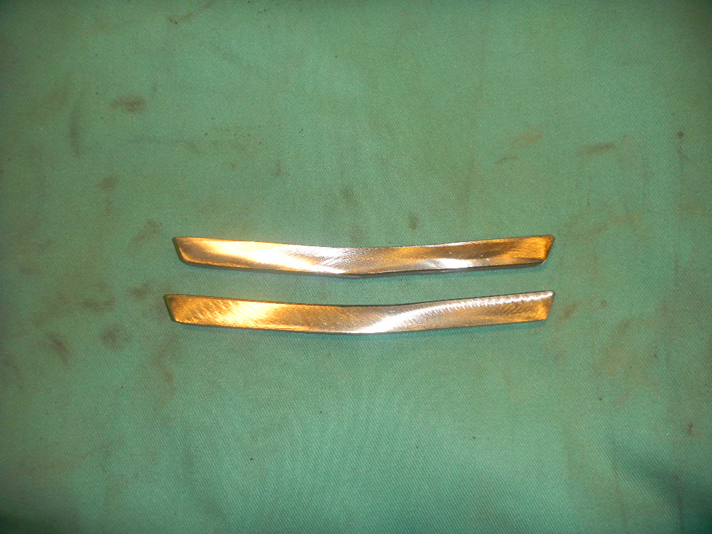

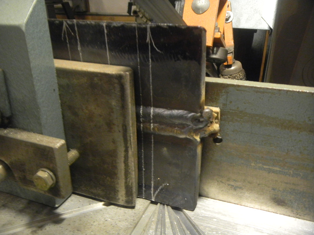

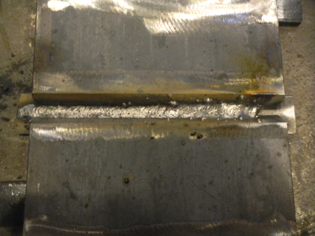

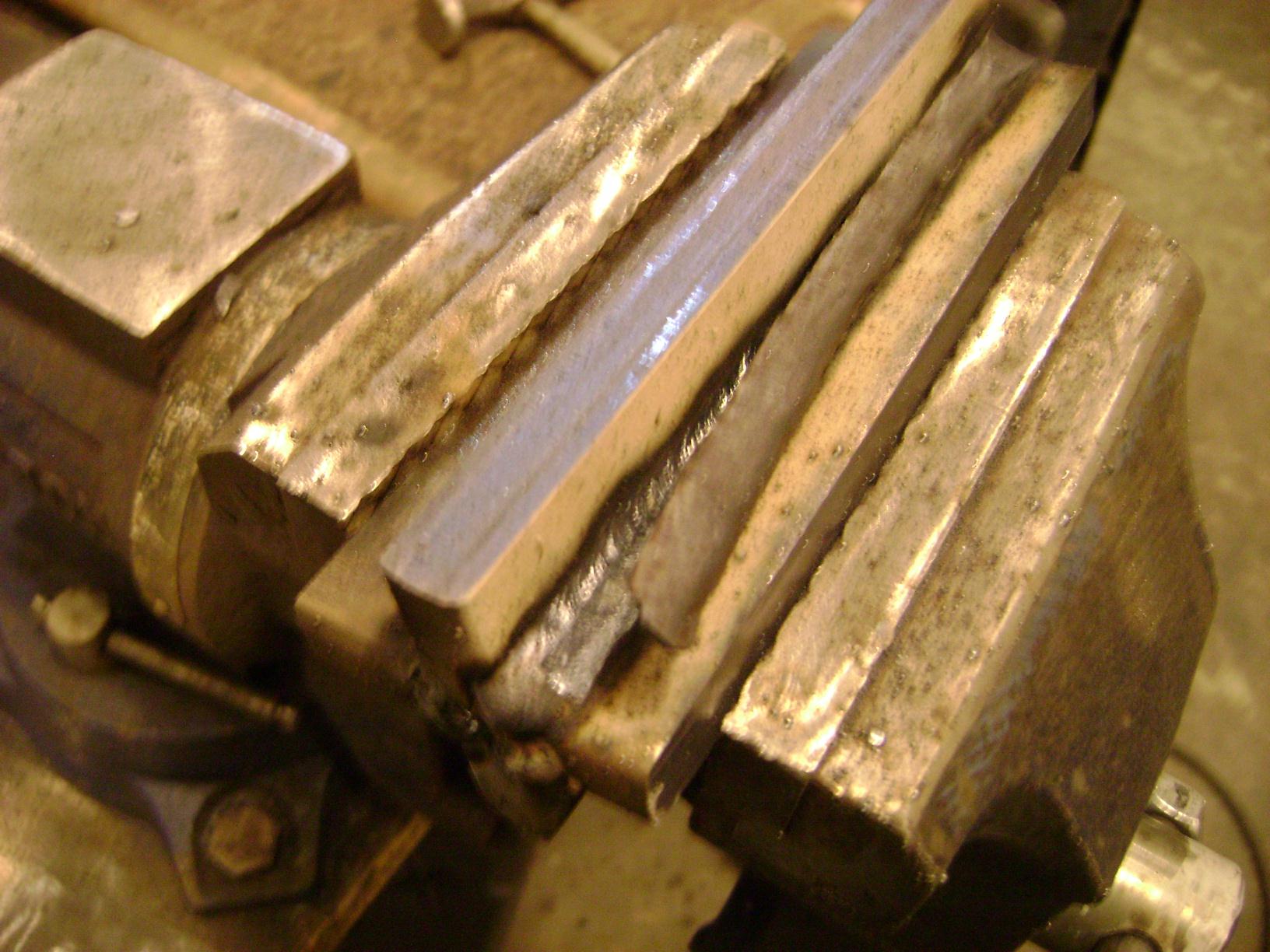

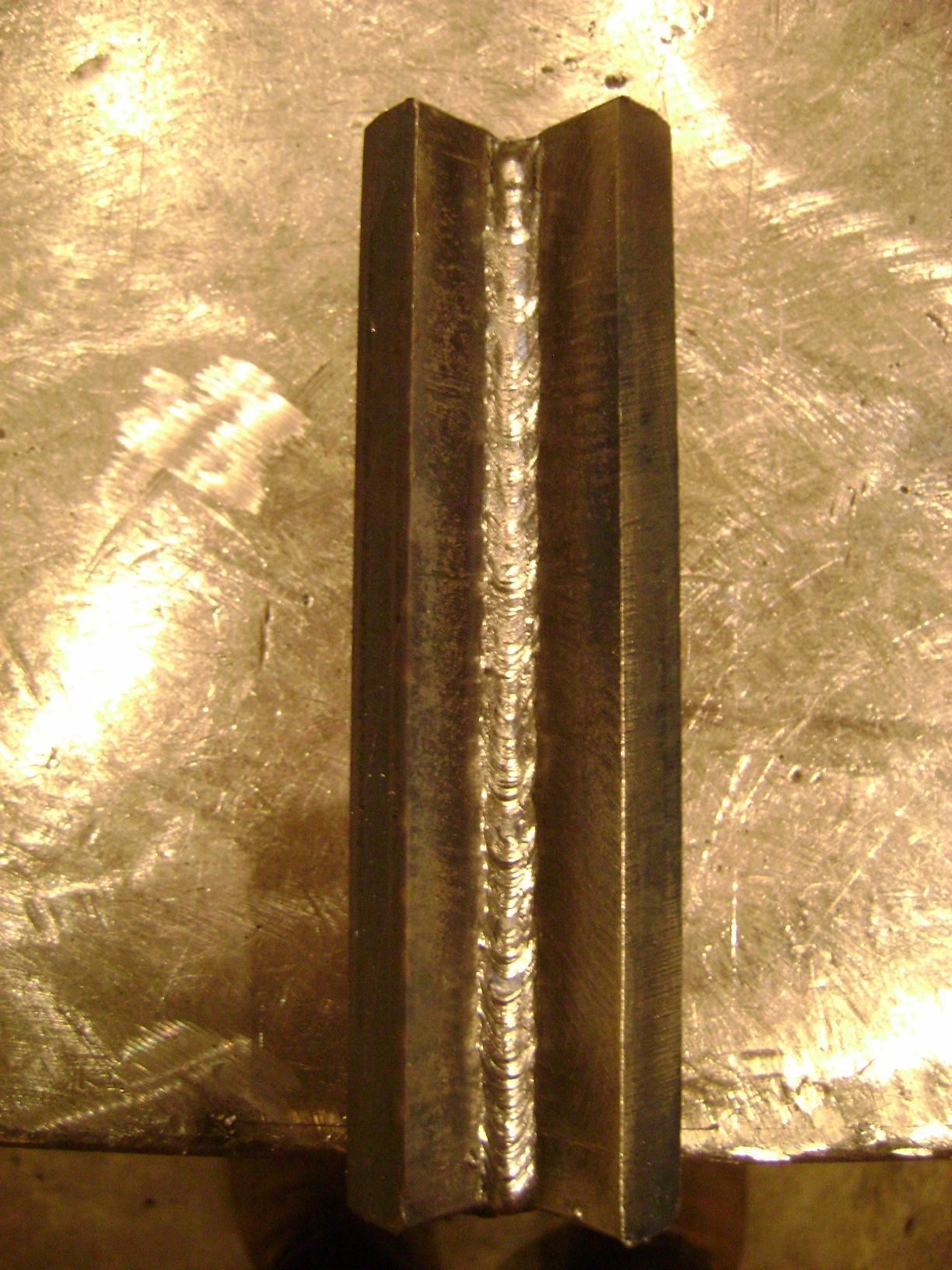

Living in the North West, I can't tell you how much bridge, and overpass falsework I've built in the pouring down rain without a tent.
This is how we used wet 7018.

Shield Arc,
In the first picture middle row, I notice that there are no BB's at the left and a noticable number at the right and I can't figure out what caused it. Can you enlighten me, please?
Only thing I can think of is, the rod got so hot at that point the flux was coming off the rod. Cause the weld went ape **** on me. :eek:
