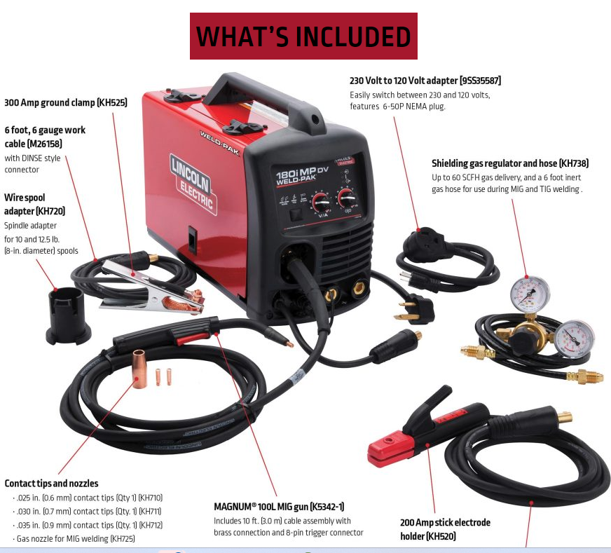

A friend of mine asked if I wanted to go in halves on a welder and bought the 180i before I could research it. It seems like it will be a decent little welder, but there are not a lot of reviews that I can find. But it does seem a little light weight for the specs. The box is unopened and we can likely return it if there is a better option for similar price ~$1,300.
Do any of you have experience with a welder of this type?
/ Lincoln 180i multi process, dual voltage #2
It's an IGBT machine so it won't be power hungry but with that low of maximum output, it's only good for short circuit MIG. Don't have the balls to do Spray Arc, Globular Transfer. My issue with Lincoln (and one of the reasons why I sold my Squarewave Tig machine) is the crazy high cost of replacement parts as well as the warranty. 1300 is kind of high for an under 200 amp machine today.
I see the foot pedal and TIG torch aren't included either. You'd have to buy a TIG torch and foot pedal and with that low of an output, welding aluminum (which requires high amperage) is out of the window as well. Fine for tigging mild steels however so long as it's not to thick. I run a CK Worldwide Series 17 torch on my machine as well as a water cooler which is something you don't need for steel.

The 180 is a little over priced in that Lincoln doesn't make it. They don't list output volts only amps.
I'm sure it's a solid machine and you can expect to weld 3/8" material at a low duty cycle with 035 wire.
Research would have shown that you could have bought 2 other brand machines with good reviews for $1300.
