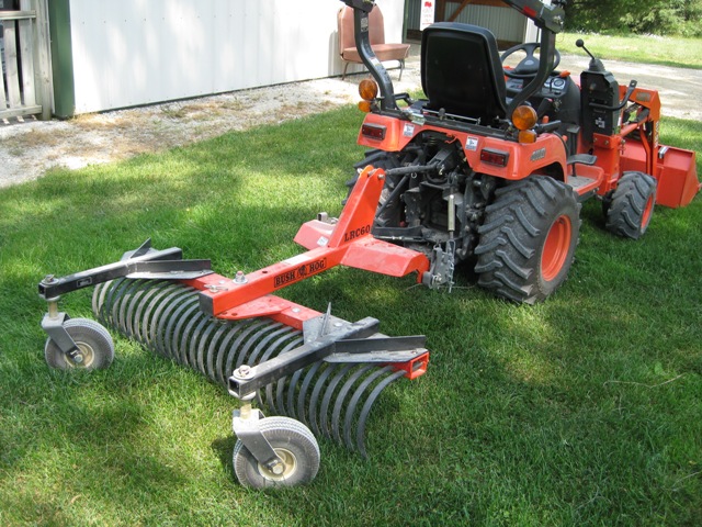

I have the Bush Hog LRC60 model for my BX23. Works very well for the limited cat1 hitch. The only problem I had is that when I bought them, I was told that gauge wheels weren't available, but were going to become available. As far as I know, they still are not available for that model. I had to make up my own from parts from another manufacturer of landscape rakes. The casters are from yet a third manufacturer. So if it is just the rake you want, then the Bush Hog would be a perfect match for you. But if you are looking for one with gauge wheels, and I would highly recommend them by the way, then make sure you ask the dealer to guarantee they are available.
Just checked Bush Hog's website to see if gauge wheels were available yet. They are not. But I did notice the the Bush Hog model number is now a CLR60. Interesting that the Woods model is now a LRC60. Must have been some naming rights being stepped on when I bought mine.

Nice job on adding your own gauge wheels! I guess now though the wheel brackets prevent you from turning the rake around 180 degrees? That is probably not an issue for you, but may be for some folks.

Thanks. It took awhile to find all the right parts, but in the end it works. You are correct. You cannot rotate the rake 180 degrees, without removing the braces. There are only two bolts holding each one, so it isn't all that bad of job if you need to. But I have never had a need turn the rake around backwards. I mainly use if for maintaining my crushed rock driveway. The wheels really make this a whole different tool. No more wash board driveway.

BTW, I am unclear of the advantage of turning the rake 180 to its usual position. What is the advantage or rationale?

Turing the tines 180, to do fine work, without loading the rake is an old trick of the pro landscapers and is common. I love the method myself.
