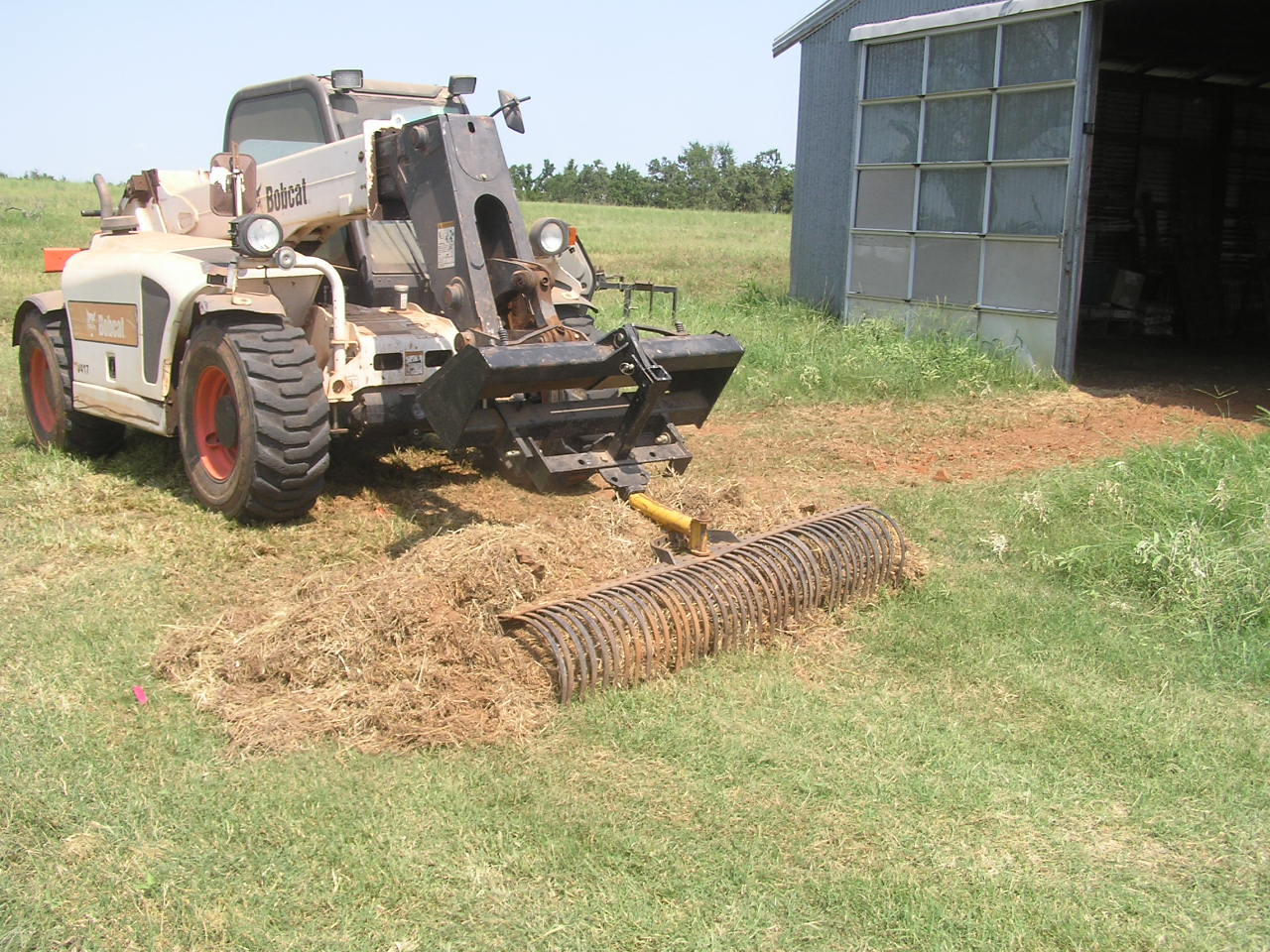

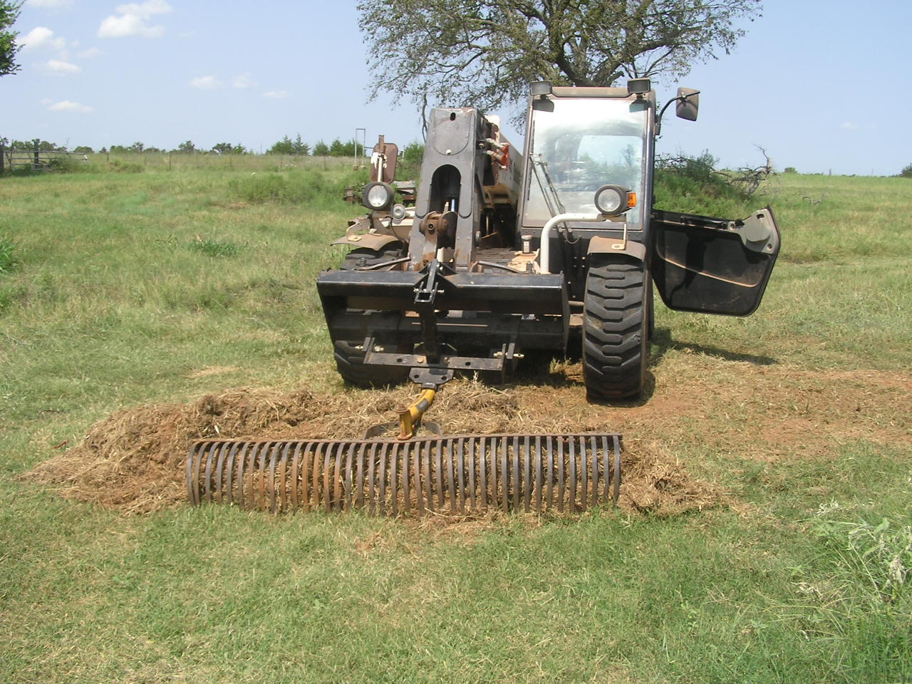

More pics to come as I make more progress and get into tougher stuff but it's working great for now and worlds faster with the rake in front where I can see what's going on.
Yep, out front is gooder :giggle: .

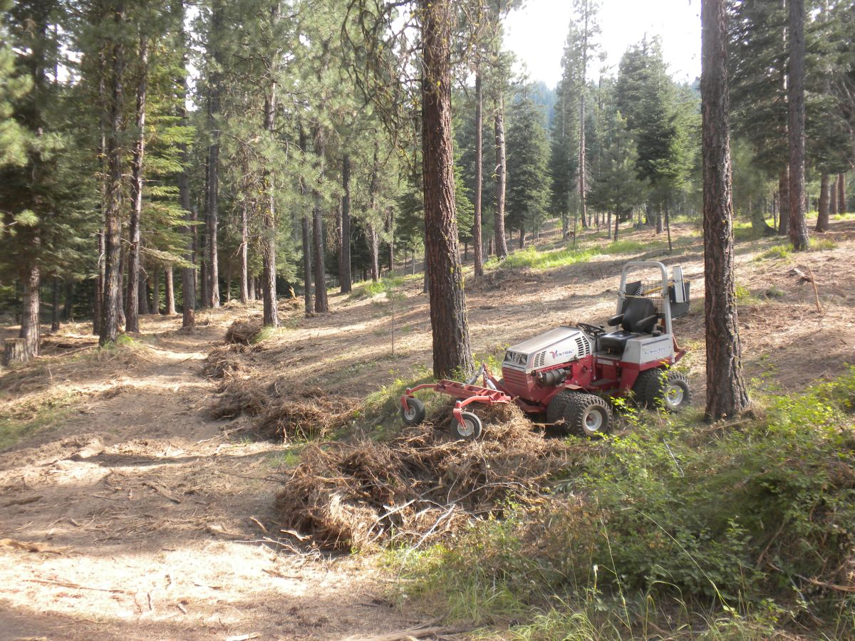

I've got a grapple rake on my skid steer but unfortunately I have very little terrain other than a few skid trails that the skid steer can handle, and even those have sections that I can only work by backing uphilll. So, I'm mostly using the Ventrac to rake material in selected areas and move it to the skid trails where I can grab it with the skid steer grapple rake and pile it for burning. Interesting idea on the harley rake.
