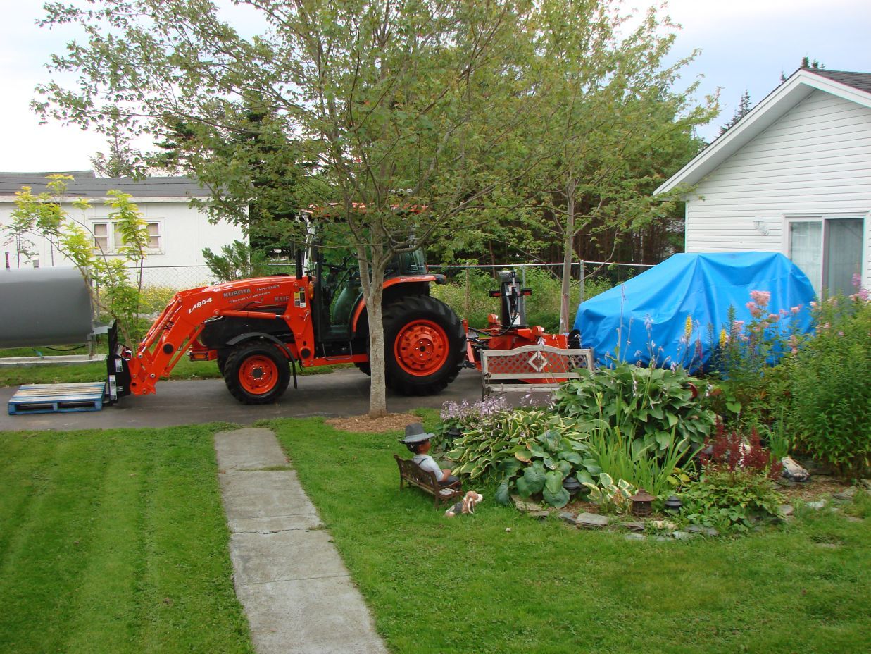

I keep a couple of shackles on my tractor for "just in case" as well. I put an o-ring on the pin and a slight countersink on the shackle so when the pin is hand tightened the o-ring gets crushed just a little bit. That way you can leave the pin finger tight and the vibrations will not loosen them up (and loose them).
I would copy your design but the front grill has to be removed when the sub frame for the front blower gets mounted.
Good idea on the shackle pins. I just put one removable electrical tie rap through mine preventing the bolts from backing out.

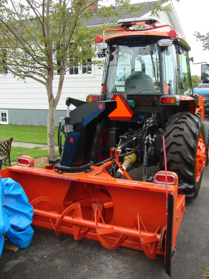

Great work Paul !:thumbsup:
I love the LED work lights on the blower , I looked into putting them on my plow truck but ended up with halogen. I friend put them his truck and hates them, they don't melt the snow and he has to get out and clean them off all the time, I never thought about that !
/ Lights/shackles Phase #1
#33
Ya that's one of the disadvantages of LED lighting, they run cool. It's been a big beef with truckers as well using them on the back of there trailers. Once they get snow on them it don't melt off. As for the ones on the chute. I figured having them there was better than not having them at all. I can always go with a set of wipers on them like Volvo had on there headlights some years ago :thumbsup: Thanks.

Or put electric heaters on them similar to what some outside mirrors on cars have now.
Ya. Could do that but if it comes down to it being a real problem I'll just remove them. Easy on, easy off. Problem solved :D
/ Lights/shackles Phase #1 #37
I think at some point you loose the advantage of the low power draw of LEDs. :laughing:
