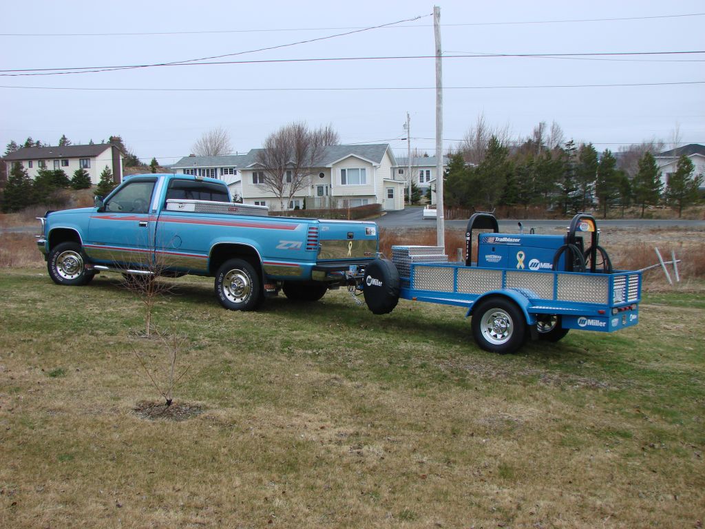

Oh man I almost jumped at the idea of coming down until you mentioned the word "Blue". I'm after using a lot of blue paint as well so the challenge is gone :laughing:
Ya the Edwards sure has helped me out in the shop. The oblongs have come in handy. One guy asked me how I drilled them and I told him I use an oblong drill bit :D
