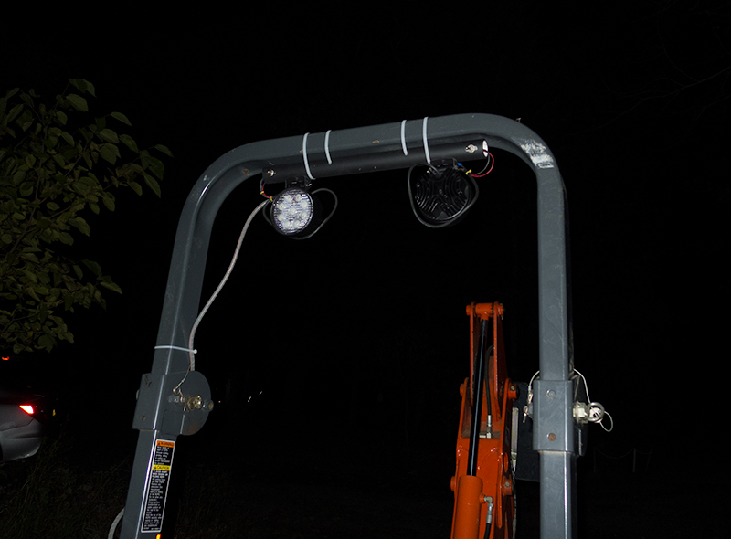

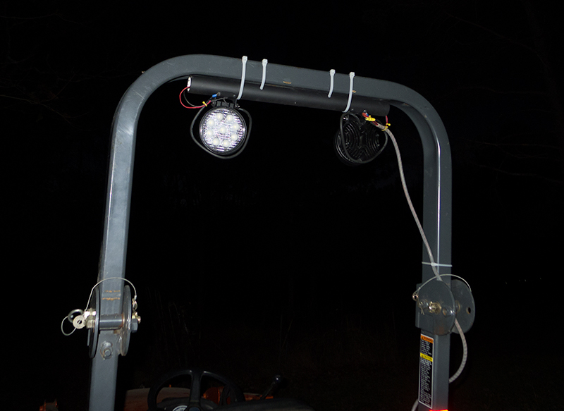

I used a piece of white pvc pipe (painted black) and mounted two 27 watt led flood lights to the pvc, then ty rapped it to the ROPS. I also installed 2 switches so I don't drain my battery. On my B2630, there were power leads under the rear right wheel well. I picked up the 27 watt led's on ebay for $26 each. They are really bright.
