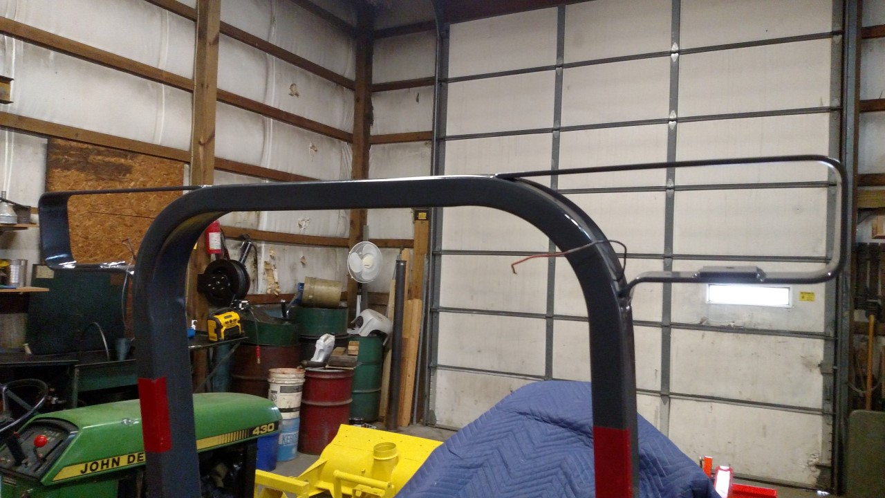

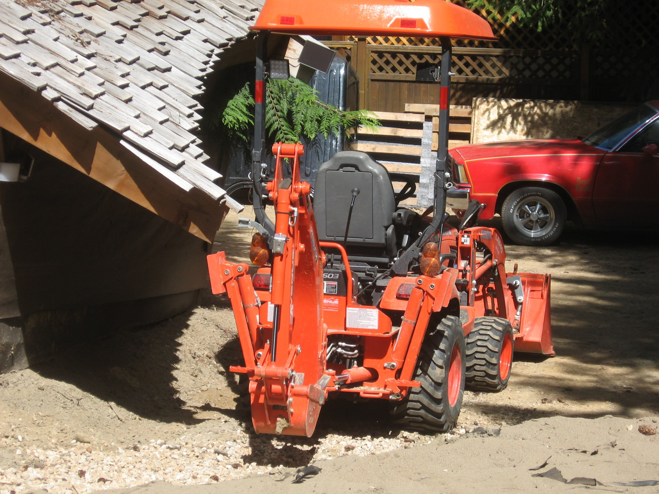

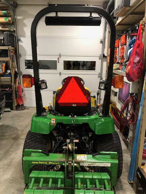

Not the greatest pic but mine are mounted above the turn signal to the right side. Mostly I mounted them there because I didn’t want to mess with always putting the ROPS up all the time. The bad is the glare would be less annoying if they were higher up. JD has some wires already at the back of the tractor you can plug into and then the new lights come on with the factory switch.

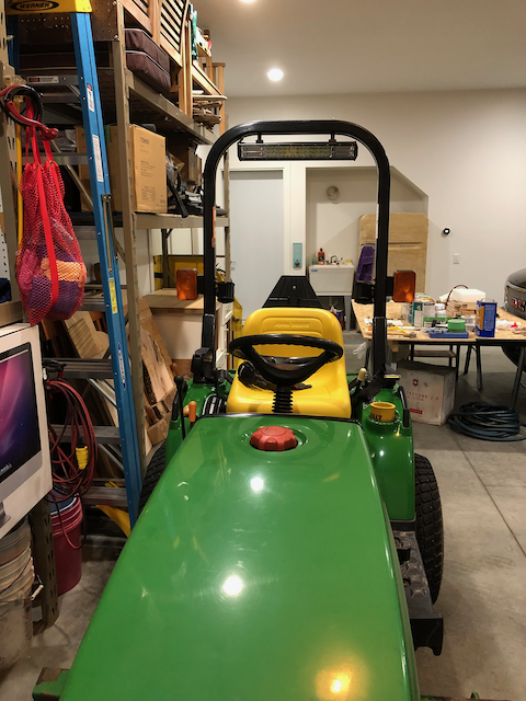

I have it pointing just ever so slightly down. The lights never bothered me. Basically starts getting bright at the beginning of the hood.

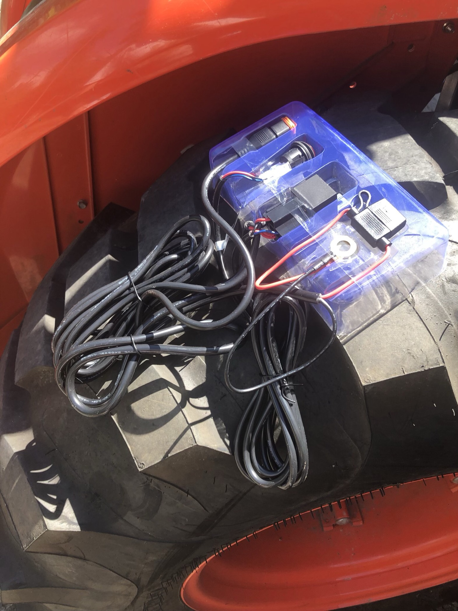

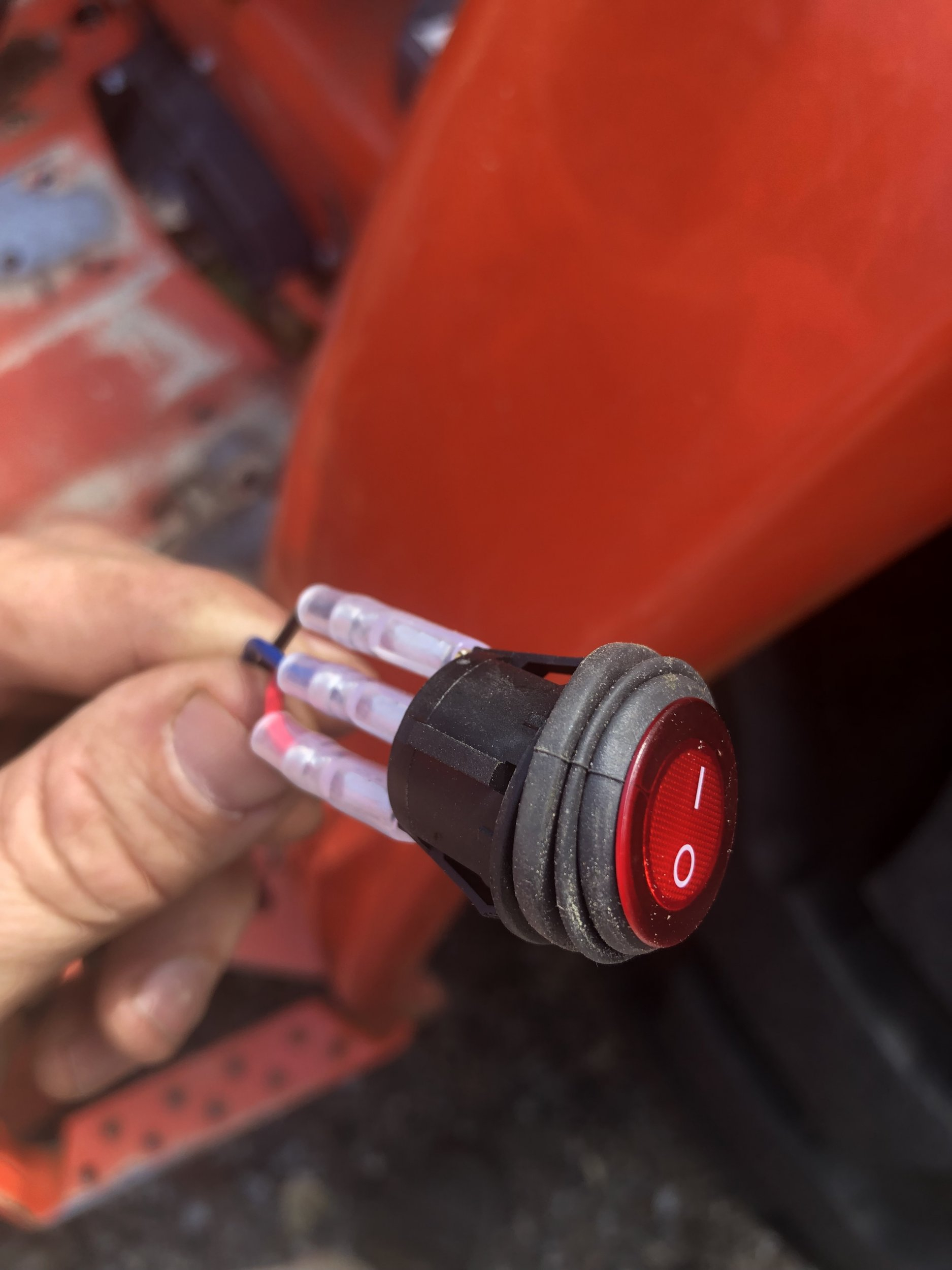

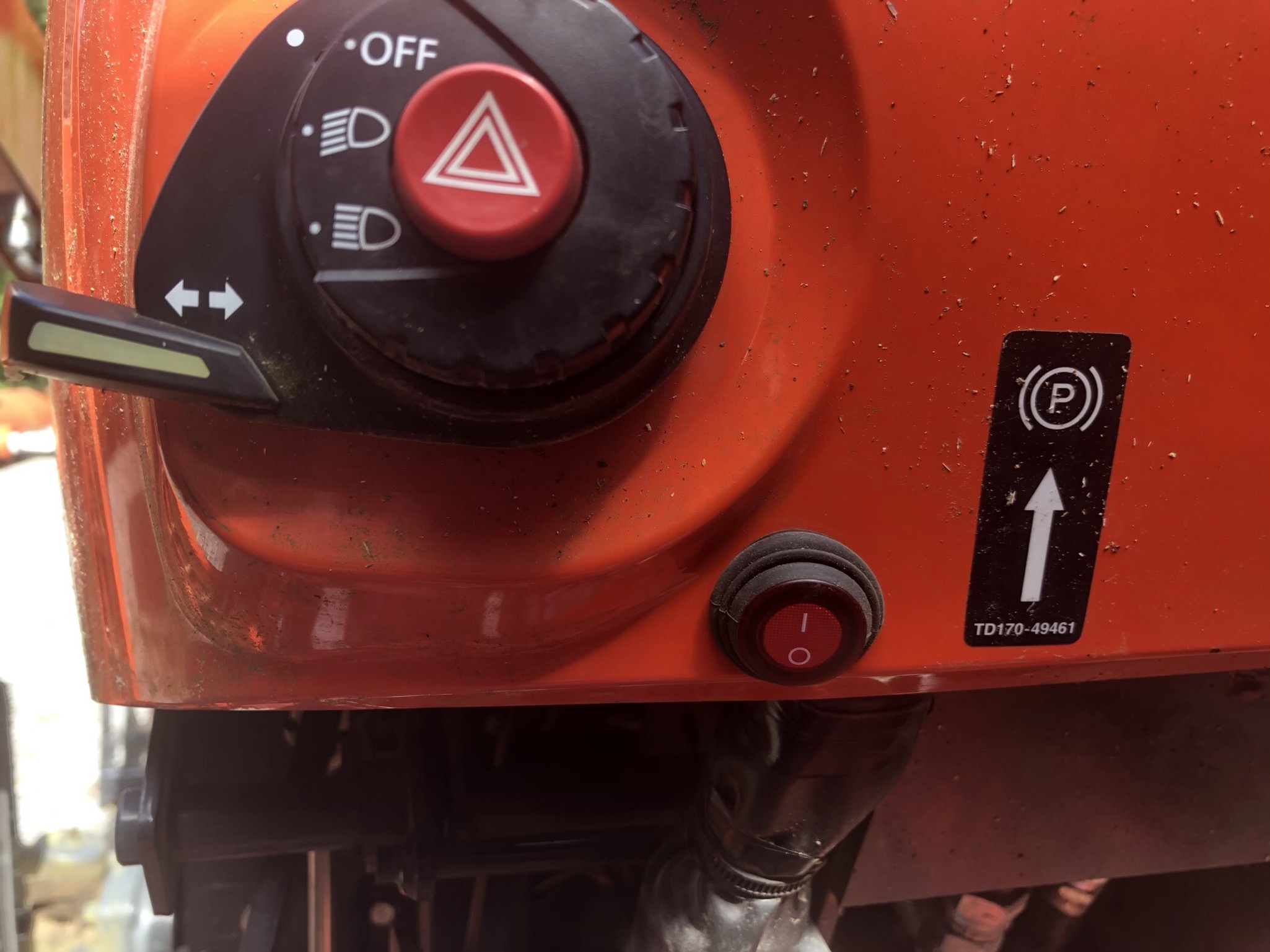

Thanks for sending this! Do you mind giving me the link to the package you bought I like how clean it looks. Also if there is a more commercial/brighter package could you please also provide that! Are you able to tilt the light bar up and down? I want to really be able to see what’s in front of me… Also, can you turn the rear one off individually? If you could provide the links to the stuff I need to buy to set up and I just have to click on it I would so much appreciate it!!!! Thanks y’all.

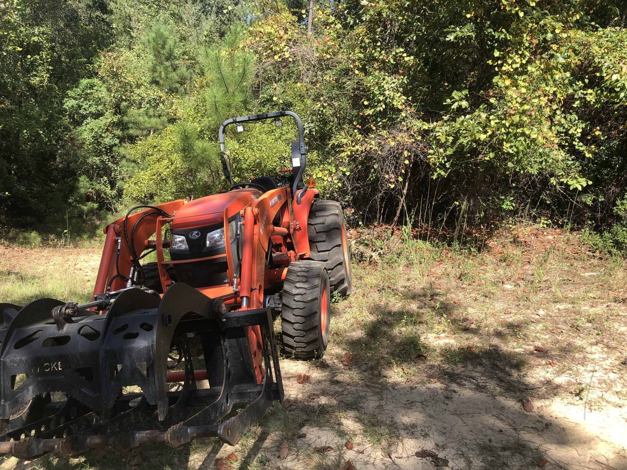

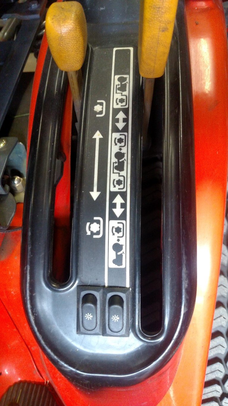

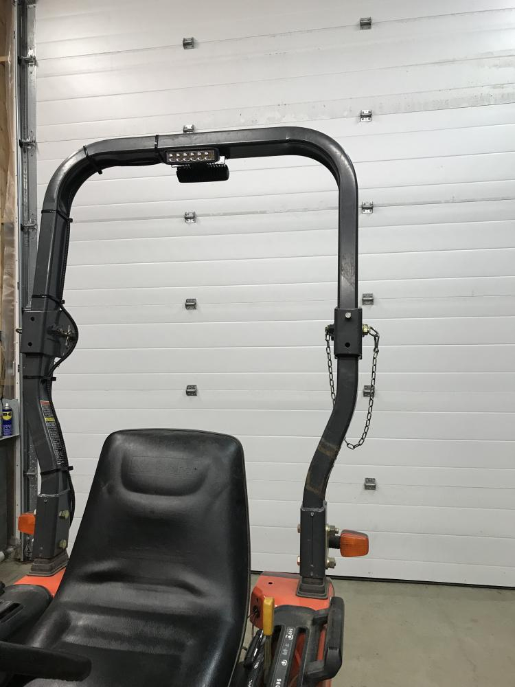

I figure the TBN Braintrust has lots of good advice, links and pics. Looking for any ideas on mounted LED lights on my ROPS bar for my Kubota B2320 TLB. I’m tired of the dark kicking out of my seat when things to do (digging, plowing etc). Preferably I need better lights forward and back, or at min able to flip over.
Let’s see what you have.
Thanx in advance,
WillyC

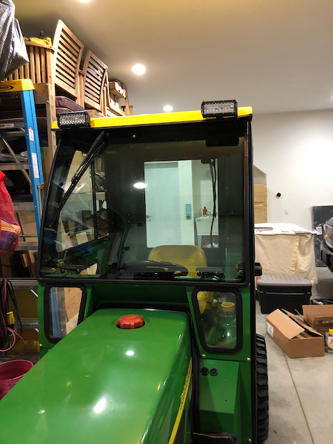

I have a 4120 John Deere and lights that came with it was not enough for night time work . I added lights (2) in the front and the back hook up were easy because there were extra connections already on the tractor for them. Got them from JD dealer and they are great.

Bravoxray I hope that you have some protection on
the wires that come out of the hole in the ropes so
the jiggle of the tractor don't cut the coating on the
wires for a short circuit!!!!!!!!:unsure:
The lights with the amber lens will help keep the
bugs away
