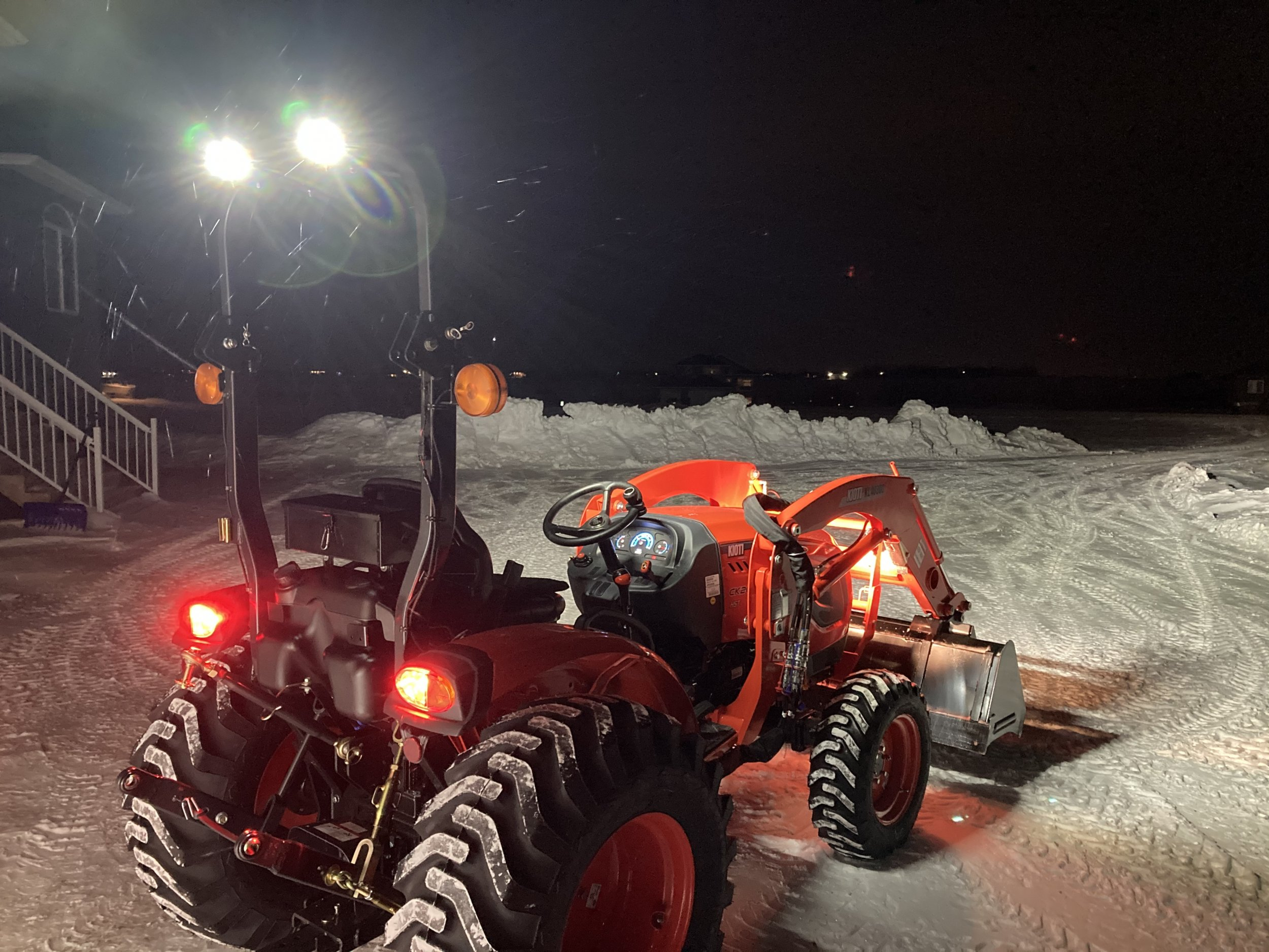

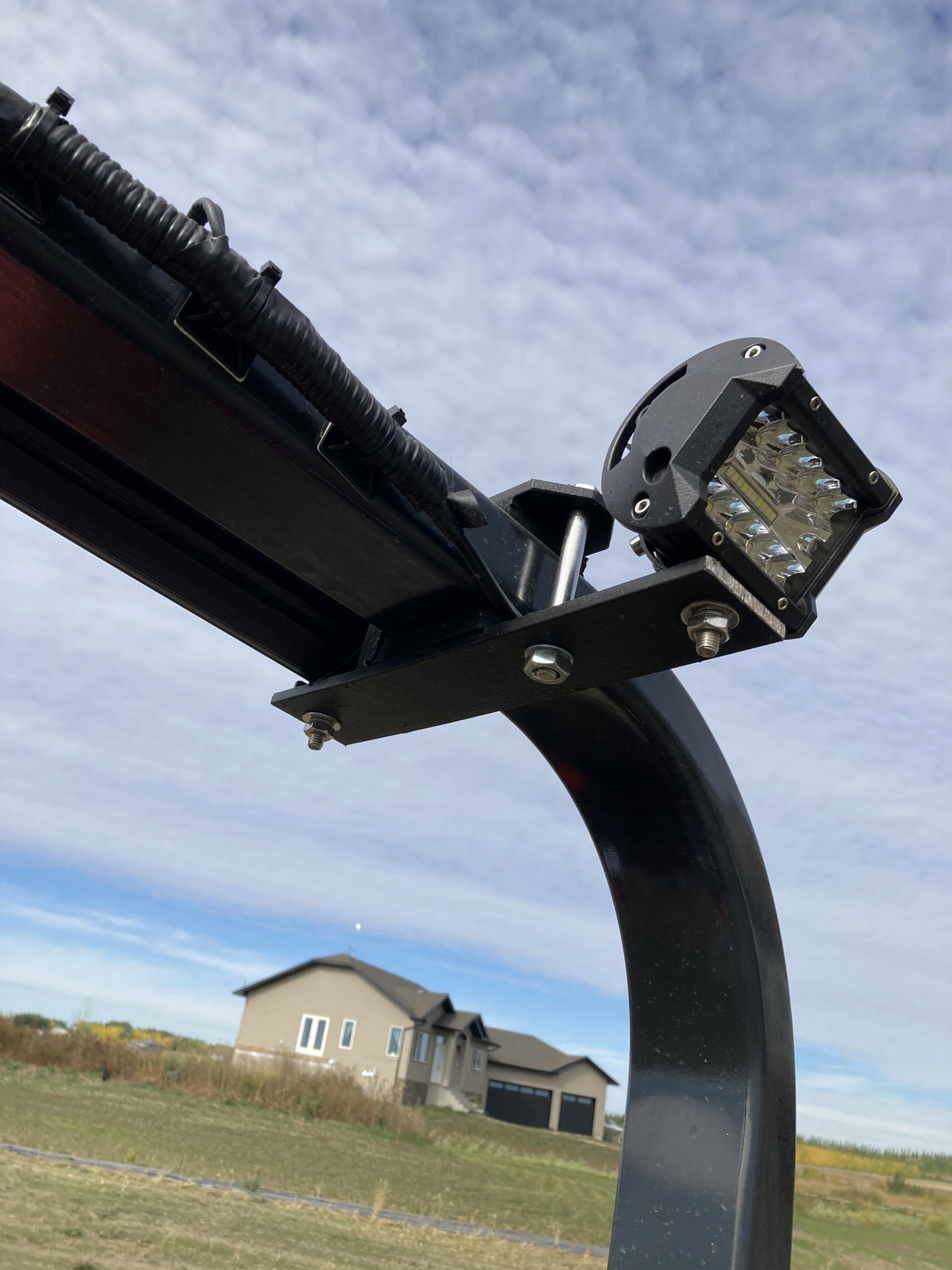

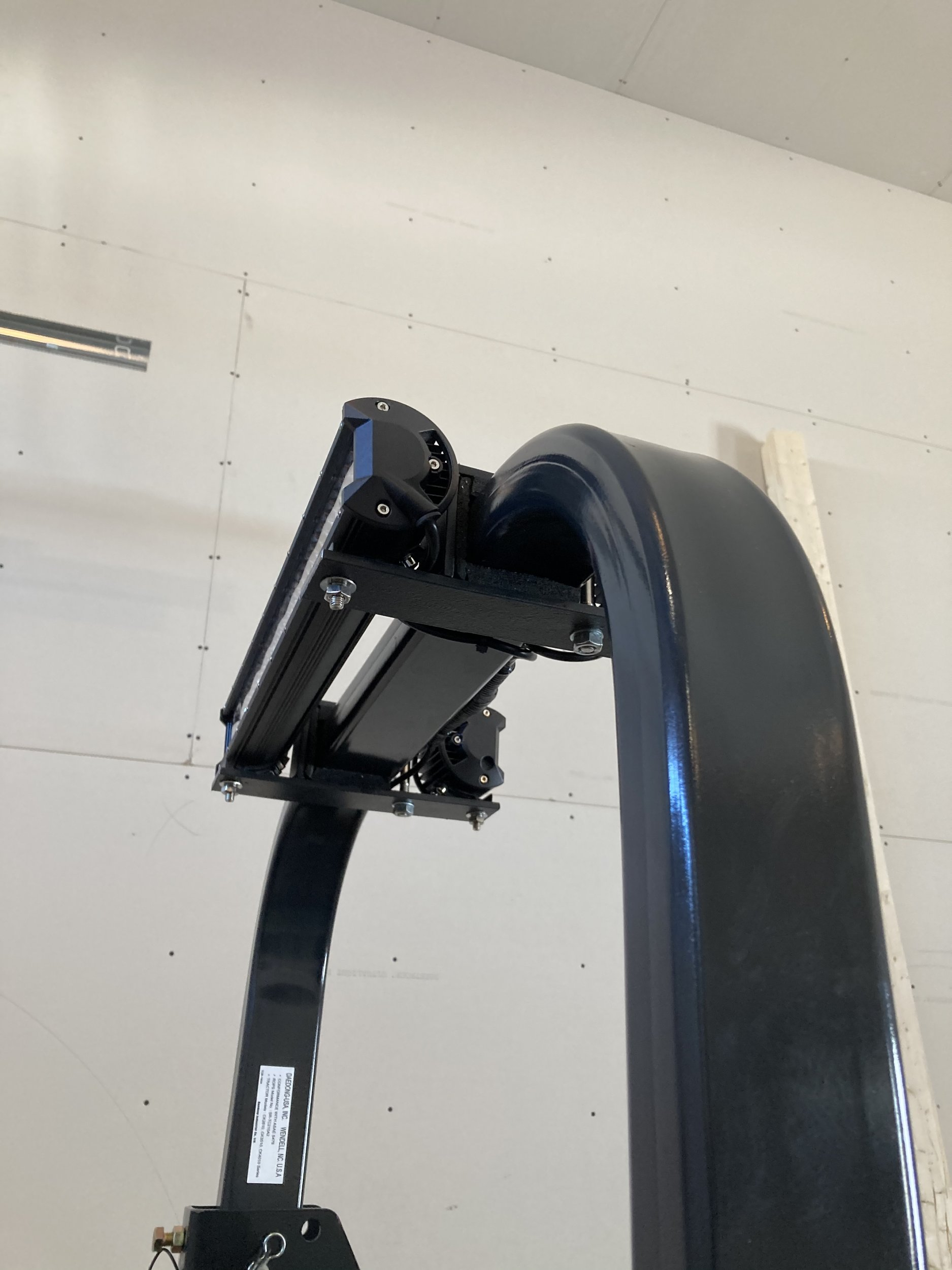

Here’s how I mounted mine
Only lights on in this picture are the ones provided by the tractor
/ LED Lights on ROPS #9
Thank 96!
I guess what I was thinking is that I didn't want my head bathed in light, but the work area around me. 96's pictures show that the operators station stays pretty dark still.
/ LED Lights on ROPS #10
I have it pointing just ever so slightly down. The lights never bothered me. Basically starts getting bright at the beginning of the hood.

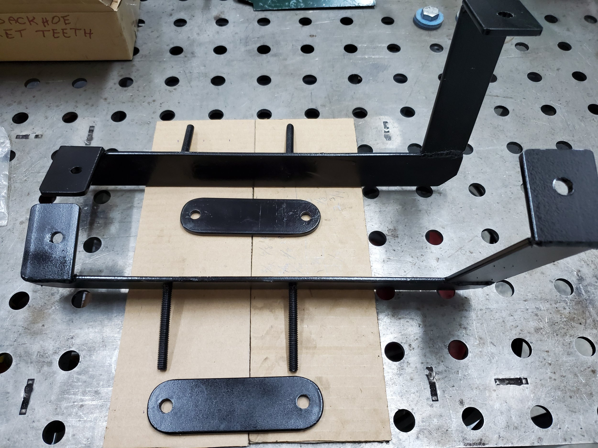

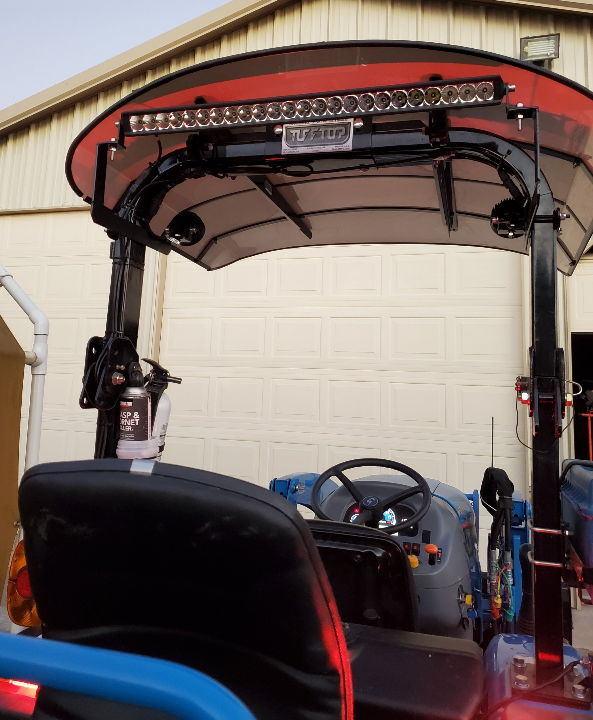

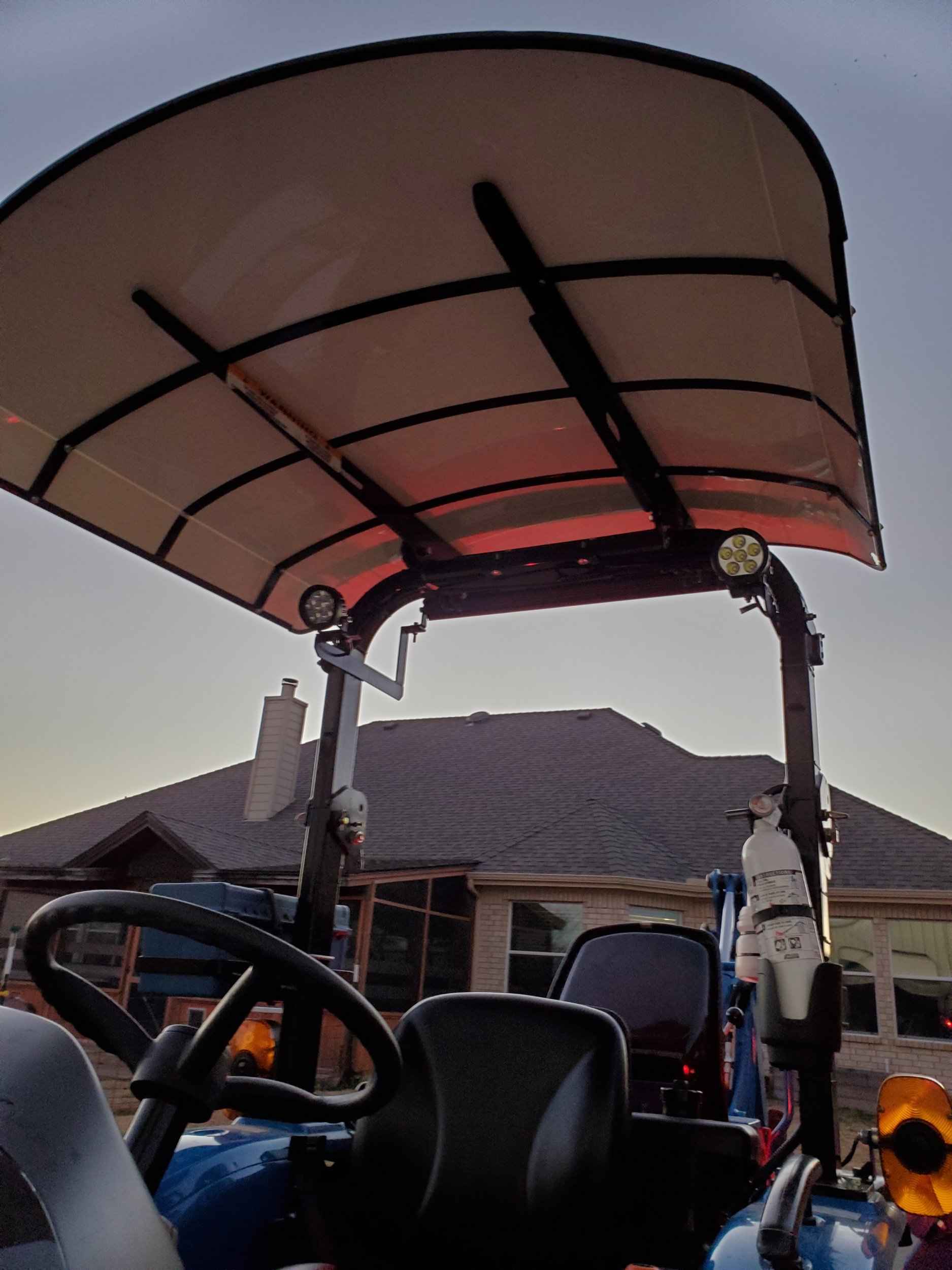

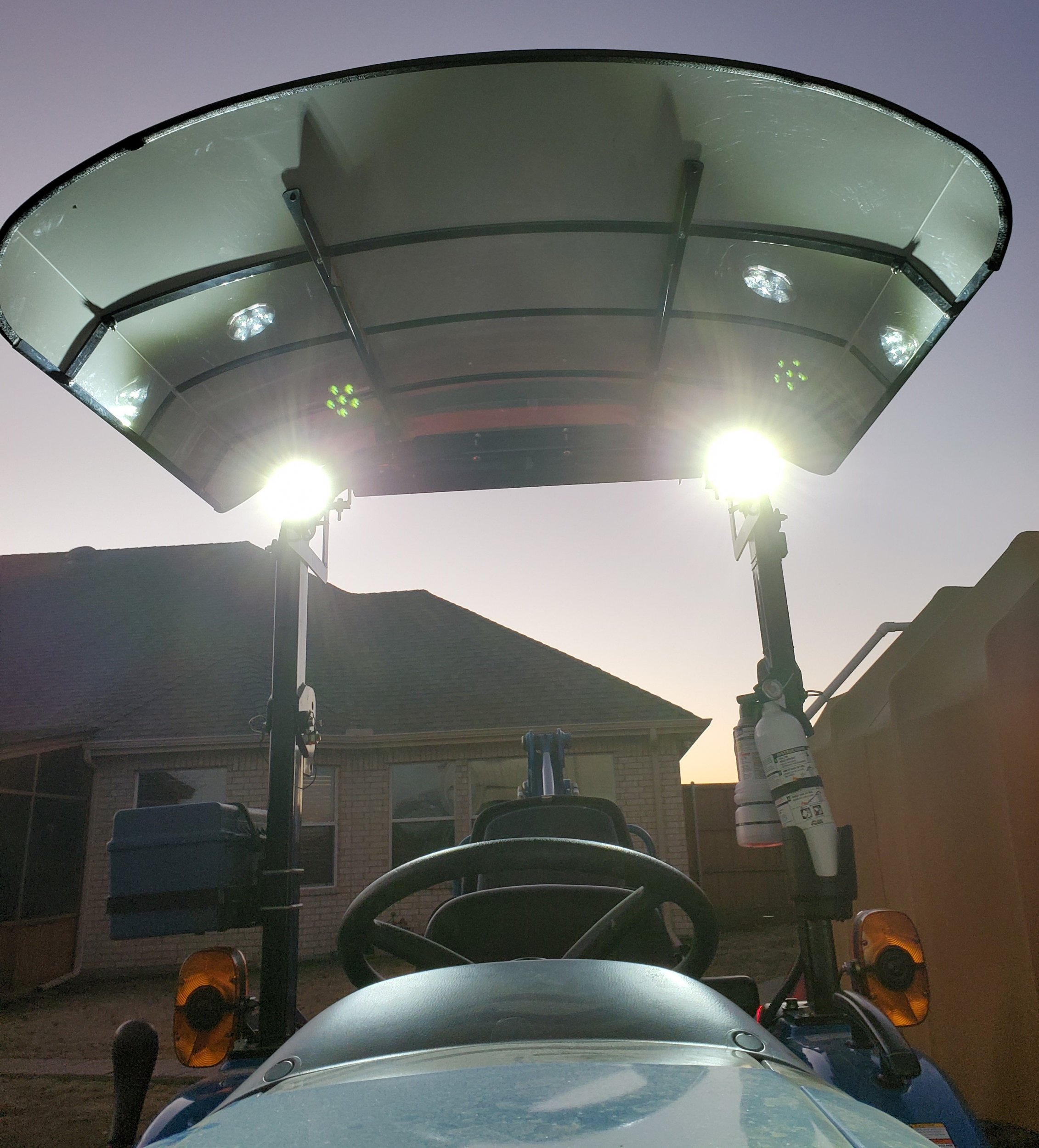

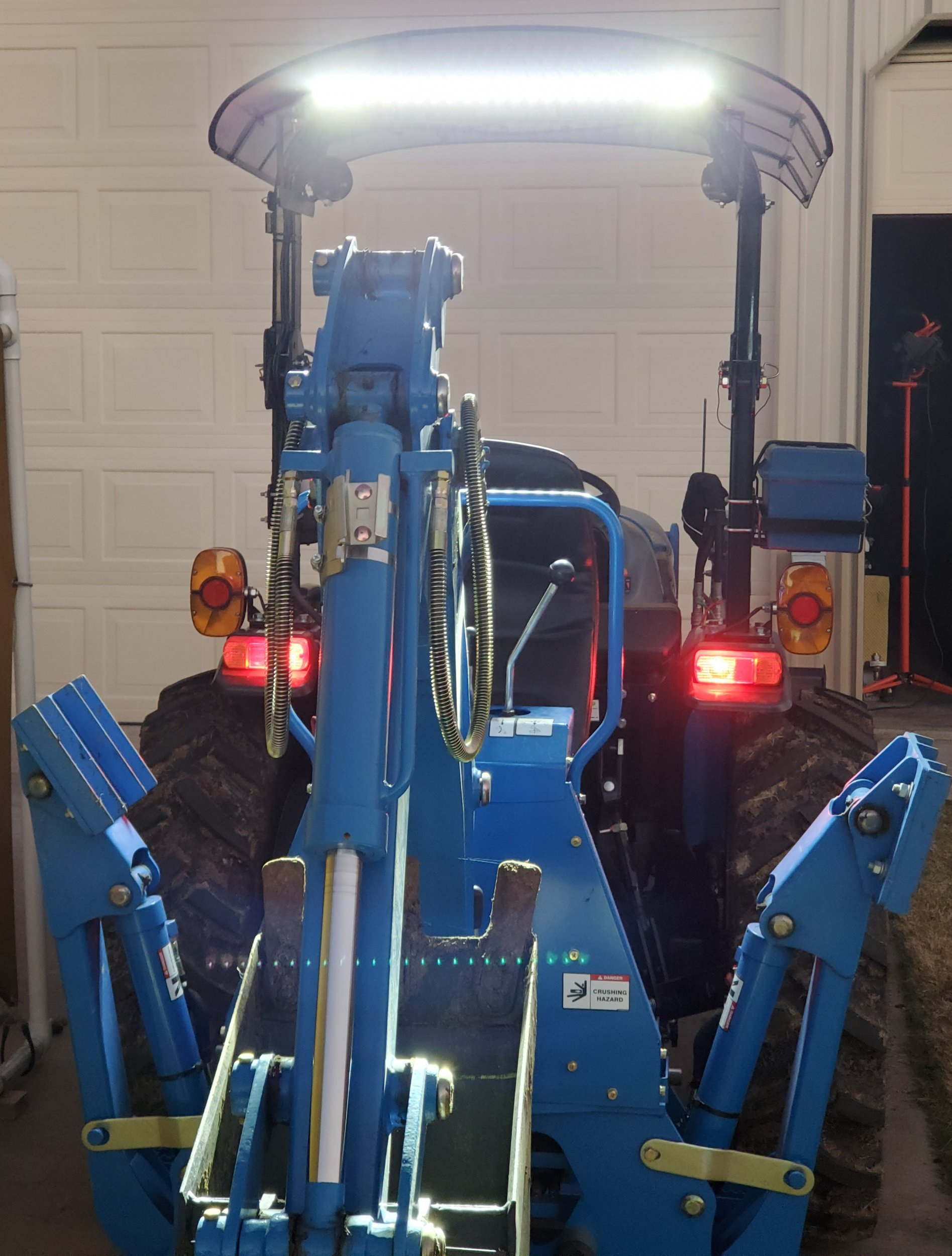

Here's how I did mine since I have a canopy. I spaced the width in the front the same as the back so If I later determine I need more light forward I can get the same light bar and install instead.
The lights and harness is all from TSC. I get them when on sale and/or I have a coupon for XX dollars off.
/ LED Lights on ROPS #13
View attachment 714490View attachment 714491View attachment 714492View attachment 714493View attachment 714494
Love that the Wasp & Hornet is essential as the fire extinguisher (y)
