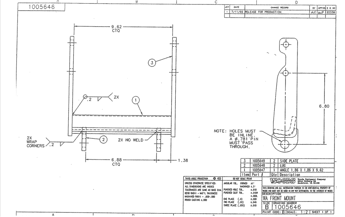

I found a Woods backhoe subframe for my B2910 Kubota some time ago. However, it did NOT come with the needed FRONT MOUNT. I contacted Woods and they were kind enough to provide this engineering drawing of the front mount.
I'm no welder. Where would you guys go to get something like this fabricated? Welding shop? Machine shop?
I also don't understand some of the notes on the drawing. What does the "2X WRAP CORNERS .2" and the "2X NO WELD" notes mean??

CH4, It looks to me that what you have there is an incomplete drawing. Somehow it got filed at Woods as the final drawing. This has the look of being just the start of an in-shop project for a prototype rather than a final production drawing. This one has too many dimensions missing or needing to be filled in after it is trial-fitted to the tractor. Also overall dimensional & material info is missing, and the missing info is all of the type that the designer would fill in after a couple of trial fits and revisions.
BTW, "2X" means to "do it twice". In this case I imagine he means his instructions apply to both of those pieces.
"Wrap corners" and "not weld" is the sort of notes a designer might put on a drawing to a welder he has worked with before. My guess is the designer wants to be able to position those pieces on the tube for a trial fitting, expects they may have to slide laterally on the cross-bracing tube, and also doesn't want to have to cut them off if they are way wrong. So just crimp them into position....
There will also be a drawing for the parts that are bolted to the backhoe and that slip onto this piece - you still need those unless you have the parts. This drawing is a decent start of a design. Not a finished piece.

Thanks for the insight. I was thinking that someone could just put a scale on this drawing and fabricate this piece from it.
Based on your comments, I should probably just take the tractor and subframe to someone that can test-fit the pieces needed for the front mount before final welding.

You're right, many people would take a stab at that themselves, it'd likely cost a bit to take the tractor and that drawing to a fab shop to get made... there's not enough dimensions to make it from just that drawing but it does have some important ones there. It does look like those 3 holes are in line which helps. It's coming up on winter, if you get lucky you might be able to find a farm that has a shop and some down time... or just search around, I live like 7 miles from the nearest town and there's at least one fab shop within 3 miles of me...

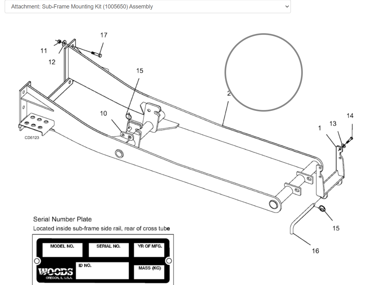

I'd attack it on three fronts , #1 Trying to find the parts or complete subframe for sale #2 Trying to find someone willing to let you measure their subframe and make sketches. #3 Look parts up as you did previously and this time look toward bottom of parts list for a statment to the effect of "this part fits model #s xxxx,xxxx,xxxx,yy and zzz" As I recal you will find that statement for parts at Messicks and there's likly others as well. Also looking for those models that are the same increases odds of success tremendously for #1 & 2 above. And of course offering something in exchange really helps. Guided fishing or hunting,free weekend at beach house, fifth of Johnnie Walker or Maker's Mark.
