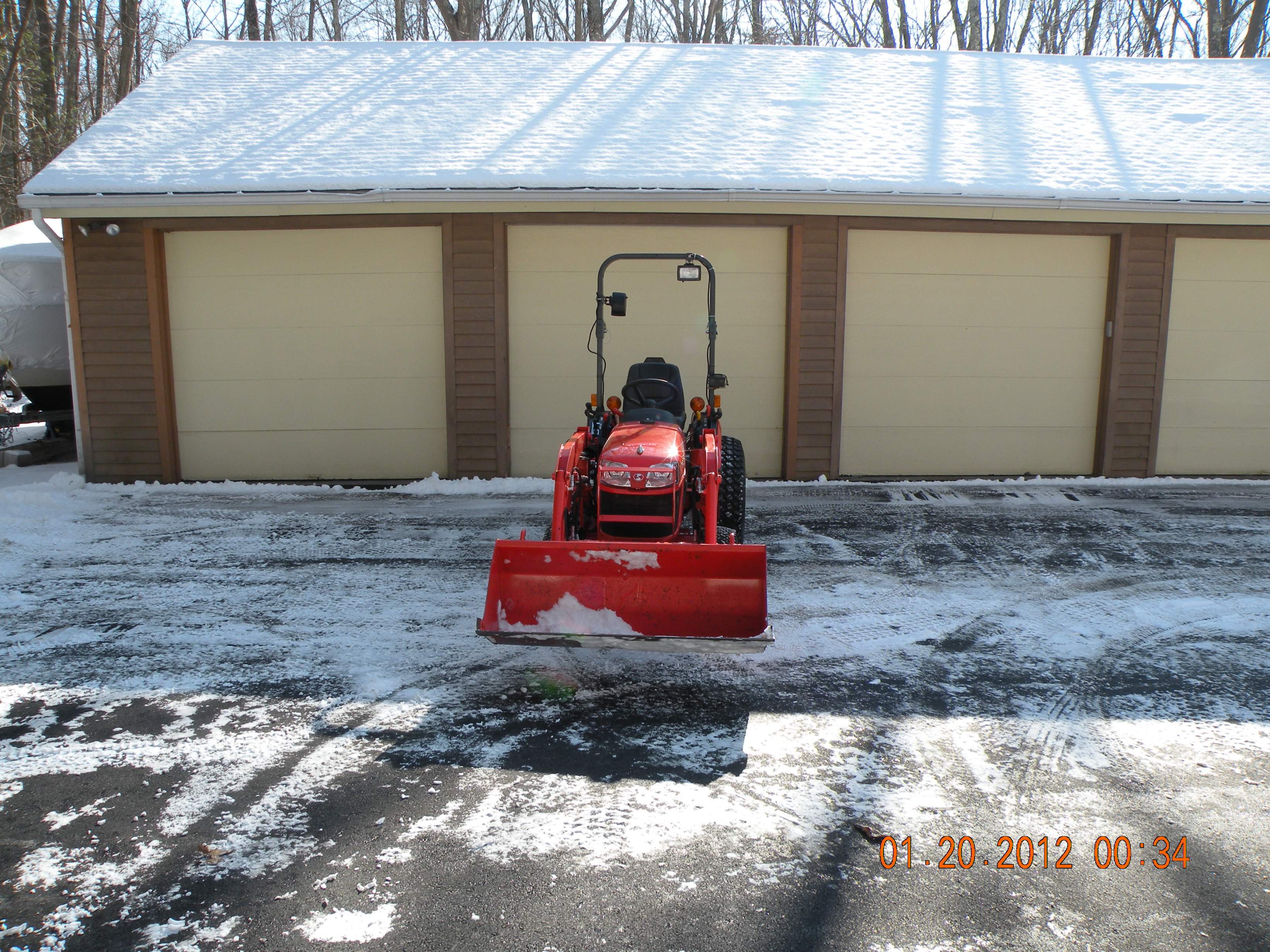

Hey fellas, it's been probably 2 or 3 years since I've posted, but I'm in need of some advice. I recently upgraded form my beloved BX1860 to a B2320. I loved the BX and did about 100 hrs a year on it, but just needed something a little bigger.
I use the tractor to maintain my motocross track, which is in the woods and has lots of jumps, hills and dark dirt, move snow, and occasionally on a jobsite if necessary. The problem is that we are down to short days here, so a lot of my work needs to be done in the dark. The headlights are pretty useless when the loader is on the tractor, and the lack of lights on the back makes backblading in reverse near impossible. I noticed a couple of what looks like threaded inserts welded to the rops, are these for lights?
I'm looking for the easiest way to put lights on this thing, affordability is paramount as well. I'd really prefer to do it plug and play type, rather than having to wire something in to the harness.
Thanks in advance for any advice....
Here she is
Oh, and IF Kubota made a dirt bike I'd buy one...:) This is the next best thing...love the color orange....

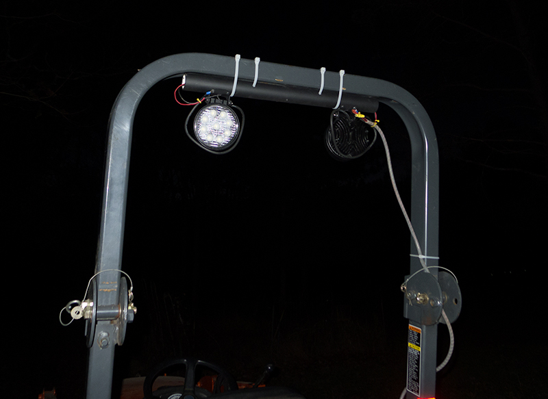

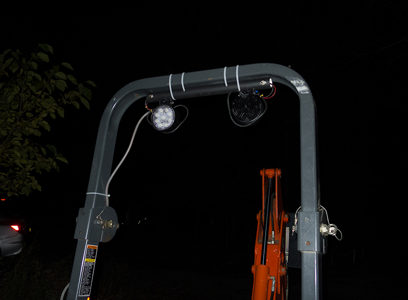

I used a piece of white pvc pipe (painted black) and mounted two 27 watt led flood lights to the pvc, then ty rapped it to the ROPS. I also installed 2 switches so I don't drain my battery. On my B2630, there were power leads under the rear right wheel well. I picked up the 27 watt led's on ebay for $26 each. They are really bright.
