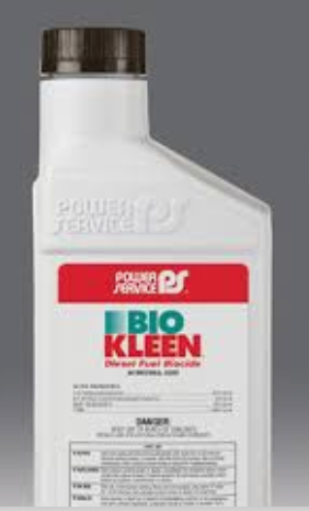

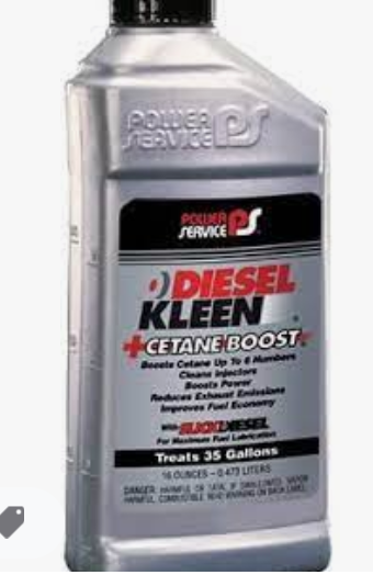

I would get the grey bottle of Power Service Diesel Kleen (kind of diesel version of Seafoam)
And a bottle of Bio Keen to keep fuel plugging algae from growing in your tank
Then give it a good workout
